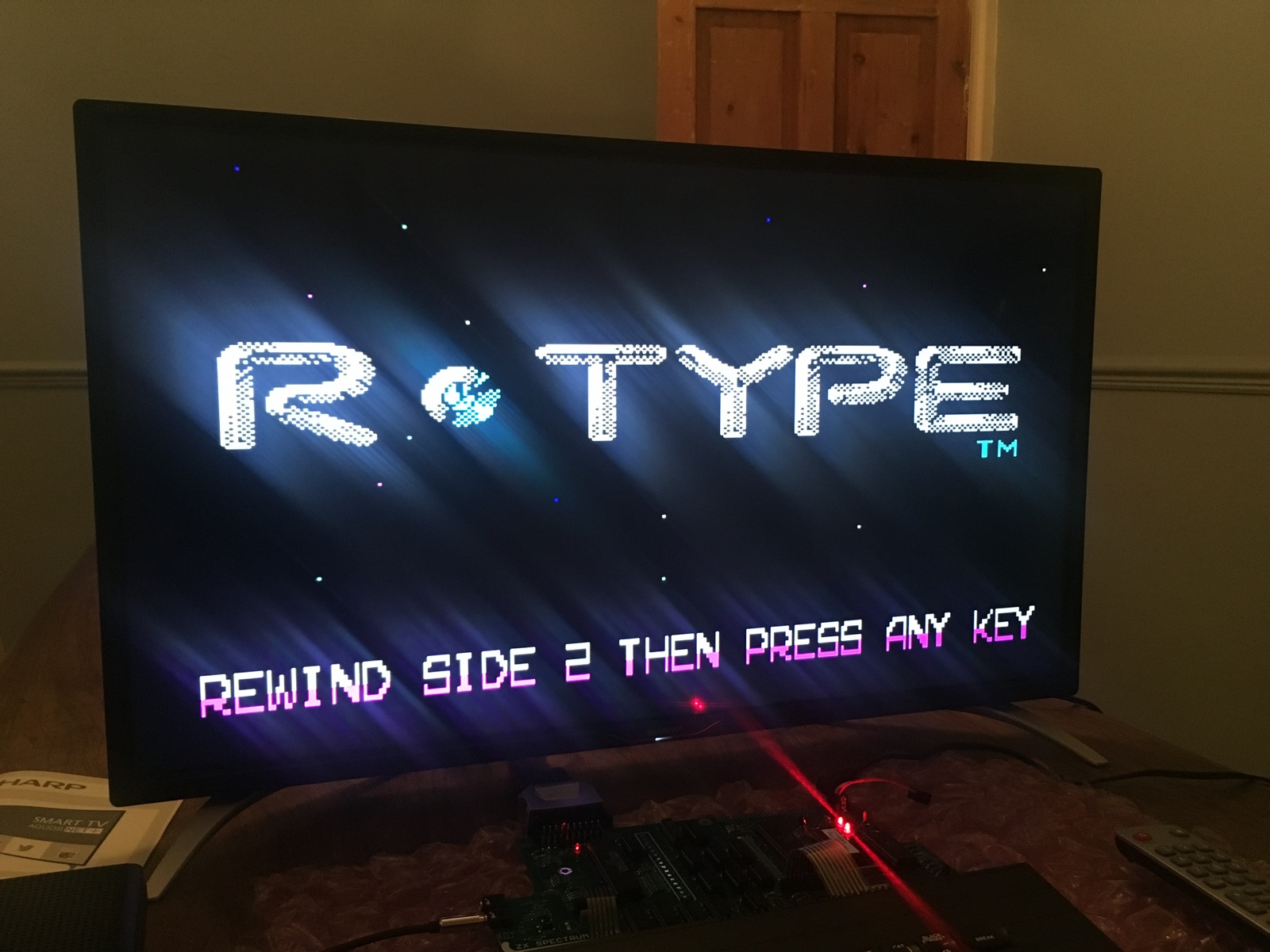

Some final tests for the setup coming to the Play Expo event at the end of this week. 8th - 9th October over in Manchester. Bought a new 32" TV for the event and been playing about with the settings. The Zoom2 option seems to give a good full screen image especially for R-Type so will give that ago and also have the regular 4:3 option to.

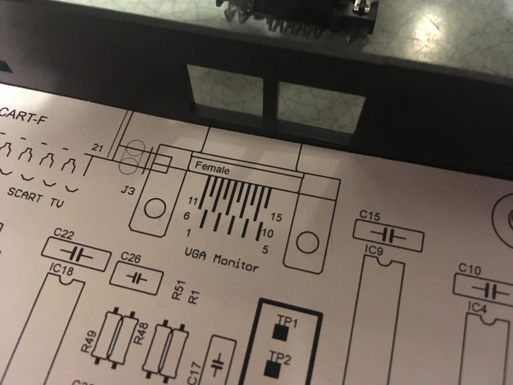

Things have been rather hectic here arcade and pinball wise since the play expo show (oct 16) where i was demoing my proto zx spectrum 128k board. A few updates on progress to report now i've got a minute.
Been doing more soak testing and experiments to check reliability.I also decided to make another run of proto boards as after checking everything there were so many updates/mods/changes to the first rev protos that i wanted to confirm everything was correct before ordering a load. and i also decided to add a few new things based on various bits of feedback. First i've added a vga connector by adding parts to create a v sync signal and secondly i've modified the ay sound output going to the scart socket and line out jack to be full stereo. Next, i've double checked and fine tuned some mount hole alignments and the overall board size so that it fits nicely in the + case. This is something else i also want to double check before making a load. If the next small run of protos works out ok without too many mods need then i will make some up for people who are interested in them, then run a larger load next. I've also built up a stock of 128k ULA chips for inclusion in the boards.
Some pics of checking case fittings and mount points, VGA positioning etc
