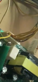

Here is schimatic
Also I put multi meter on my psu 5v line that is for the original sega converter pcb and it has good 5v
