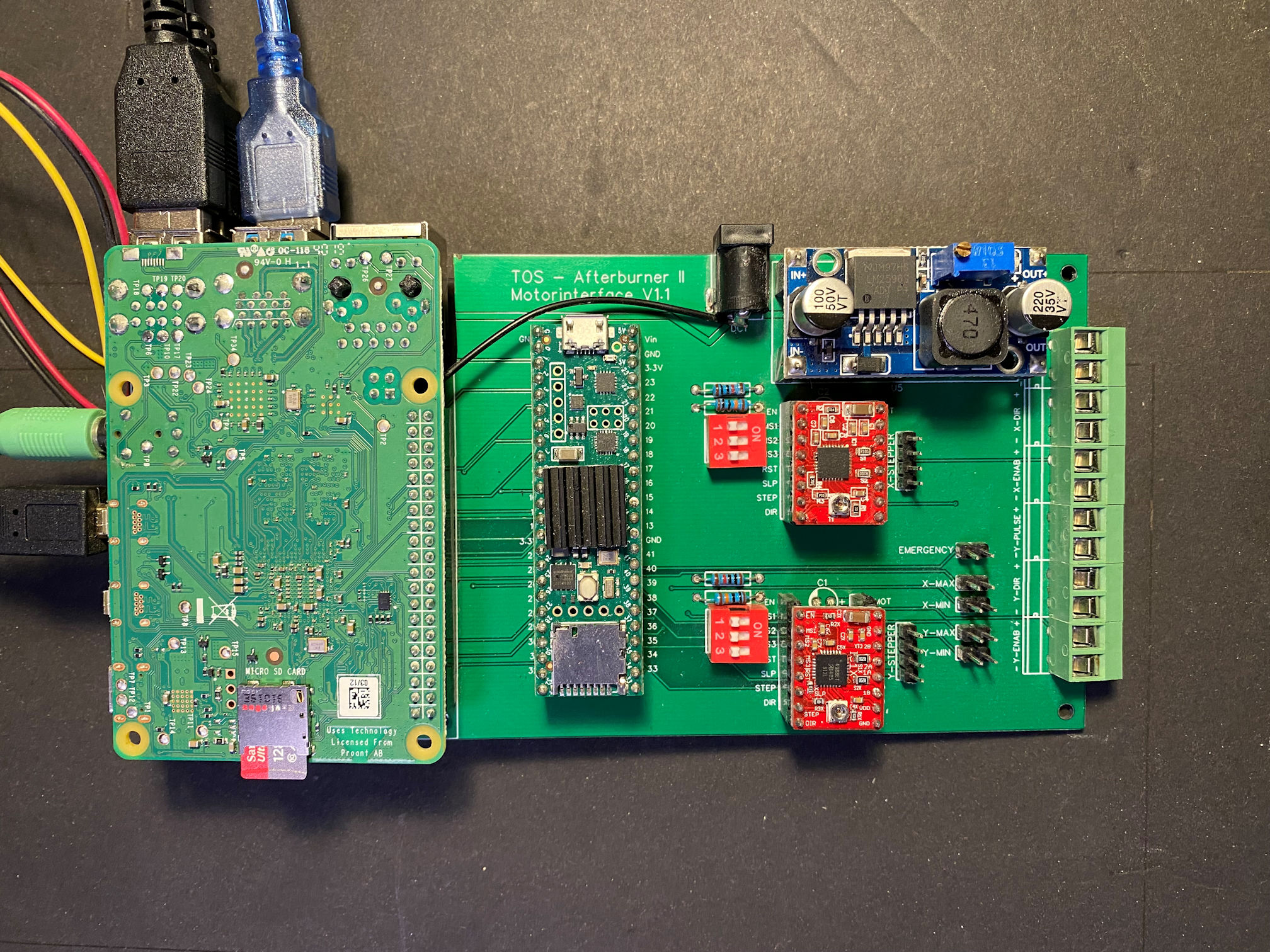

In December 2020 I started trying something similar with the attempt to have a working software/hardware interface to support a motorized Afterburner Deluxe cabinet, based on Mame emulation.
The following video is from my YouTube channel:
In the meantime I tried to resolve the bottleneck of the serial interface by using a GPIO based parallel interface instead. However this is still work in progress.
Best regards,
Stefan

So I'm clear, I think I understand you modified the MAME driver to support you own interface and protocol. Is your end goal to remove the original motor drive PCB and motors, swap them for your PCB & new stepper motors to recrate the motion functionality?

Yes I basically extented the Mame gamedriver of afterburner.
I accitentally tripped over the source code version of mame2003-plus libretro core.
In this version all necessary memory hooks are already implemented with some helfull remarks:
https://github.com/libretro/mame2003-plus-libretro/blob/master/src/drivers/aburner.c
When started in the first place I just had Mame cabinets in mind under the impression that original cabinets already have everything in place. That they of course might be in need of replacements just added a new dimension to it.
The communication between the game and the motor hardware consists of a couple of read and write accesses to specific virtual memory addresses:
read 16 bit from 0x140000 -> status of end stop switches
read 16 bit from 0x130000 -> read actual axis orientation/ potentiomenters
write 16 bit to 0x140002 -> motor power for horiz and vert axis
write 16 bit to 0x140006 -> set lamps on/off
I thought for building a Mame-based AB2 Deluxe cab from scratch big stepper motors would be an alternative as in such a setup potentiometers for axis orientation are not required.

There is a continous control loop which is implemented on the software side and therefore part of the game ROM. During my early work on the project I did write a logfile to see what is goining on (excerpt):

As you can see, the software initiates a motor movement (aburner_motoer_power_w) and then immediately asks for actual position (read out of axis potentiomenters -> aburner_motor_xpos/ypos) and also checks the end stop switches. The valueas are evaluated and result in the next motor movement command (aburner_motor_power_w).
