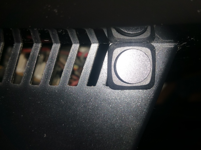

On getting the TV home and cleaning it up, I was struck by how stylish it looks 25 years on, but - it has to be said - more than a bit disappointed by how dull the picture was. It had nothing like the pop of the Sony. And it has SW revision 1.0, which meant it couldn't be adjusted using the remote control. Fast forward a few weeks, and I fitted a service switch to the chassis. This helped bump up the brightness and colour saturation, and let me tweak the picture size and geometry. It looks a lot better now, but still a touch subdued compared to the Sony. As far as I can see, there doesn't seem to be a way to permanently bump up the contrast, but if anyone knows otherwise, I'd appreciate any tips.
