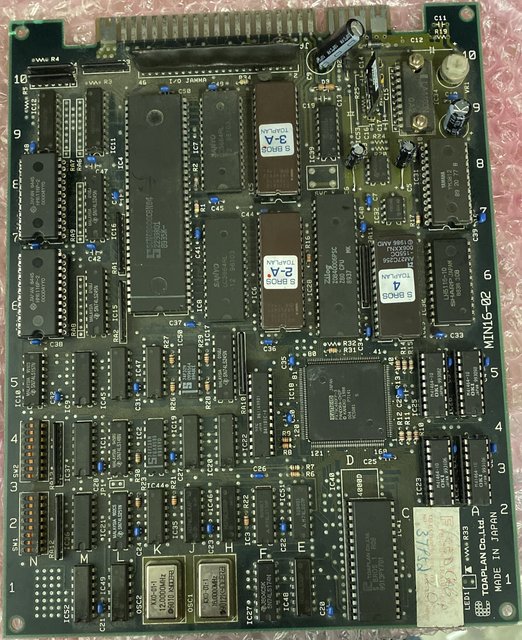

Hi guys
so ive had this snow bros in my possession a while now.
the game wasnt running at all.
Fist things first, replace the custom audio chip that was hanging off...

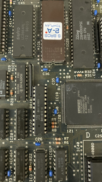

So probing about a bit and reaading other repair logs i decided to change the 4 x oki @ A3 and A5 & B3 & B5. also the nec @ F4.
no avail, still dead.

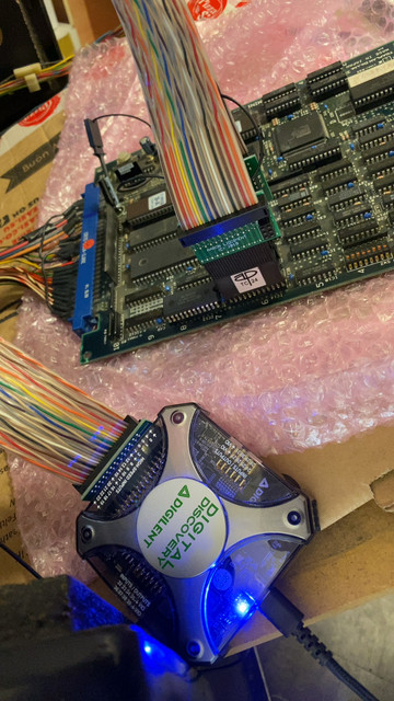

so only been a small PCB i decided to SLICE the TTL logic.
Nothing, all passed ok, what a cracking tool the SLICE is too, thanks to GadgetFreak.

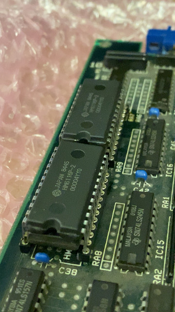

So moving onto the colour ram i decided to piggyback with good working new stock.
Hmmmm i have some life at last
So decided to remove and socket these 2 rams and placed the new rams in their place.
