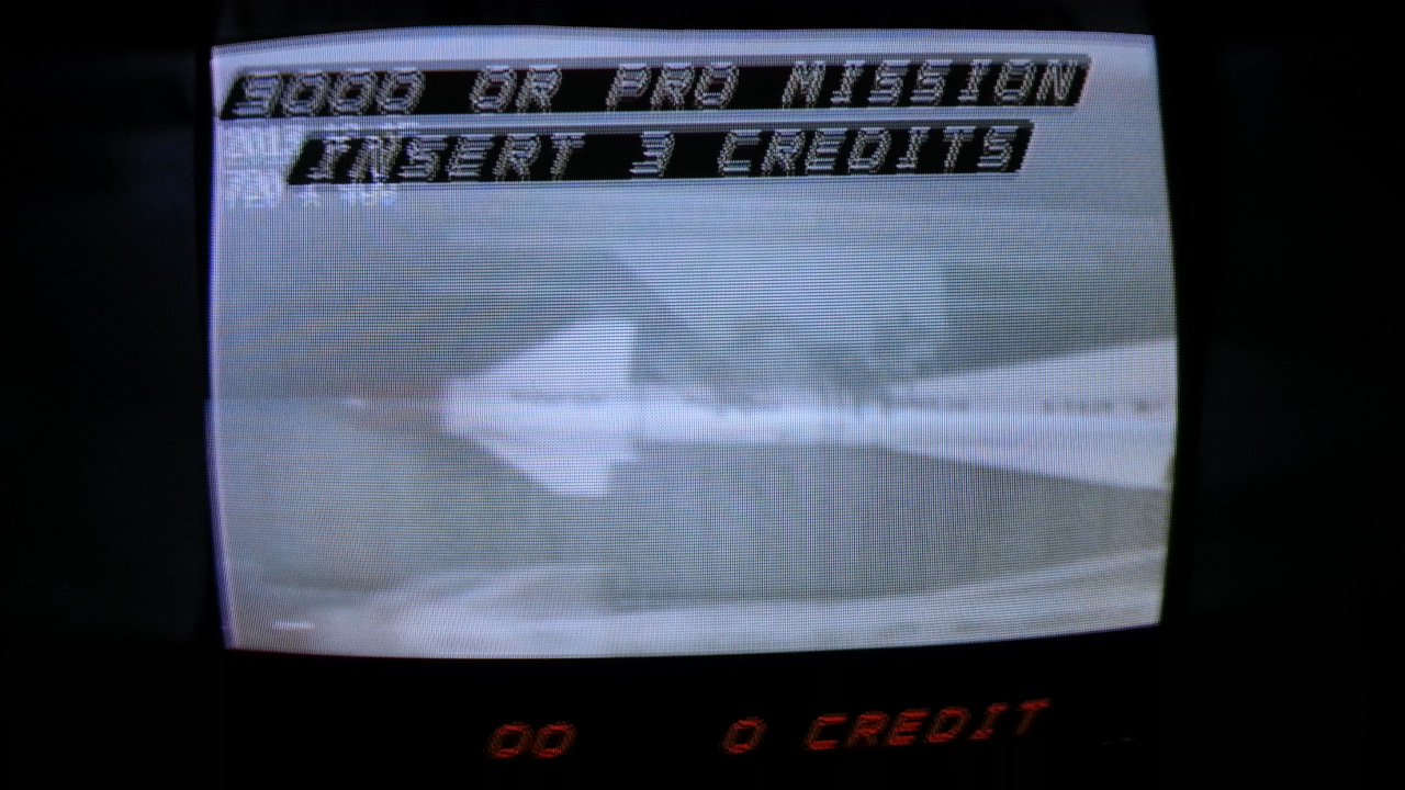

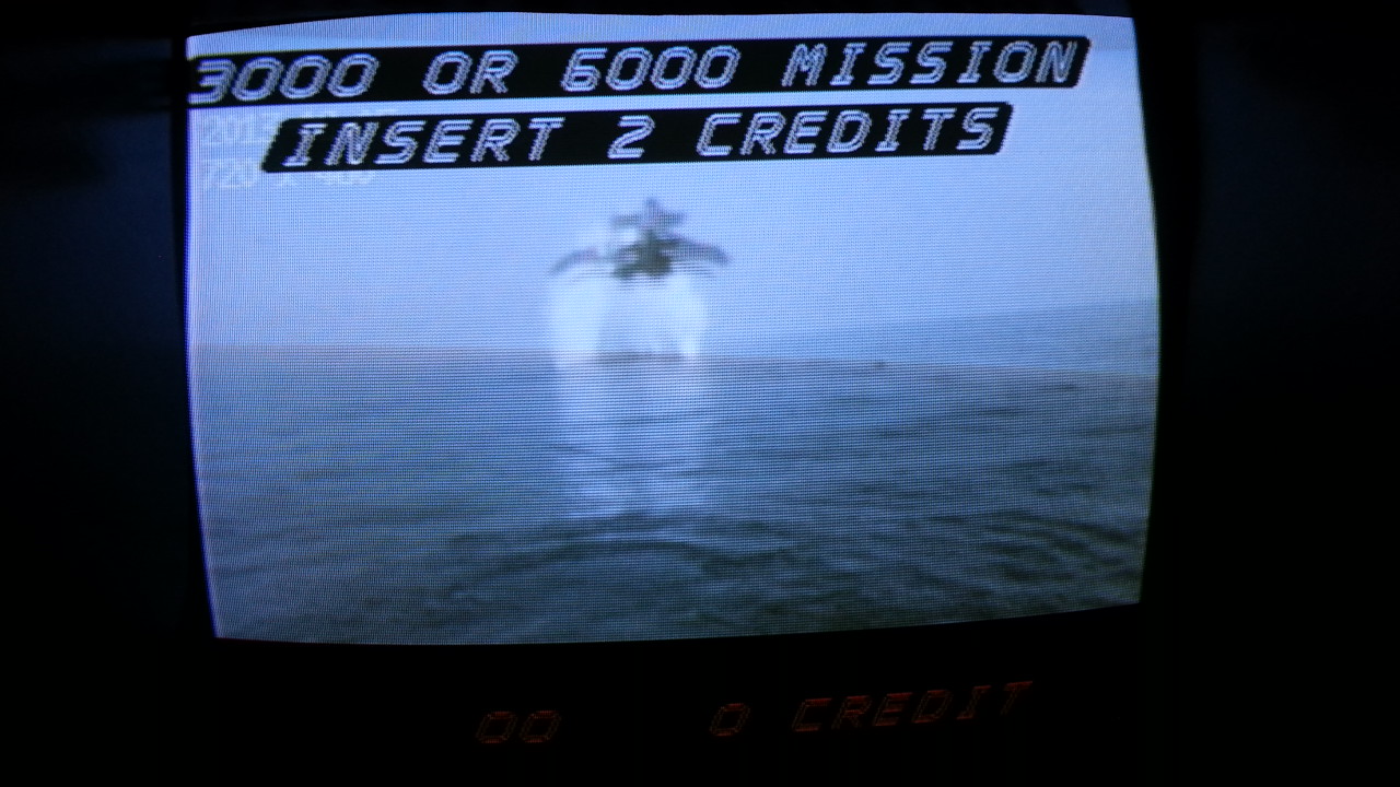

It's been a while but here is the Dexter laserdisc replacement running on a RaspberryPi in my Firefox machine.
There is an obvious colour problem but the actual frame seeking looks smooth and game plays well if you can see through the psychedelic effect!
Now, if I can find why the colour signal is so poor and fix it I'll a very happy chappy!
Sadly I've also got some game board faults to fix too, a couple of faults developed while I was trying to test the Dexter. Bugger!
