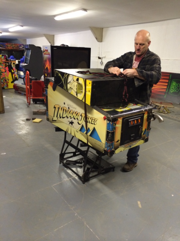

1. Matt and I get the bad boy on his trusty B&D workbench:

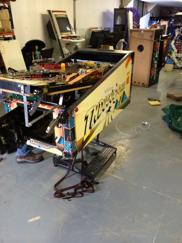

2. Takedown commences (notice Movember's Sombrero Lara Croft making sure we didnt feck it up) !:

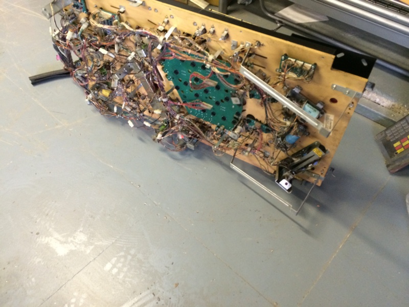

3. Playfield out, on it side, ready for fellow pinner Ivan Durneen to start the rework (pics soon) on the play area:

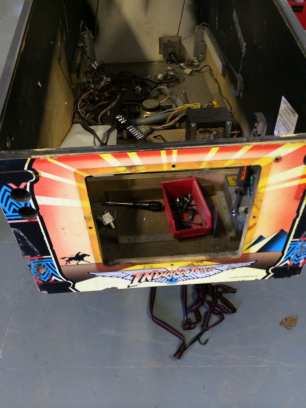

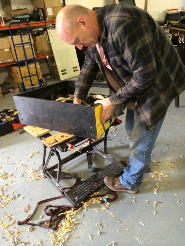

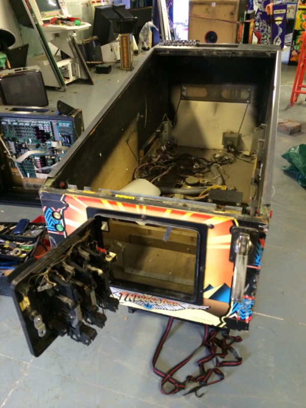

4. Cab being stripped (mid process):
5. We strip fasteners into two red boxes - black stuff for re-spraying before refit and others for general not on display fasteners:

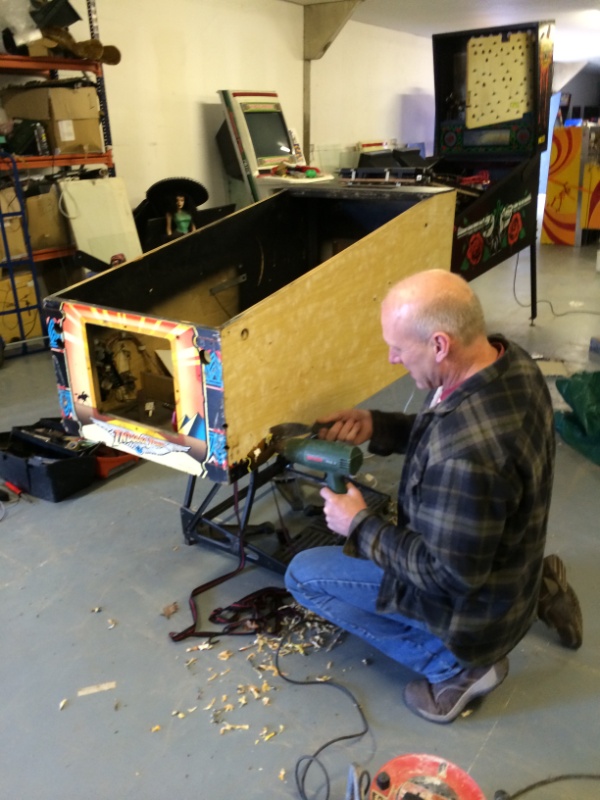

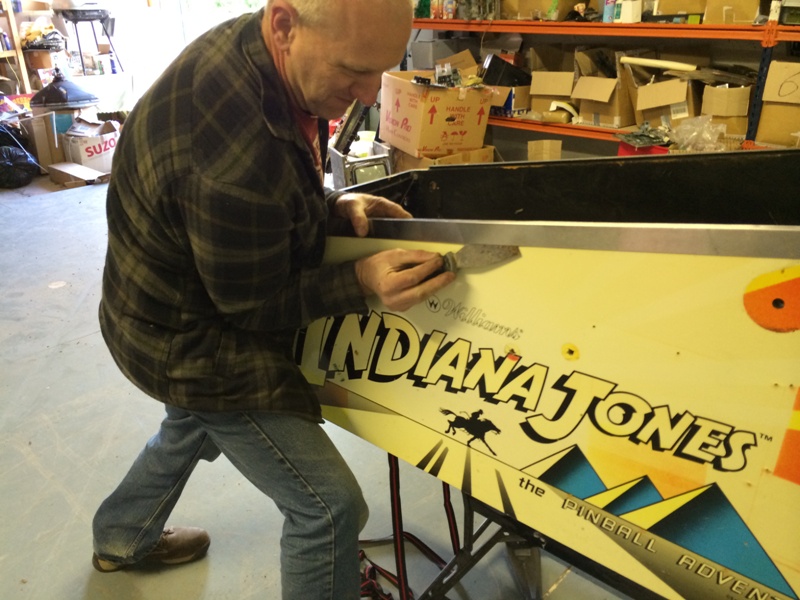

6. Matt starts but detaching the siderails by splitting the double sided tape adhesive in a true manly fashion!:

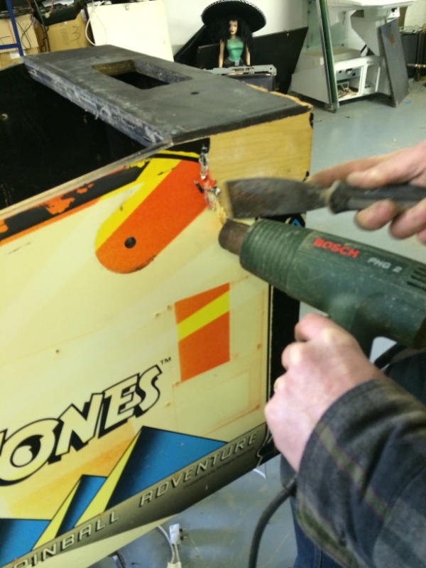

7. Hot air gun is now utilised to strip the original artwork off:
Exclusive! 10 Second video of this blow-job in action!:

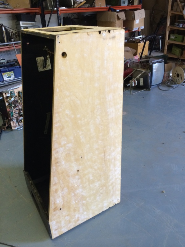

8. After an hour (or so) Side 1 loses its sun-fadedness:
9. Ok I admit it - I went home for soup and a defrost, but another hour later when I return the other side is decal-free:

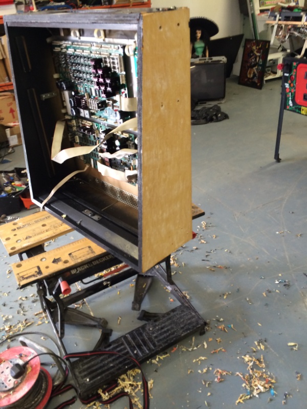

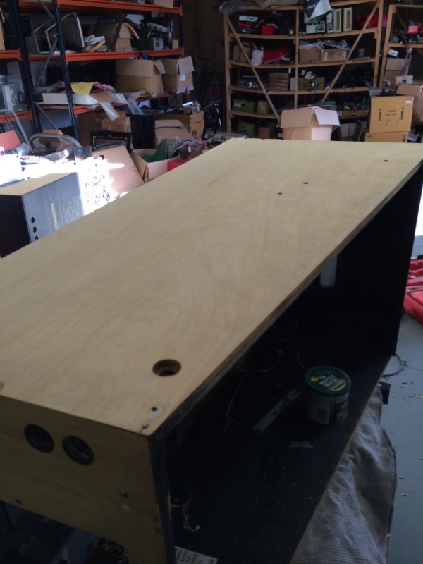

10. Matt starts on the backbox:
11. Begone sh*tty decals!

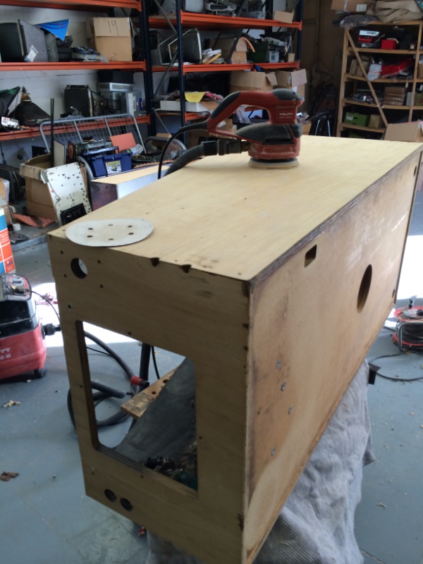

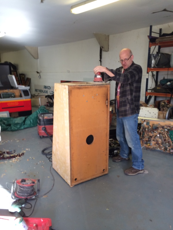

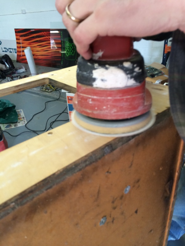

12. Matt would normally start using white spirits and chemicals to remove gook and glue at this stage, but as it has it the Spanish sun as baked this machine to within an inch of its glues resistance and he can skip this stage and go straight to razor blade and random-movement (with wicked suck up the dust hooker!) to get the crapola off:
13. close-up please! Matt tried to explain that you need as non rotational sander that moves randomly and not just circular as that would feck the ply. I forgot his terms but just too a funky picture and nodded knowledgeably ;) :
14. Mid afternoon tea break and a dramatic pose from the Indy:
15. 15:30 and time to quit as Matt has to go see Derren Brown with my tickets (damned colds and ill missuses) A last glancing shot after approximately 5 hours work:
