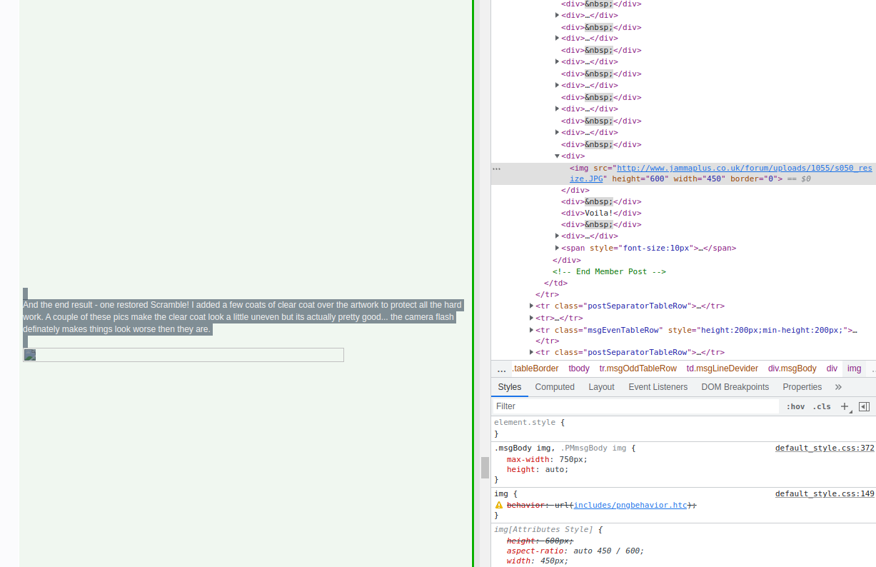

And the end result - one restored Scramble! I added a few coats of clear coat over the artwork to protect all the hard work. A couple of these pics make the clear coat look a little uneven but its actually pretty good... the camera flash definately makes things look worse then they are.
Voila!
