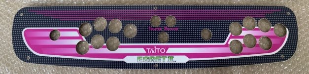

Alberto 1L7B-2S control panel just came in. His are better quality than OG I reckon.
Now I can play CPS and MVS without swapping buttons. I went with subtle MVS colours on the button housings whilst sticking with the OG Egret II button colours. Extra Start button is for exA-Arcadia, MiSTer and Recalbox RGB JAMMA menu control.

I also installed my new 2-Up control panel complete with a dedicated exA/MiSTer menu button with controls semi-matching the original colour scheme, but with MVS buttons highlighted.
