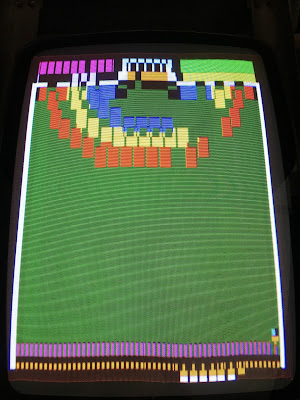

I recently picked up a Taito Field Goal cocktail cabinet, upon powering up the game was showing a graphical fault. The game played correctly when coined up, but every graphical item or text were just blocks of colour. The image below shows how it looked.
After using my logic probe running over the video section of the PCB I found what I though could be an issue. The MB14241 custom IC had data being fed into it and the clocking/enable signals all seemed to be pulsing away, but all of the Data Output pins were not showing as having any signals on them.

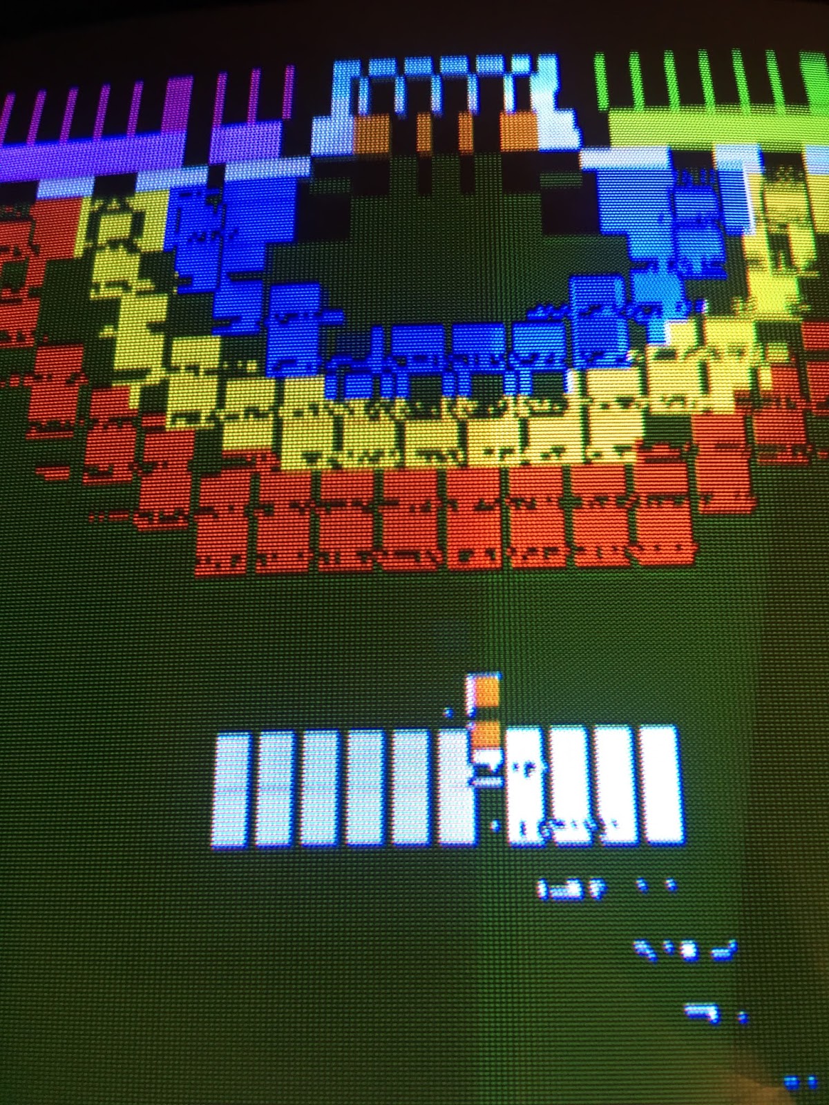

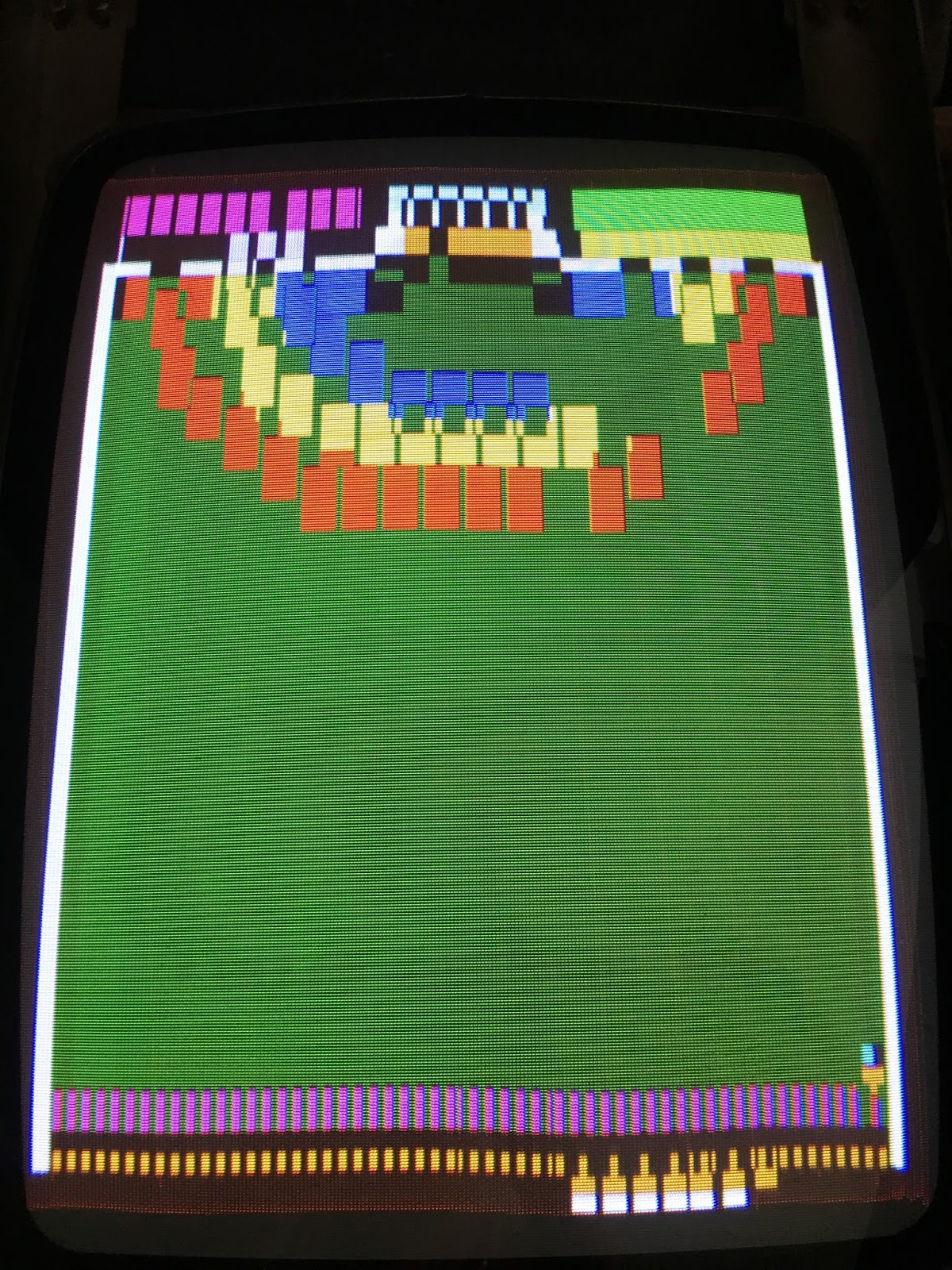

Whilst probing around i put my logic probe on pin24 which is the supply voltage pin, the pin snapped off from the IC! Clearly it was weak and corroded, I filed the IC down to expose the contact so I could solder my own 'IC leg' back on. I was hoping this would have been the issue, no supply voltage to the IC would match up with all the output pins being 'dead'.
Well this didn't fix the problem but the image of the display slightly changed. A couple of the output pins were now stuck high or low but most were still showing as being 'dead'.

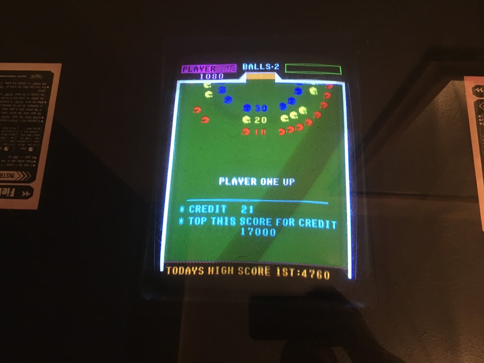

Once popped into my PCB the game fired and and played perfectly! I now need to procure a replacement IC and return the loaned IC.
Another 35 year old game lives on to be played!
