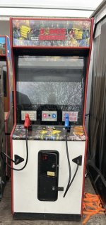

wondering if anyone has any documentation of this Caninet being used by Electrocoin at a trade show ?
Definetely an Electrocoin built cabinet (poss originally Lethal enforcers 1 ??)
Converted with a very nice genuine kit including Marquee(Plexi , side art, cpo ) board also and Hantarex monitor. finished to a very night standard and picked up with other Electrocoin cabinets earlier in year. 2F61398F-AF66-46C9-BAFA-2A8CAB0D5DF5.jpeg
