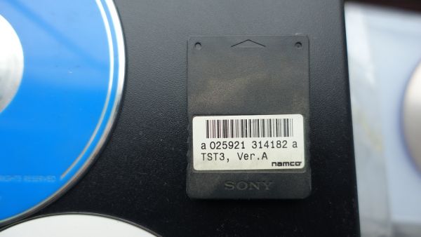

I've had this problem ever since I got this Time Crisis 3 a couple of years ago. Both sides work as single players but I can never get them to link to play 2 players.
I have 5 sets of the Namco 246. 2 don't work at all. Of the other 3, 2 are the same revision (larger more rectangular than the other one).
I have tried all combinations thinking that maybe they won't link if different revisions. All the results are the same.
I have set the clock on all machines to be the exact same. I have used the link cable successfully on 2 PlayStation 2's with no issues. I have cleaned out the link cable ports with contact cleaner.
On the test screen I can see that the left screen displays as player 1 and the right screen player 2. They both say (on 2) in the link section.
All settings in both are the same and highlighted green as default except the warning option with highlights green for off on the left but red for off on the right.
Not sure if this is an issue which would cause them to not connect.
Any ideas I'm all ears.
Cheers
Jon
