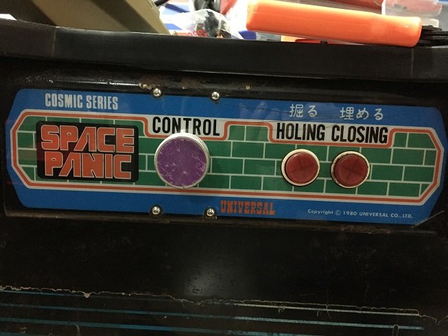

A Universal Cosmic Alien, but when I seen the pictures with the extra button and 4 way sticks I knew it had been converted so was a bit of a mystery! I had it in my head it would be scramble, but later found it was space panic which was cool as it's a game I remember playing back in the day

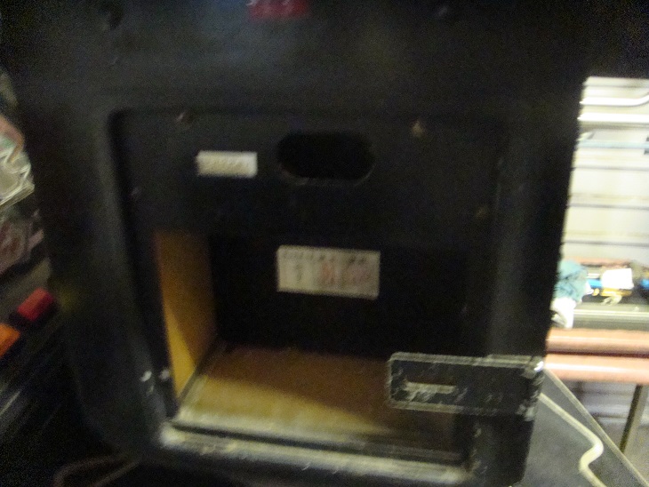

Another thing is the coin door is missing! would love to find one for it so if anyone can help let me know?

Above is the control panel as it is now.

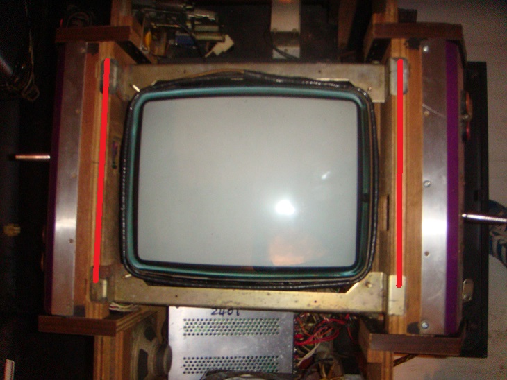

Now I have a dilema! the polo screen is bigger than the original! so it will not fit without butchering the plywood I have marked in red! I would need to router that plywood to half it's thickness down about 2 inches
Or try and get the old screen working but that could be in-possible for me, don't even know what make it is. Also if I fit the bigger tube would I be able to shrink the image on the polo to fit hole in the lid?
What should I do?
butcher the cab to make the polo fit?
Try and get a smaller monitor?
Kill myself trying to fix the ancient unknown screen?

Anyway, it's looking like the Polo monitor will be going in the machine, I have re capped the chassis and fitted a new flyback (thanks Grant) it's now working nicely. Also figured a way of fitting it without cutting into the cab, so should I ever get the old knackered screen working (unlikely) it could go back in.
