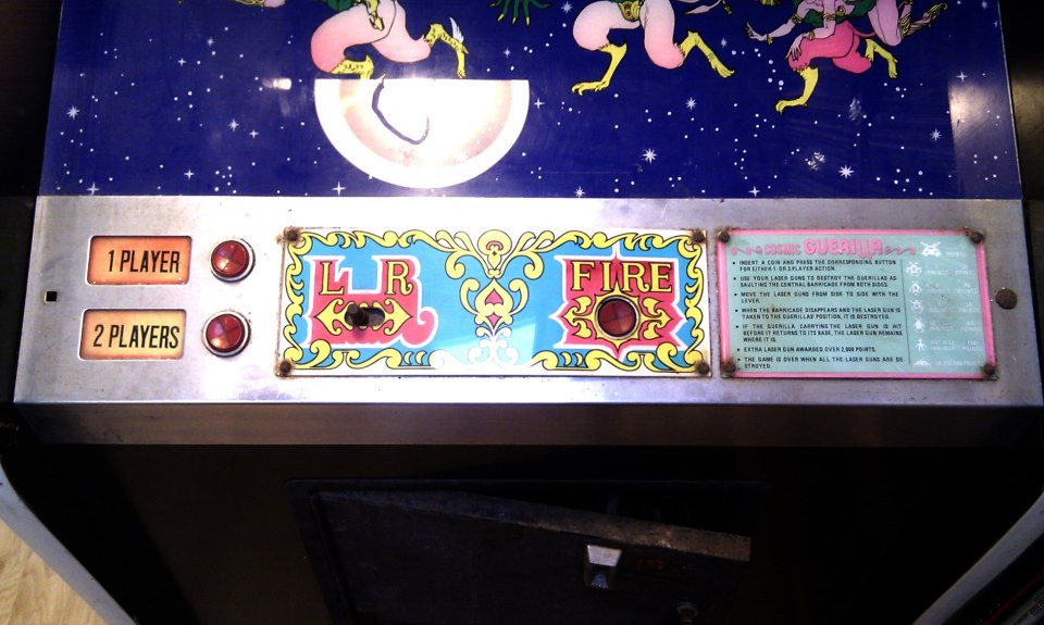

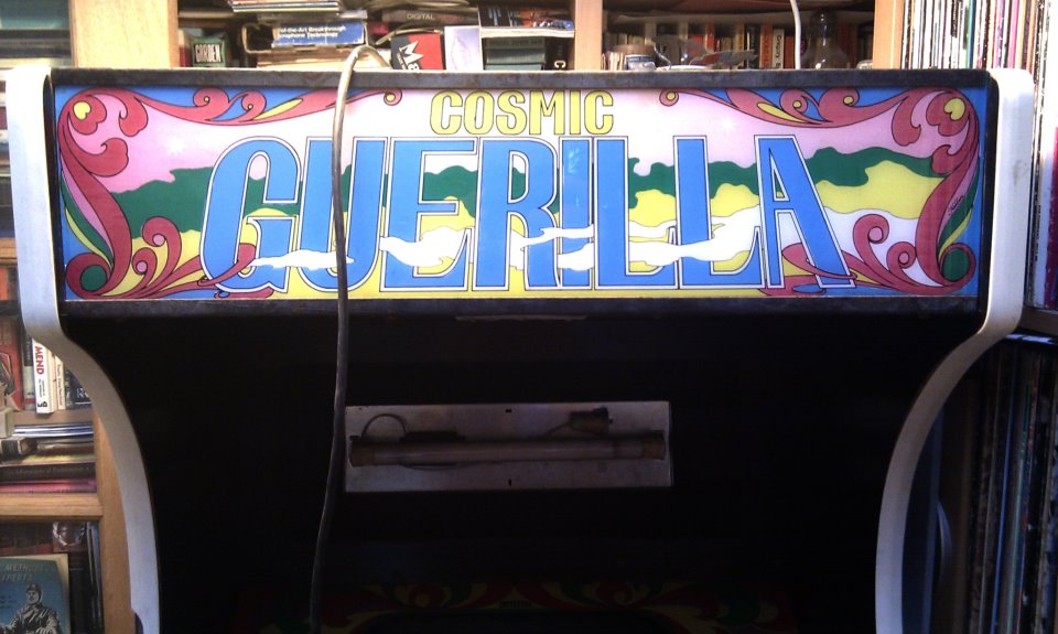

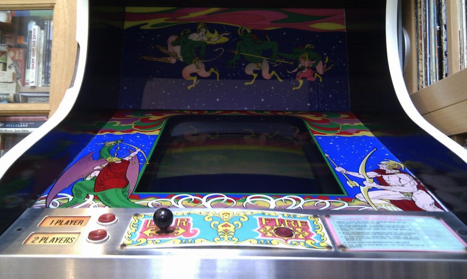

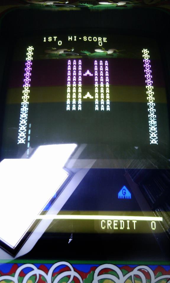

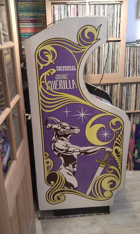

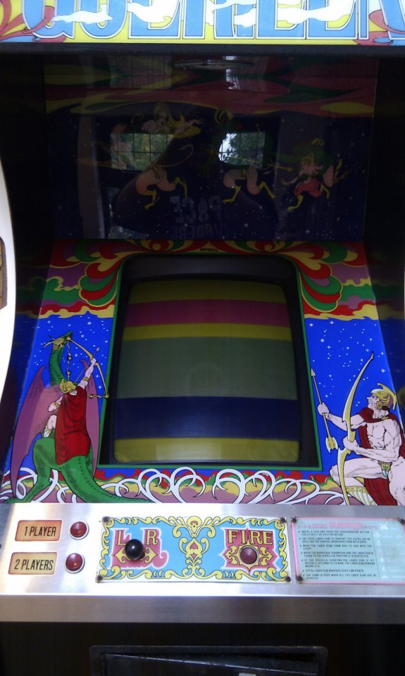

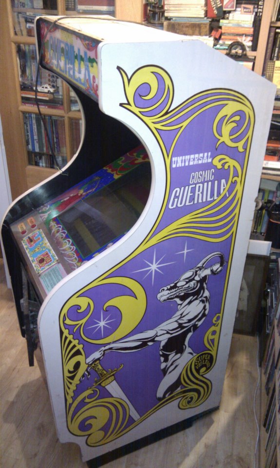

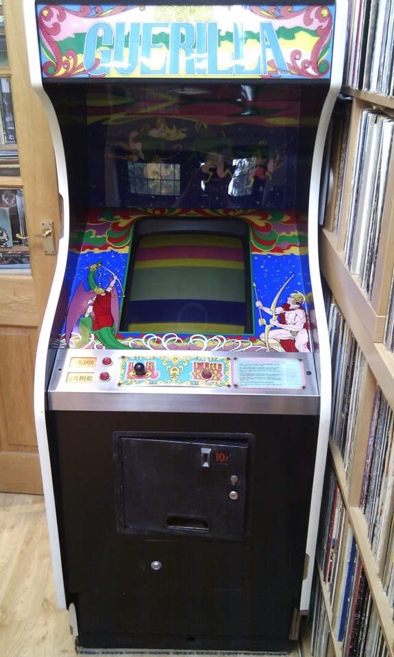

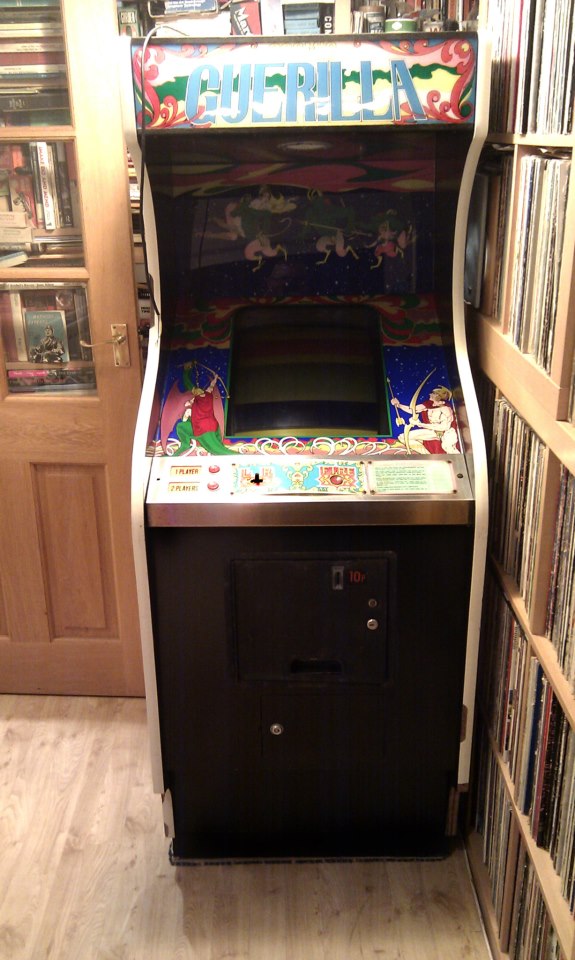

I swore blind I wouldn't buy any more cabs, but hey...
Arrived from Martin today - ex-DoL.
Given it a preliminary clean - came up a treat.
It
does need some TLC...General spruce-up, T-Moulding replacing, New
joystick ball, Marquee brackets and Coin door powder-coating, etc -
nothing major cosmetically though.

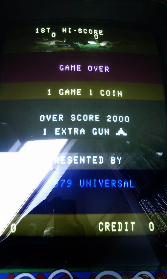

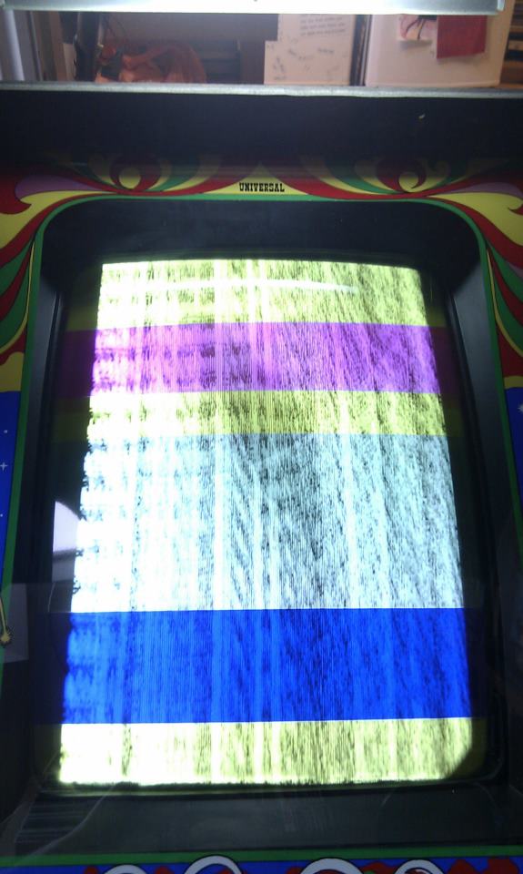

Next job - get into it and test the goddamn thing!

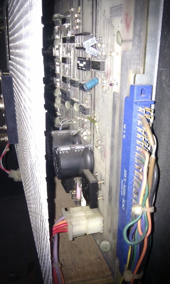

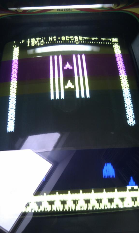

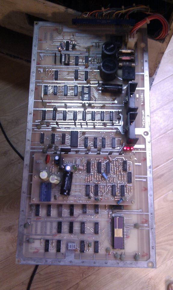

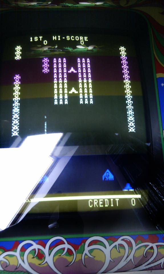

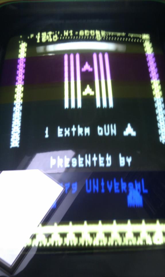

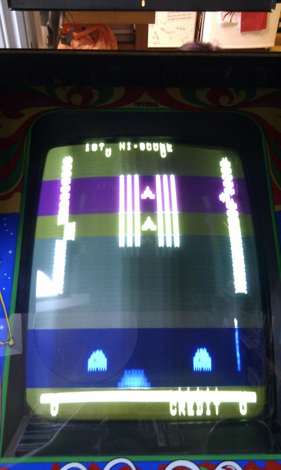

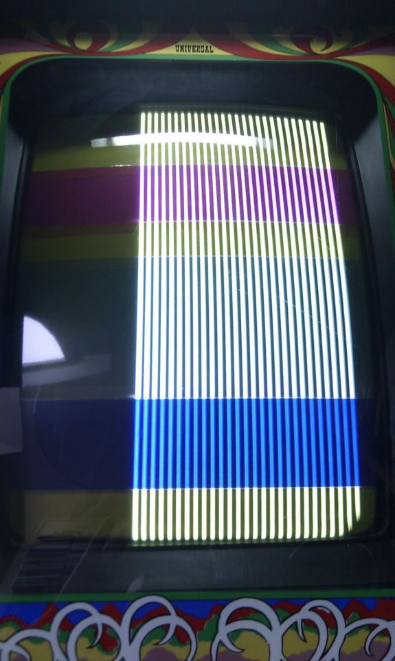

CG can be a real PITA - odd CPU and unidentified CRTC controller (which generates much of the timing for the entire PCB - so if it doesn't get initialised properly ....)
although since that one is basically running, I'd start by looking at the ram - 4116 I think.
I have a PCB for it hiding away, with a minor fault (so I was told) - have to have a look and see
