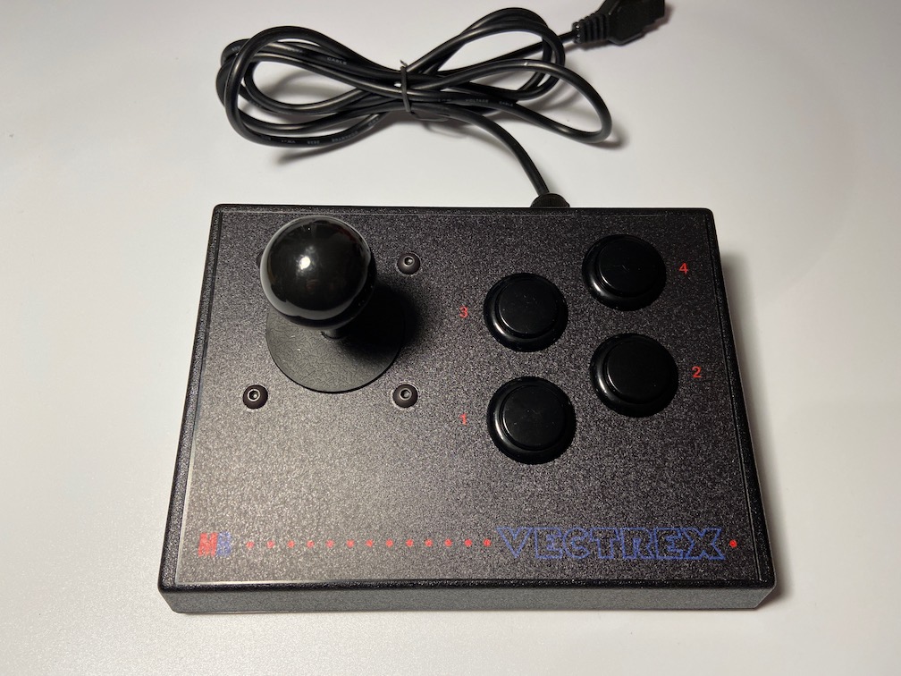

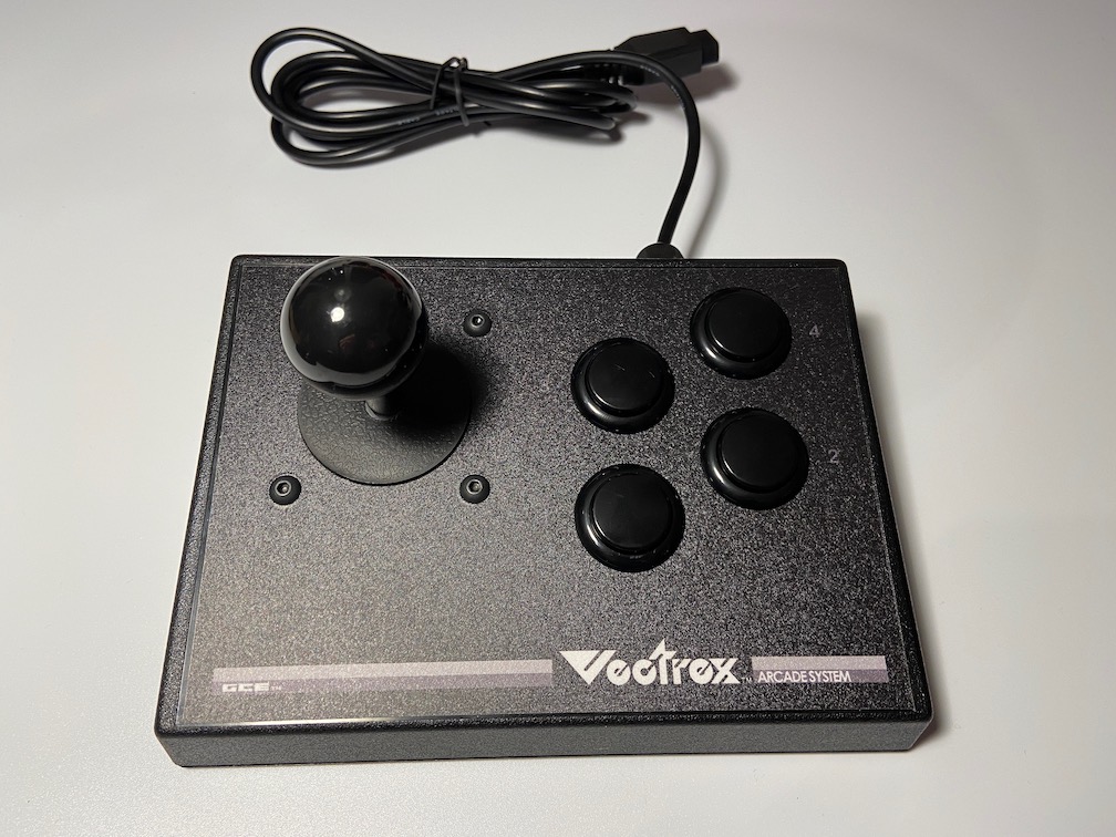

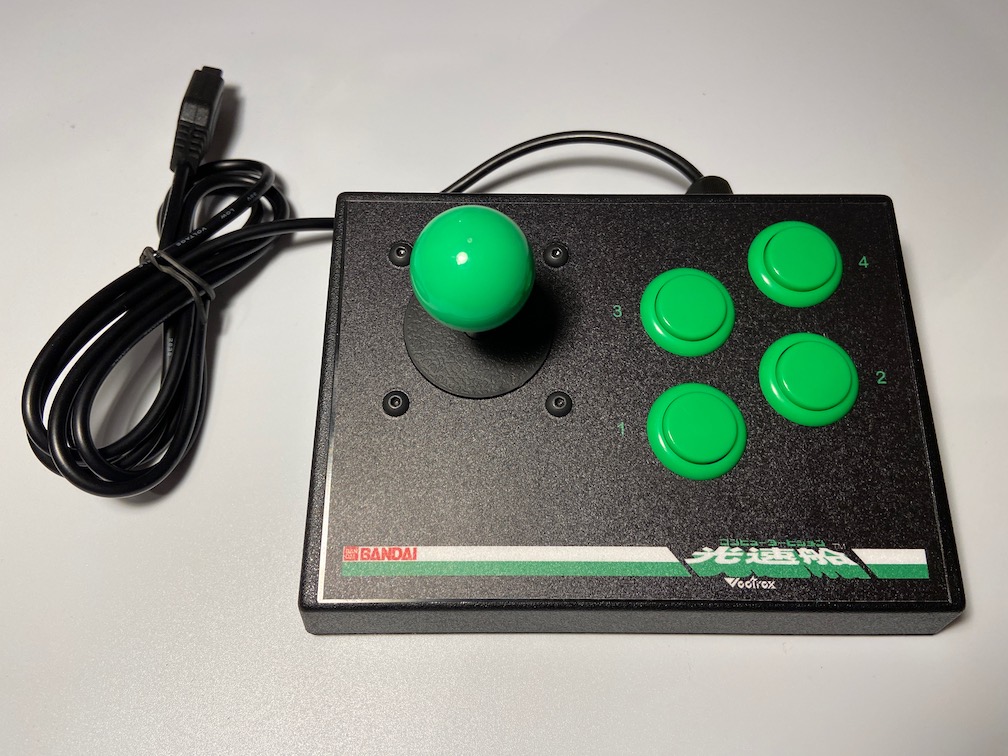

Those of you looking to pimp your Vectrex out to the max might want to consider one of these:
Now I can turn my stereo sound AND VecVox all the way up to 11.
