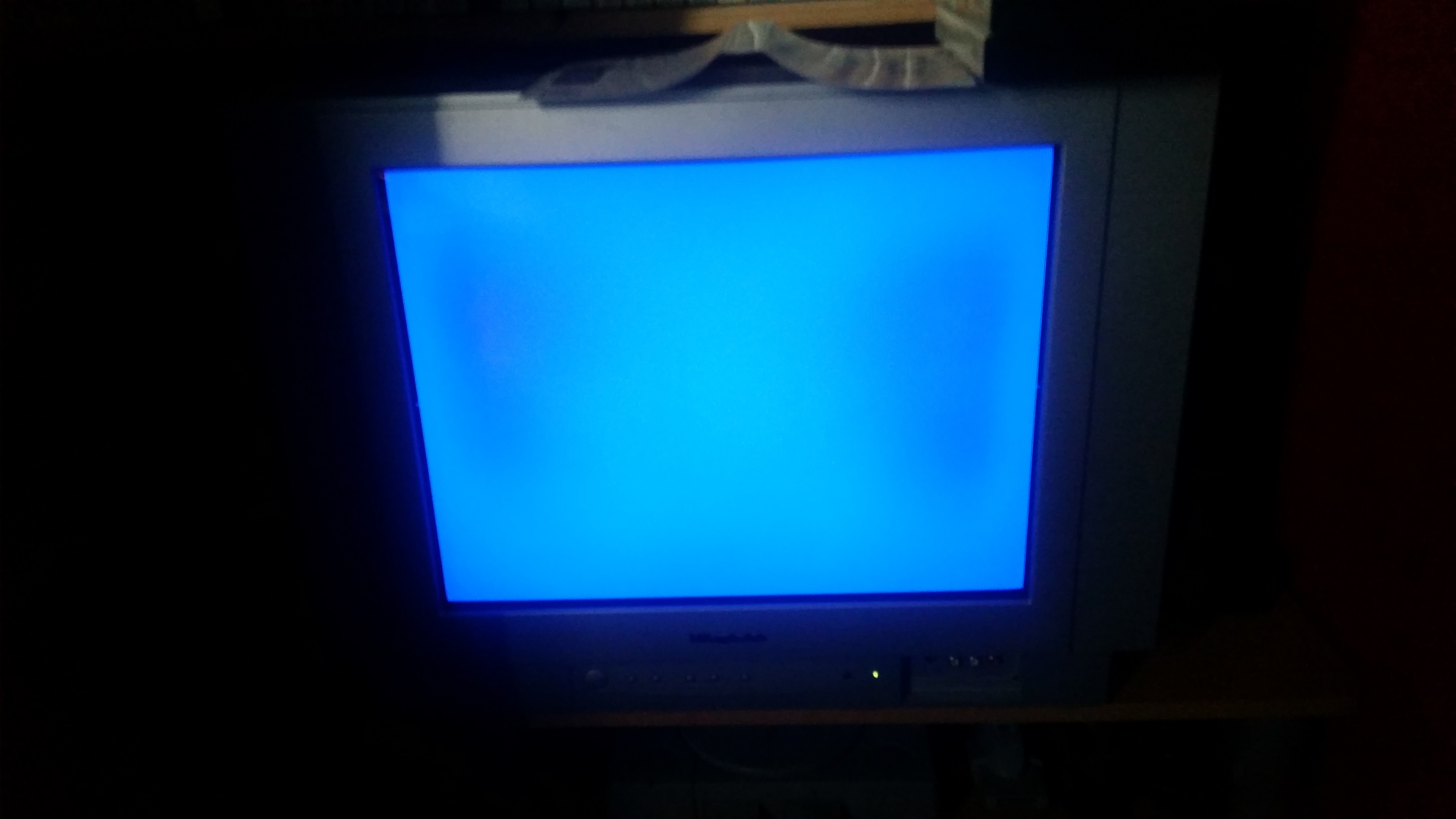

i use an old CRT tv for my classic gaming
noticed that after a few minutes of gaming on the TV i get some color smudges on screen which looks like magnetization to me
purplish on the left and brown on the right
but what the weird thing is its ONLY happens while gaming and by flicking the AV to a no signal channel is actually clears it up but once I go back to the game within minutes its back again, its not console related as it happens with all my consoles.
iv not tried it with TV stations but i assume it would be the same.
i dont have a clue whats going on, any help would be appreciated

Need to see some pics mate.
If it goes away when you have no signal then that will probably be because the guns aren't firing anything at the phosphor, so you wouldn't see any visual effect.
magnetic field of the earth will effect the tv as you rotate it 360 degrees so it might be that, like I said hard to tell without pics

hi mate heres 2 pics.
i dont have anything nearby that i would think would megnetize the TV.
only thing i dont know much about thats nearby is a Surge Protector but dont think thats got a magnet in it does it? lol

With purity issues like it caused by magnetism.
Depends when it shows up. some colours show it worse than others, primary colours like red, blue will show it bad, if the screen is displaying bright white u may not see it
If you have moved the tv recently that could be it, two crts close together can affect them
Degauss circuit may be faulty
Speakers are made for the tv and distance is far enough away or they are shielded. Unless someone replaced the speakers
If crt has had bad knock it can move insides
My first jamma cab was strange. The crt was great picture and on most screens it looked perfect. I was running mame and thick it only showed on light blue screen when shutting down, it had a circle in middle of screen, quite faint but it was more like it was burnt into it, but perfect circle probably bigger than cd
Never seen that before. So can be few things.
joe34
448CR
just thinking out loud really but maybe a test to do to see if the 'smudges' on your screen are related to magnetism or not is, get the tv going with an all blue screen so you can see the smudges (like as in your second picture in your first post in this thread). now, keeping the tv on, if possible (ie. if it's not too heavy), try to rotate the tv onto its side (either side) so it is in the 'vertical' position instead of normal horizontal position.
while you are doing that, look carefully/closely at the screen and see if any of those smudged areas change in any way (eg. in colour, size, shape, position/movement, etc.. also: unlikely but still; listen for any odd sounds). report back the results here and perhaps that might give some more clues as to pinpointing your problem.

hi there. when tv is tilted to the right the brown smudge or the right side disappears and the left side purple is even more prenounced. iv actually just picked up a new TV and its still the same results. iv even used the TV in a different room and same thing happens
Mame4All
41CR
i dont think the degaussing circuit is faulty because when its powered on from a cold boot the screen is perfect so i presume its doing its job. but then after a minute or so it starts to GRADUALLY work its way back to the smudges. weird
