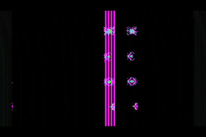

Looks like Sprites at certain Y values do not render correctly... (and maybe sprite colour is leaking into character colour)...
This is eight sprites all sprite 28 (hex) rendered at y=80 and y=A0, all colour 01
NivagSwerdna
836CR

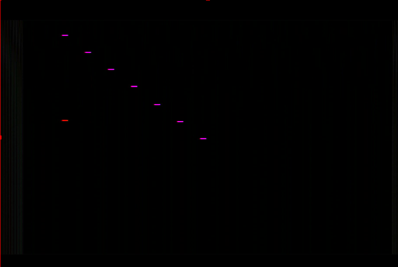

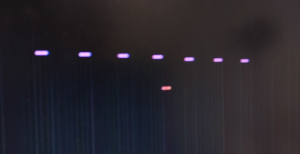

Bullets and Missile seem to render OK albeit in purple, red rather than white and yellow in Galaxian...
so it really looks like Sprite colour at certain positions is the problem... might have to think about this for a bit as it is far from obvious to me!

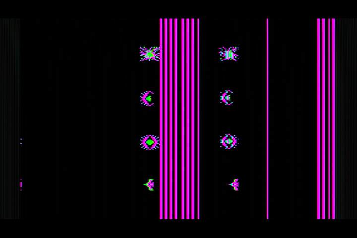

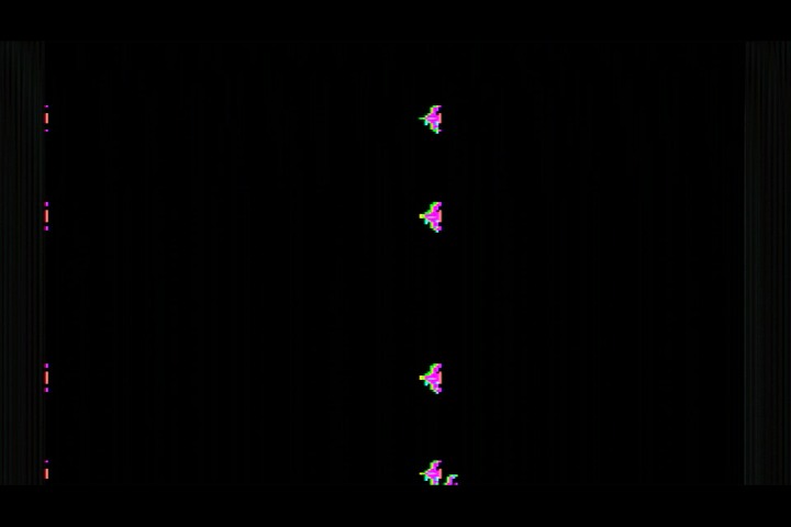

Another weekend and another tinker... Socketed the Object RAM and tested the existing chips... seem OK... put in a couple of new ones for the time being... Removed all the Sprite RAM and tested individually... noticed that two had pins bent under and not contacting the sockets... swapped them around randomly as I put them back... Now the Raspberry Ripple effect is gone! Yay!
Sprite rendering has got a lot worse but at least it is limited to Sprites only now...
This should show eight sprites... I see only 4... and they are not rendering correctly either... one step at a time...

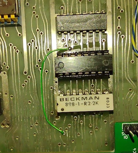

Discovered that main RAM was no longer passing and this was causing me issues when testing sprites..
Anyway the Brown Bodge wire that I never understood had come away, taking part of the track it was bodged too with it causing a break in the trace that gets from the CPU via the transceiver at 9B to the static RAM at 7N.
Removed and socketed 8D for good measure.
It sort of makes sense now. The brown bodge wire was to fix a broken trace marked A which they must have broken when installing the pull-up resistor pack that has mounted the decoder at 8C (which together produce the CS for the ROMs). They decided to attach the brown wire to the trace on the other side but didn't secure it with glue etc. and wear and tear have taken their toll.
Removed the bodge and replaced with a prettier bodge going from VIA to VIA.
Happier now and another bodge to add to the list of understood bodges.

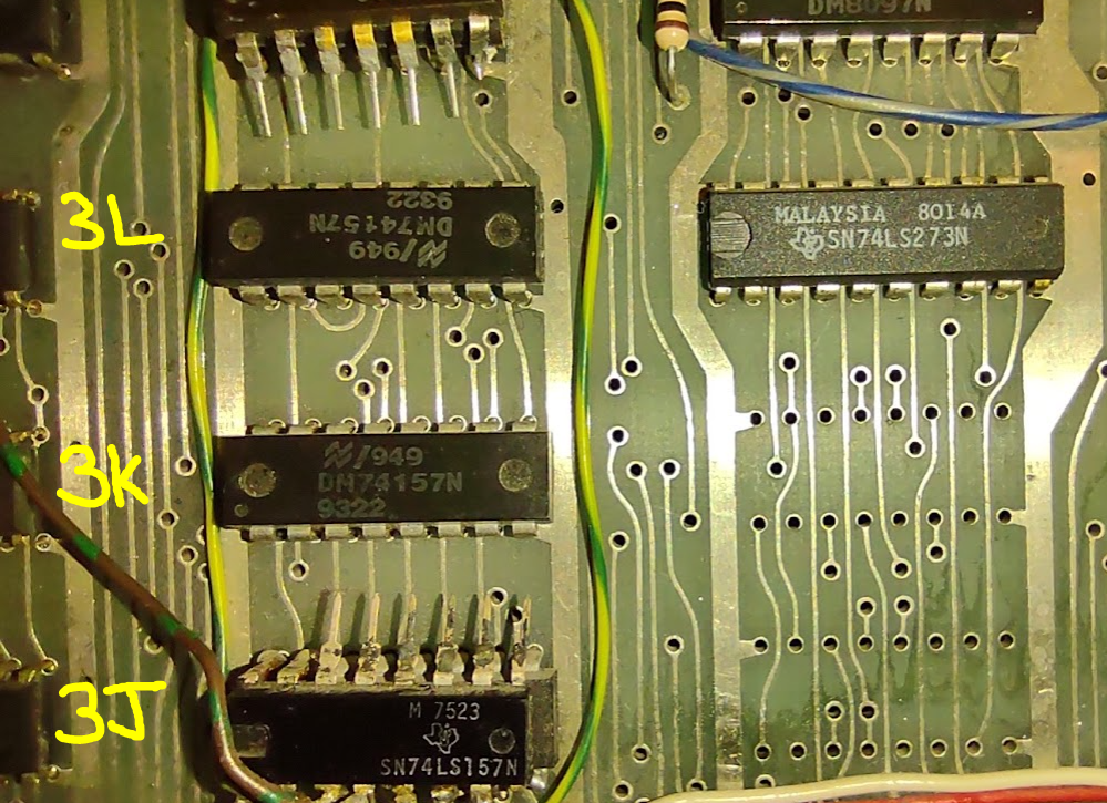

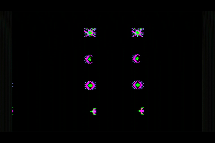

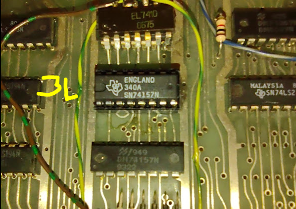

... in the previous photo it is 3L that is installed the wrong way around!
Removed and it is not surprisingly fried... socketed and put one in the other way around...
Sprites are different... but we aren't there yet!

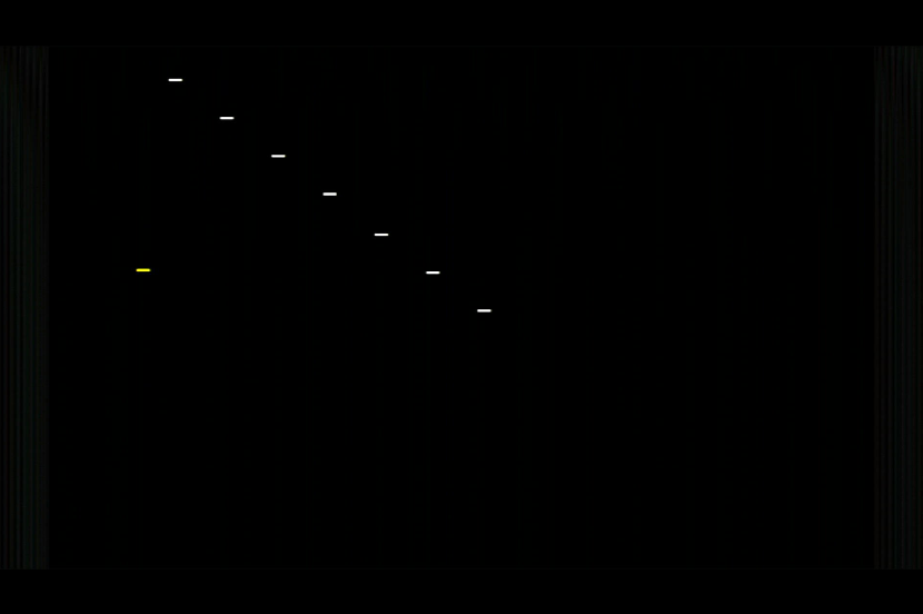

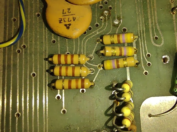

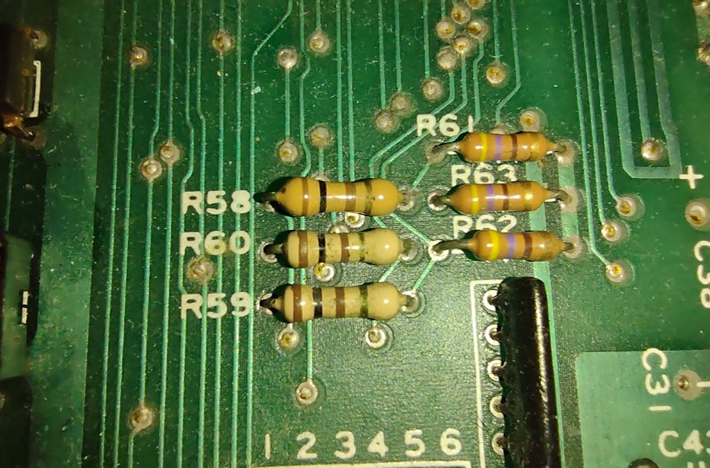

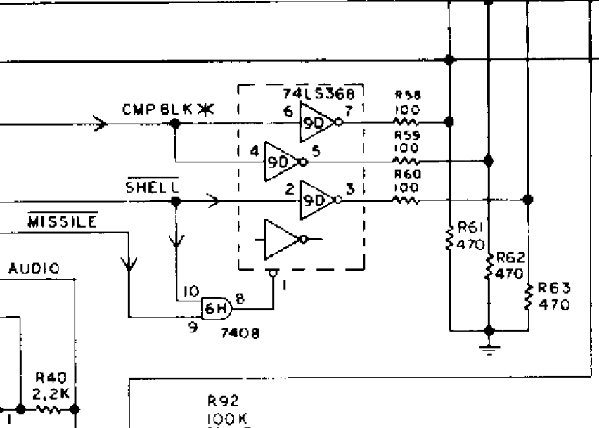

Now the sprite RAM is replaced moving back to Shells and Missile generation... I think this should be the same as Galaxian... i.e. Yellow or White..
Clearly not as expected...
on my Galaxian I see...
but on the Moon Cresta I see...
Obviously no effort to make it look pretty... come on guys... line up those resistors...
Yellow Violet Brown Gold is 470 Ohm +/- 5% so that appears sensible on both boards..
Brown Black Brown Gold is 100 Ohm +/- 5% so that is as per the schematic on the Galaxian.
My colour blindness makes pesky resistor colour codes challenging... Brown Orange Brown? 130?
In any case the values are not far off 100... I would expect White and Yellow for Missiles & Shells?

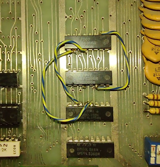

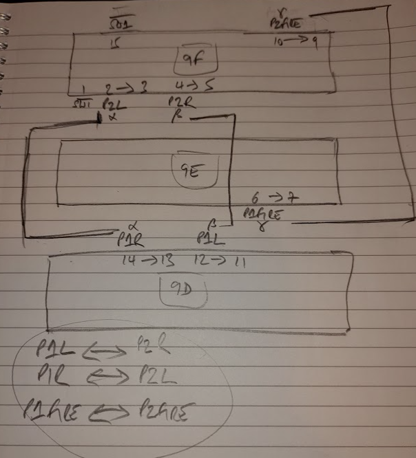

Whilst I ponder replacing the 74LS368 which drives the colour output for shells and missiles I thought I would look at the spurious wires on the other 74LS368s...
Looking at the schematics...
so this is a bit weird... Player 1 Left is wired to P2 Right, Player 1 Right is wired to P2 Left, and P1 Fire is wired to P2 Fire. Not sure why!

Socketed and replaced 9D and got no change. Found what appears to be lack of continuity between one of the missile/shell resistors and 9D, so small I cannot really see the break, so repaired the trace.
And now...
Perfect. We are back to the Galaxian White/Yellow colour scheme that I expected! Yay!
