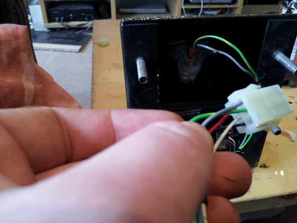

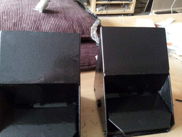

As its only 360 games now I dont need the

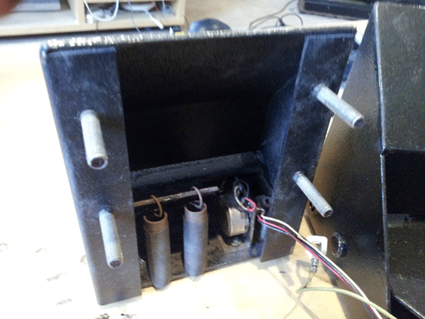

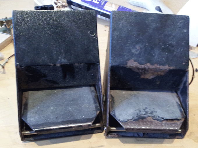

Happ dual pedals that were on there so came across these pedals that are

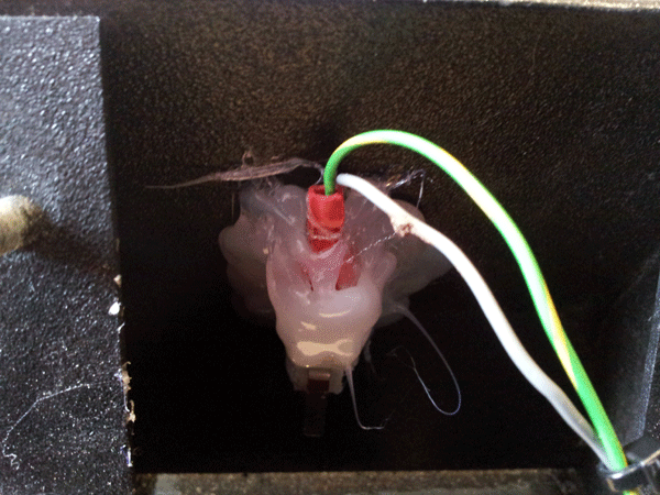

pot based (hot rod as far as I know uses a pot) that came out of
scrapped road riot cabs and hot glued a microswitch in for the other
games
Pedals before
Pedals after
Pot inside pedal
too much glue lol

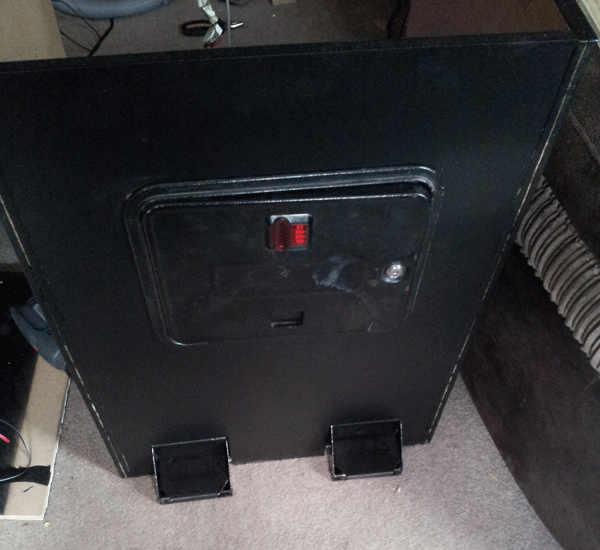

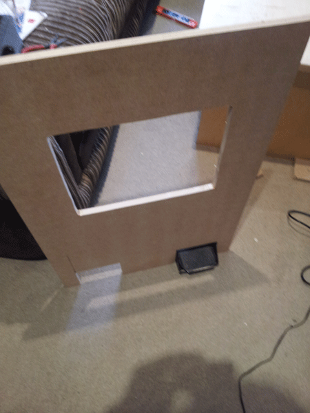

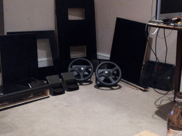

The
cab itself was pretty scruffy so I lightly sanded and repainted it and
cut new parts for the pedals, coin door, back door, stripped the flaking
championship sprint CP off and sprayed black.
test fitting pedal
painted and installed into cab
coin door cleaning and t molding to come :)
all the parts ready for assembly

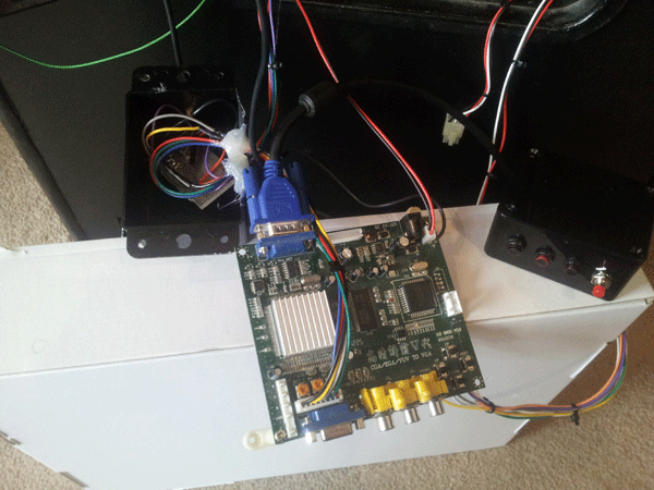

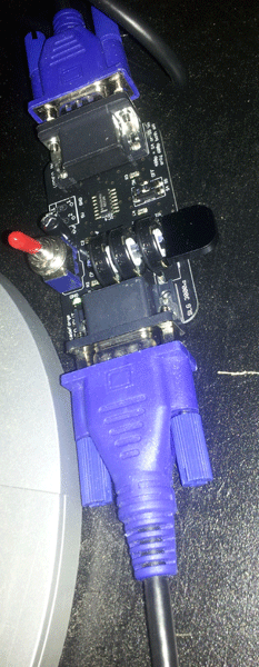

to
be able to handle vga, scart from the supergun and medium resolution I
went with a cga converter and followed fagins LM881n cga to scart hack, http://shmups.system11.org/viewtopic.php?f=6&t=35423&start=30
and also soldered wires onto the buttons and placed them in a project
box for easy access. The cga as well as the lit Happ concave buttons are
powered with an old motorola phone charger. To light the happ buttons I
did this little mod. Really easy and adds a bit of shame bling! http://wiki.arcadecontrols.com/wiki/Lighting_Microswitch_Buttons

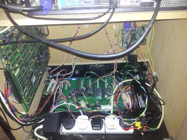

inside of the cab is a bit of a mare at the moment tbh. the top shelf
has a mame pc the volume control for the little JBL speakers and a 2
input VGA selector so i can switch from pcb to mame at the flick of a
button, both situated just inside the coin door.
On the bottom
there is a jamma psu, supergun, 6-1 jamma switcher, apac and optipac.
and the wheels runner PCB, the other pcbs will be mounted there as well,
gonna have a go at wiring up Badlands today.
I have wired all
the usual voltages grounds pinouts and video rgb and sync to a jamma
extension fingerboard plugged into the 6-1 switcher and have taken the
wheel and pedal outputs to seperate harnesses to be plug and play. The
only rewiring i have done is to send the wire from the coin switches to
button 1 on the Supergun then that is wired to the coin reject using
piggyback crimp connectors on the microswitches so mame and pcbs can be
used simultaneously. This will be repeated for the hot rod and badlands
so they will al work the same way.
This looks grim and will tidy up the wiring today! but heres a look at the mess lol. Its safe, but a total mess!

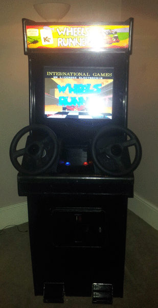

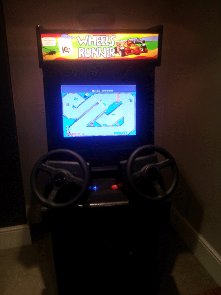

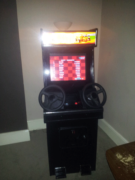

Its
come out quite nicely and still needs a fair amount of work, so being
impatient I closed the back door and installed the marquee, t molding
and other fun stuff.
The only Wheels Runner cabinet in the world? lol
The
game is all wired correctly however there is an issue with the
sensitivity, its way too sensitive. It has been suggested that an Atari optical encoder might
handle the input better. Alpha1 has a Badlands CP that
hes kindly offered so im going to try when ive received it.
So its still a work in progress!! its playable but not quite there yet. so the saga continues

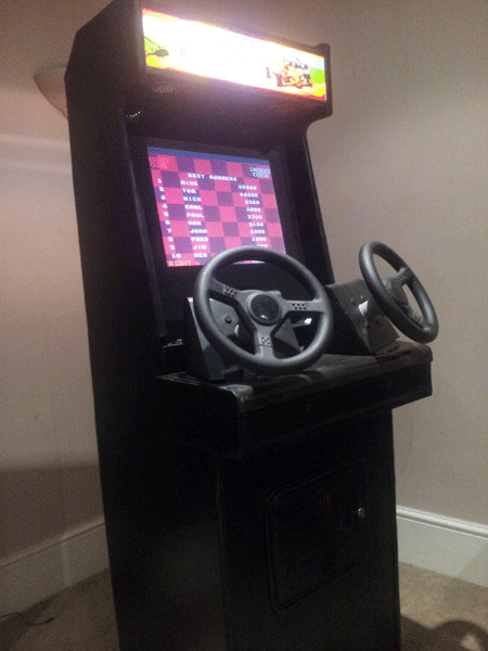

The
mame setup works fine through the apac and optipac. I'm inching ever
closer to a game of Wheels Runner, a holy grail for me that no bugger
has ever heard of
Heres
a very badly shot video, mainly to demonstrate the sensitivity problem,
you only need to turn the wheel very slightly to steer the car, and it
goes in the wrong direction sometimes, and as we all know part of the
fun of these games is being able to sling the wheel about!
apologies for vid quality!
http://www.youtube.com/watch?v=LHOLMZD4Ei4&feature=youtu.be
