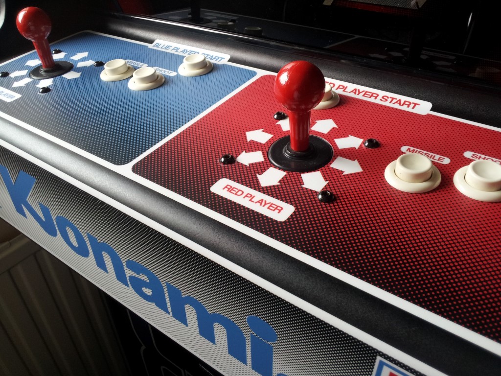

The EC reds came as two kinds, a short throw and long throw. so I guess it depends on what you are used to there.. IF they were short throw - they were made by coin controls aka Suzo so then a perfect match for those would be suzo happ euro sticks. arcadeworld sells them and they have a 8 and 4 way twistable restrictor and a couple of slidable parts to make them 2 way. the moulded ball is a size bigger than the reds though but are a very nice stick! http://www.arcadeworlduk.com/products/Happ-Series-500-Universal-STC-Joystick.html
I never liked the long throw ones much (but somehow managed to collect a few of them
) so can't recommend anything for those. I guess you'd be in Japanese stick territory?
Here's a shot of a couple of short throw reds. the long throw version has a standard dust washer and hasn't got a molded bevel..
(Incidentally if anyone has any short throw ones they don't want or want to swap for long throw let me know)
