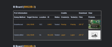

I would try this set from PLD archive:
B Board (89624B-2)​
https://wiki.pldarchive.co.uk/index.php?title=Strider
Do the PAL locations match your board for either this one or the (88622B-3) Gals?
