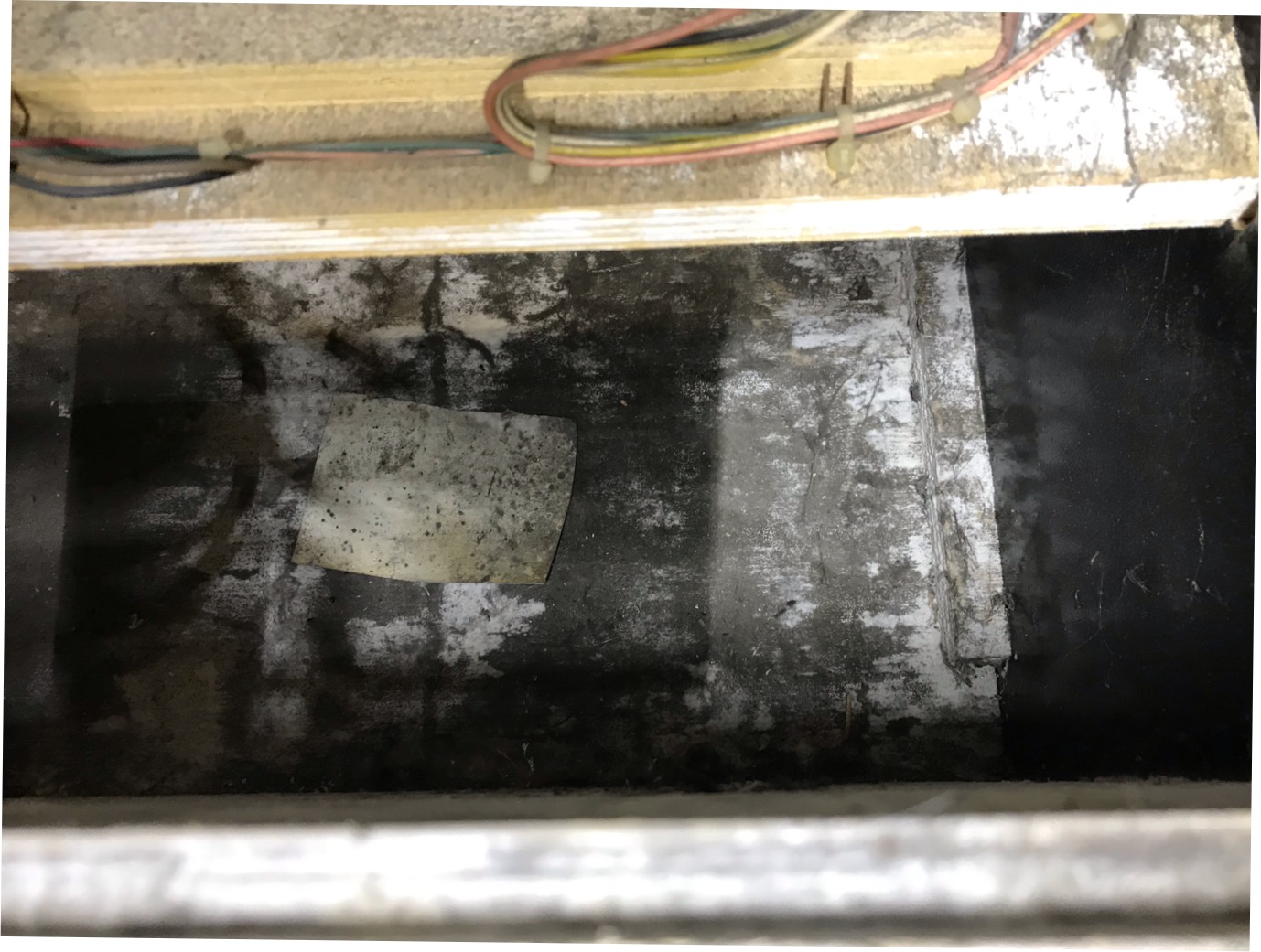

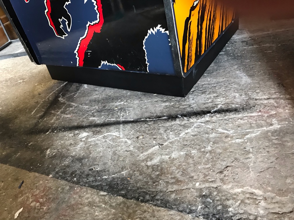

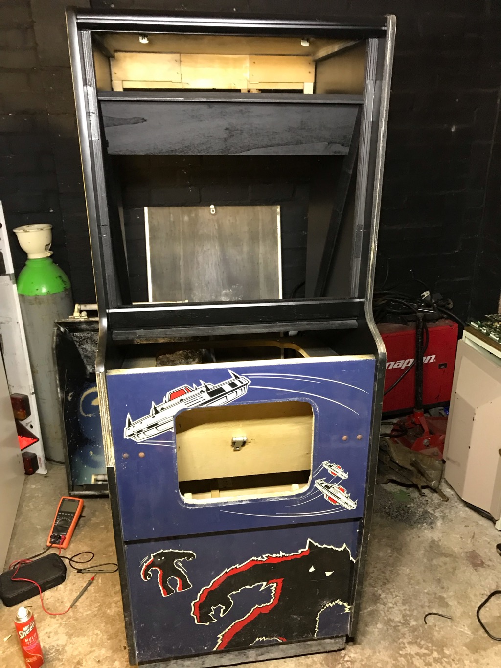

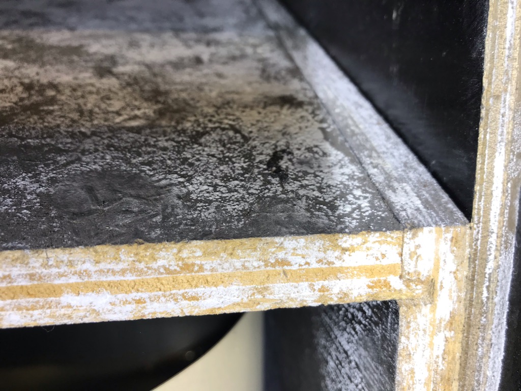

We have a minger here, full of that strange white mould stuff.
Anyway, Martin dropped this off the other day, I’ve left it until last night to make a start on it.
Screen smashed, not working as far as I know (well looking at the state of the cab I highly doubt the pcb works.).
Starting with the cab.
(I’m after more cabs like this to fill my garage so i like a challenge if anyone has any they want to sell on and I’ll make them nice again).
On with the show....

Cab is now stripped bare, it took me a while to figure out how to remove the bezel, you do so by undoing the 2 tabs underneath the top panel and sliding the tabs back towards rear of cab then the bezel pulls up and out from the front.

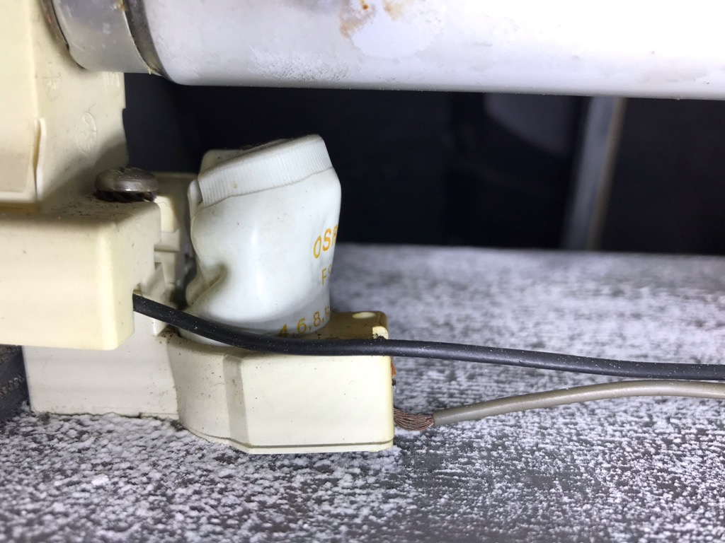

The connecting socket for the moon ballast was broken due to a siezed screw when I tried to remove it, Baker lite material breaks easy. That will have to be replaced with a new socket and plug.

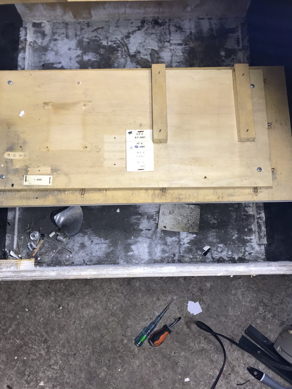

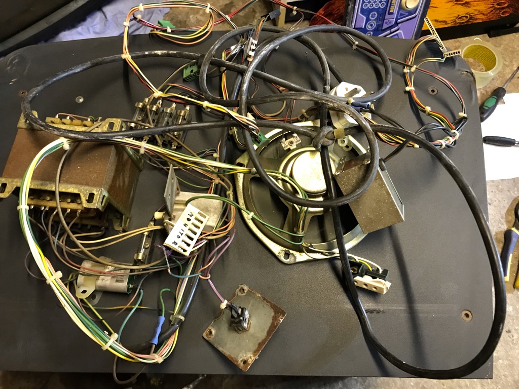

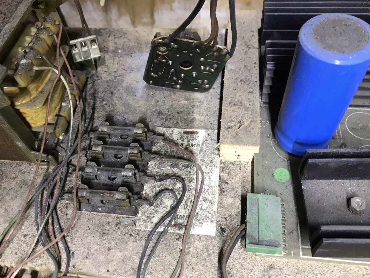

All wiring now removed along with PSU, pcbs, noise filter and speaker, I would’ve removed the lot on the main wooden panel only I couldn’t remove the screws so just removed the lot from the panel.
Photos below of pcbs and broken monitor, time to hoover the bottom of cab out with my trusty hoover which has 2 filters (I don’t like the look of that white mould).

It was already broken when I bought it, would love to know the story on it, I’ve never seen one broken in that way, it was also necked.
The PCB is not the original one as the lines on the connectors did not line up so it's been swapped out at some point.

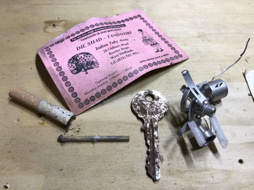

Nothing exciting found in the cab, just a Benson & Hedges special filter stump, guns from the crt, a front door key, match and a restaurant card.
Stevros2019-06-06 23:19:19
Stevros
505CR

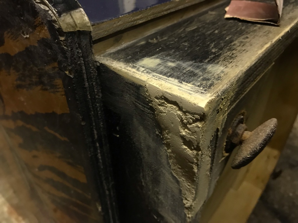

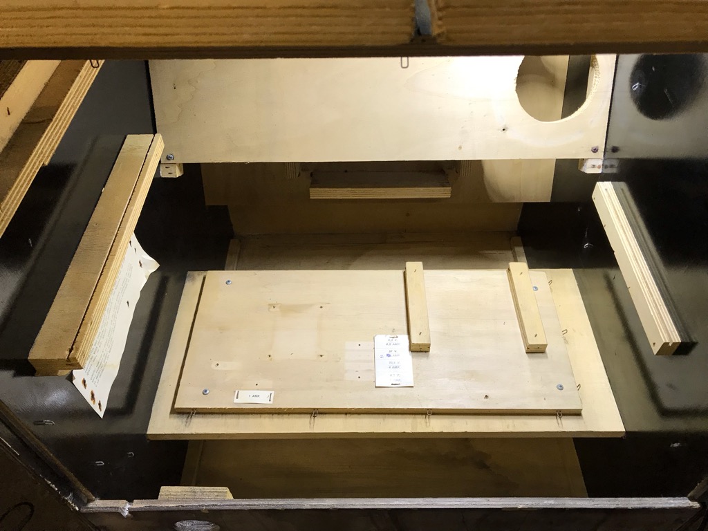

Cab is now bare and cleaned out, all the white mould gone.
Cleaned the sides with some polish and went over with a dry tac rag.
Painted front top above bezel and under bezel as well as inner top where moon cabinet sits.
Starting to look a lot better already.

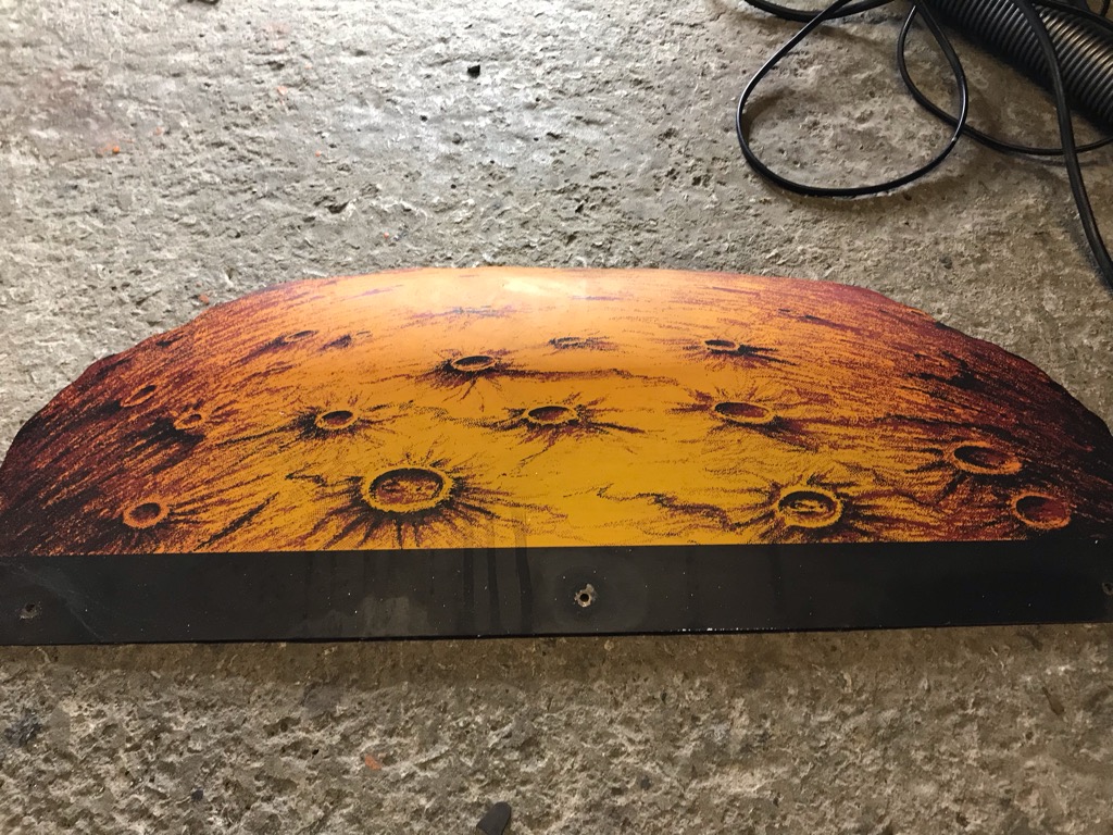

I will be cleaning up the moon cabinet next including the backdrop.

Yeah that White stuff is Mold from damp! Least you didn't do what I did when I cleaned my Tron and did it without wearing a Mask!!

I was impatient, I couldn’t find my mask so I used my T-shirt, then upon getting a fresh rag from my drawer i found it under the new packet of rags!
Edit: saying that I only touched it with the hoover which was on full blast, that got rid of almost all of it before using the rags. Stevros2019-06-07 08:01:05

Well least you did that!! I was Brushing all that crap off in the Garden with a Brush as didn't know what it was till reading later on the Forum!

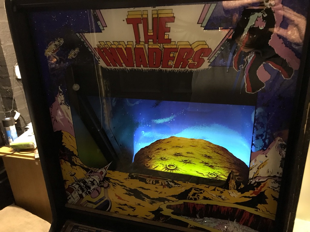

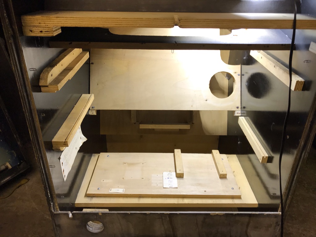

Here’s where we’re up to... spent a while sorting the backdrop part out whilst listening to Donnie darko in the background. I’ve put this part of the cab back in to save it from damage so will update the photos again later.
Stevros
505CR

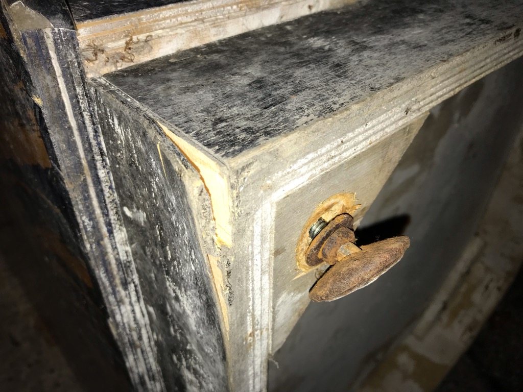

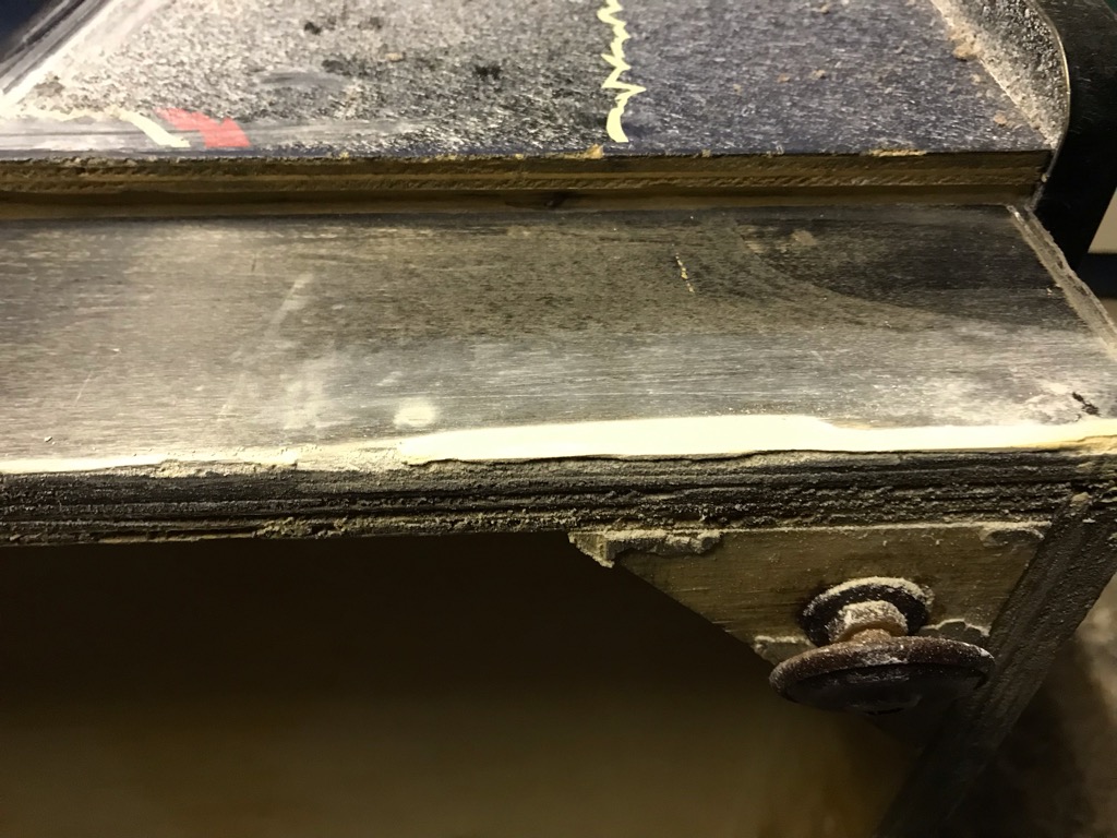

Base repaired with wood filler and painted, noticed I missed a bit of paint this morning but I will sort that later
New black lights bought (one is for my space invaders part 2).
Moon cleaned up well
Top box restored, although there’s a crease in the cardboard backdrop it will be replaced when and if I find another.
