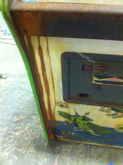

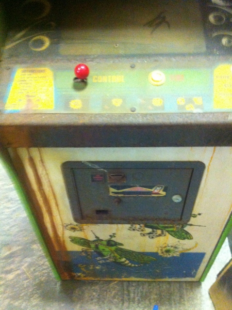

I hooked up with Rav this Thursaday to purchase 2 cabs, a Stern Scramble and an Atari xevious. Whilst there as it was my first visit to his vault of wonders I asked to have a look around and had my eye taken by a fairly poorly looking Galaxians. This machine was rescued on The Duke of Lancaster Raid. Sadly it had suffered from rusty water dripping down onto the front and I thought that it may be too far gone and would require new art work. I agreed a fair price and took the gamble and loaded it up with the other machines. This is what it looks like.

I started with the Stern Scramble which Rav told me had a monitor fault. It had the plug ripped off by being trapped whilst be moved prior to my purchase, so the first job was to fit a plug. Working out the american wiring proved problematic but a quick call to Rav cleared it up (Thanks again Rav). Whilst doing this I decided to spot test the rust on the front of the Galaxians. I had done a bit of research the night before and read various posts on the internet about how best to remove rust. A number said to be wary of certain chemicals as they will set the rust. Most suggested using lemon juice and salt. So I ignored them all and decided to take a gamble with some acid I have for cleaning car wheels!!!

Back to Galaxian to see if the acid worked and with a bit of agitation some rust came off. This was a right result to say the least as I didn't think anything would shift it as it was really heavily ingrained as you can see from the above photos. To be honest I was still very sceptical at this stage and was expecting to have to buy new artwork cpo etc.

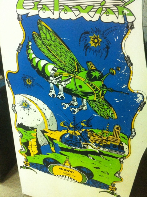

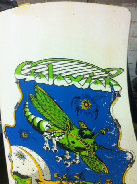

I persevered and a few hours with the acid and some traffic removing fluid (valeting solution) this was the results.

yer.that is really good work,i saw the galaxian and didnt think it would be too bad to remove,as the vinyl on galaxians is rather thick.despite how bad it looked.
damn good work btw!!
i have a minty one here,i doubt i will ever let go
a good clean and some re-painted meatal parts and its gonna be a winner!

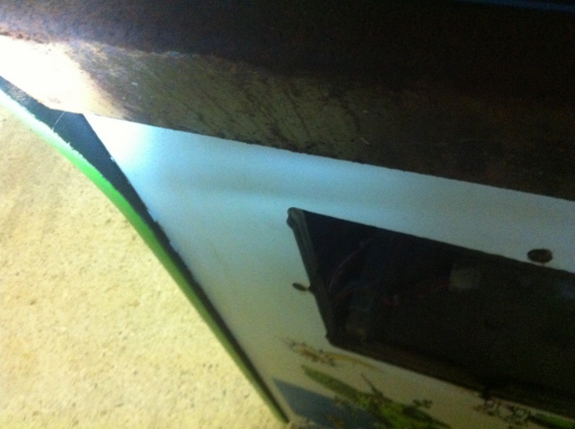

No didn't even contemplate plugging it in as you can see from the photo of internals the sea air has corroded pretty much everything. The fuse holders have rotted out instantly. No board in it currently.
Everything will be stripped out.Metal will be stripped back to clean (in sand blaster or on wire wheel) and re painted in correct colour. Monitor will be overhauled re capped etc and all leaf spring switches will get replaced refurbed etc before the plug gets put in the mains socket. There is a lot of work ahead and I doubt it will get done any time soon as there are 3 cabs in-front of it.

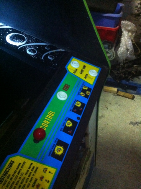

Have just stripped the cp, marquee and coin door metal work bare as was really bad as you can see from photos. Used acid etch primer and then 2k primer for light blemish filling, wet and dried and has all come up good. Joystick shaft and coin insert and reject button have been sent for chroming. I think they were originally galvanised but though I would give a slight bit of bling to it, hoping they will turn out ok.
The coin doors on these are weird as they have a light stone chip type of effect with a metallic grey finish, so i used a worth stone chip from a distance so i didn't get too much build up then went to Halfords to match up the paint. i am happy with the result, it looks pretty close.
Trying to match colours for artwork on sides to fix the graffiti, from kids like me!! Which will be tomorrows exercise and firing the cab up with the pcb in to see if it is alive. It's like this but worse all over unfortunately.
Think it's gonna be a bit of a bastard to mix the colours to an exact match but I am determined. Sorted the black touch ups today with ultra fine artist brushes (courtesy of Aldi!!) and the guy on Ricks restorations who does the free hand painting detail etc makes it look a lot easier than I found it with my shaky hands!!!
