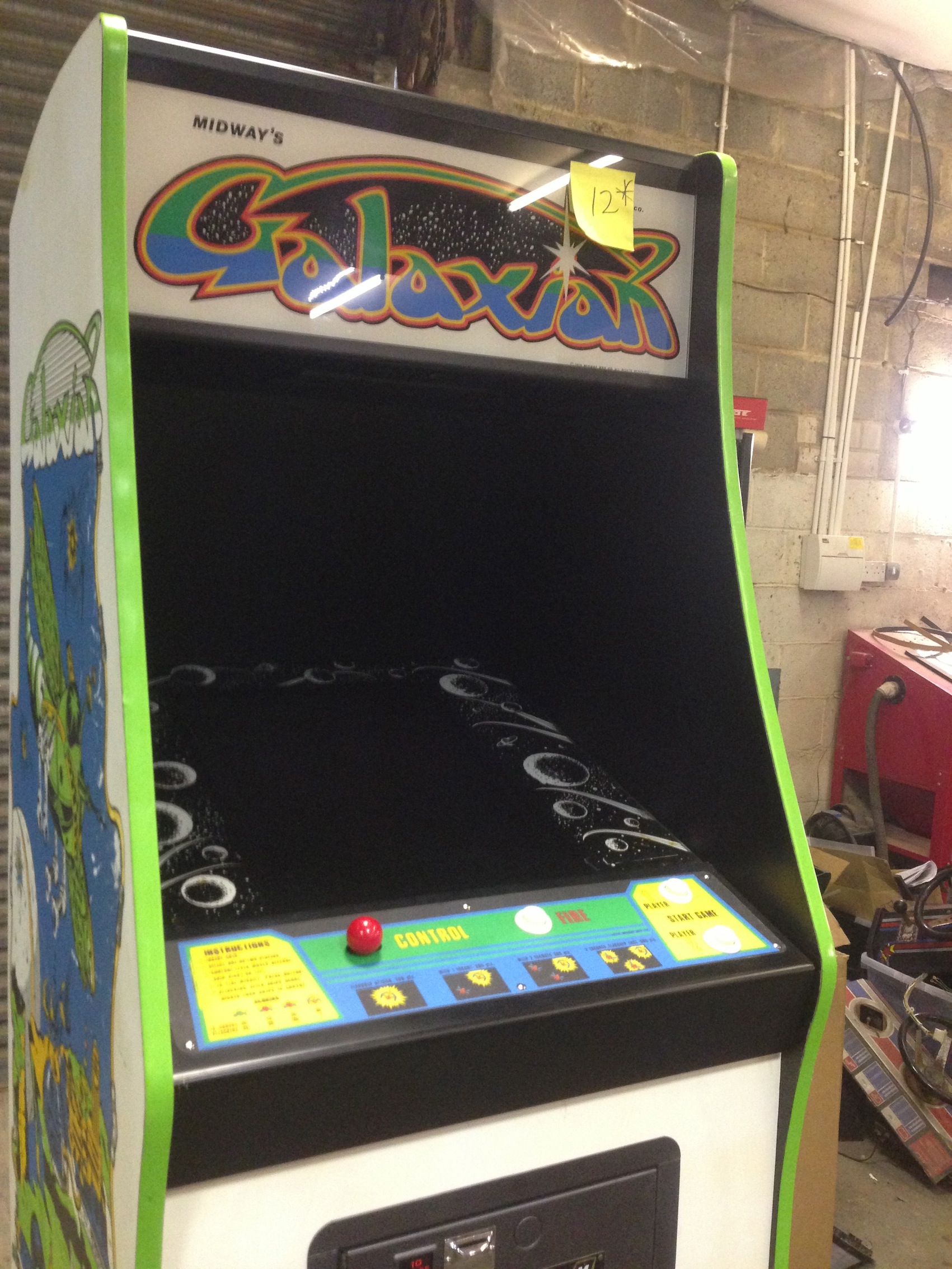

And at Alpha 1's request photo of front. Still got a little more cleaning to do before I am happy but it is already miles better. Then obviously match all the paint and touch in all the scratches graffiti etc.

This is what it looks like currently
Have just mixed the yellow up for the border pipework as it was all worn away.
Had intended to restore the artwork to original so no scratches. Perhaps some feedback here also then guys please.

Ordinarily I prefer to leave the odd ding as I prefer a cab with character to one where all it's history has been sanded and resprayes away to make it look brand new again. BUT...
Galaxian is one cab I do think looks lovely nice and mint. I think due to it's simplicity. I don't think that graffiti looks good. I just see that and think some scrotes needed their fingers chopping off
Another thing to consider here is how well you think you can pull it off. Matching and touching in that artwork is going to be no small feat. If you think you can manage it then fair play to you.
So there we are. A completely contradicting pair of views from a single person. Think you may need some further input on this one

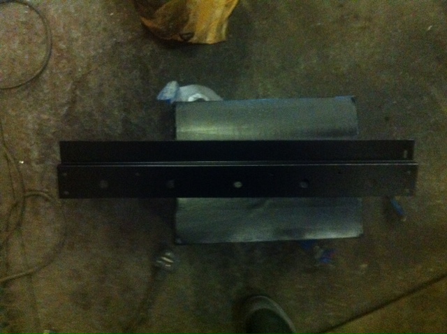

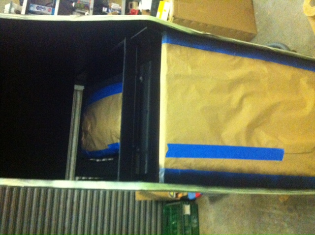

Masked the cab up to repaint the inside and around monitor. removed monitor bracket for stripping an re painting as it was well corroded.
All metal work stipped bare, then etch primed, filler primed and finished in satin black.
Bracket fitted back in.

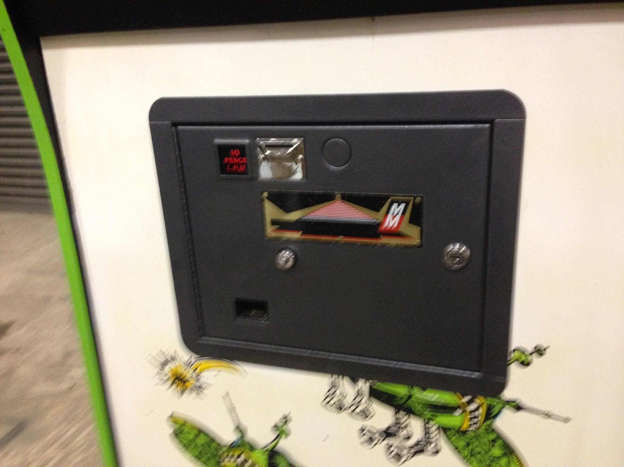

Door was stripped as explained earlier then Wurth stone chipped and then a grey metalic finish, which is close to the original colour.
