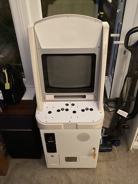

Took delivery of a Dino King this week. I know there’s already been a ton of these threads but I find them interesting nevertheless! The plan is to use it mainly for R type so I will get some dedicated artwork sorted
Cab as it came. Artwork already removed which save me a job

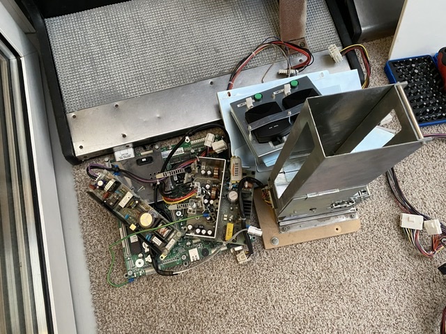

Stripped the guts out today and gave it a clean. I’ve got a couple of generous offers to swap my orange screen bezel for a blue or pink one which would fit the R type theme better. Although just flipping the bezel around makes it look 10 x better with a silver backing!

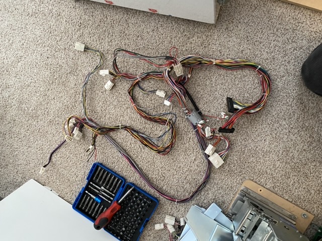

Remove loom
Remove innards

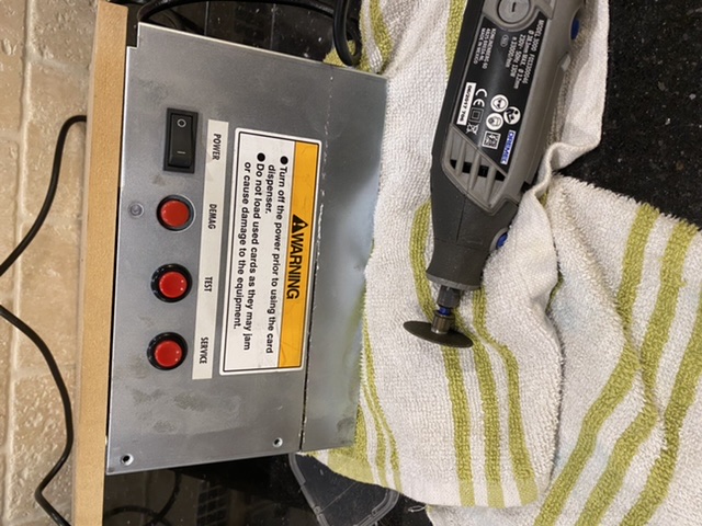

Remove service panel
Trim service panel
Refit service panel
Leaving a nice big shelf for PCBs :)

I definitely need another H-shaped card stacker weight if you’ve got it.
If nobody else wants the main wiring loom/harness and you are not using it yourself then I’ll take that as well.
Will send PM.

Jamma loom prepared

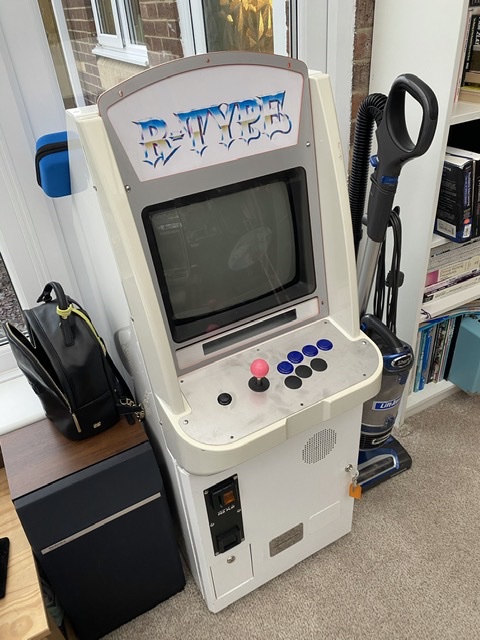

PSU installed
1L7B panel purchased
I’m hopefully going to trade the orange screen bezel for a blue one, then all that’s left is to wire it all up and slap some artwork on
