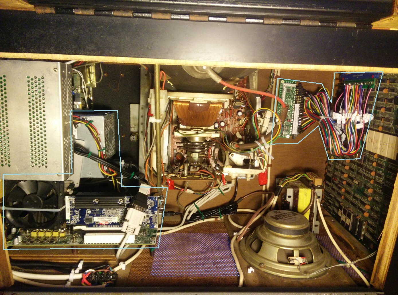

Happy to say I've had a successful soldering session!
I'm at the point where I have the CRT of the cabinet as a 2nd screen which is great. I've installed mame and groovymame and configured CRT emu.
The part I'm stuck on is installing and using a frontend. Can anyone recommend a good frontend with a solid guide on setting it up?
Also, would someone point me in the direction of a good ROM source please?
Pics so far

Waheey! Great stuff, and I'm reassured I'm not the only one sticking bits of post it notes and sticky labels to coloured wires ;) 15Khz out all looking good then :)

Hey Flinnster, yes, sticky labels saved they day for me. Always good to have whatever documentation is available when making changes like this.

Got the PC guts into the cab this weekend. Trying to fit it around the original stuff to allow for roll back in the future if needed.
Still trying to get to grips with the software interfaces. I'm sure ill get it with a little more reading.
