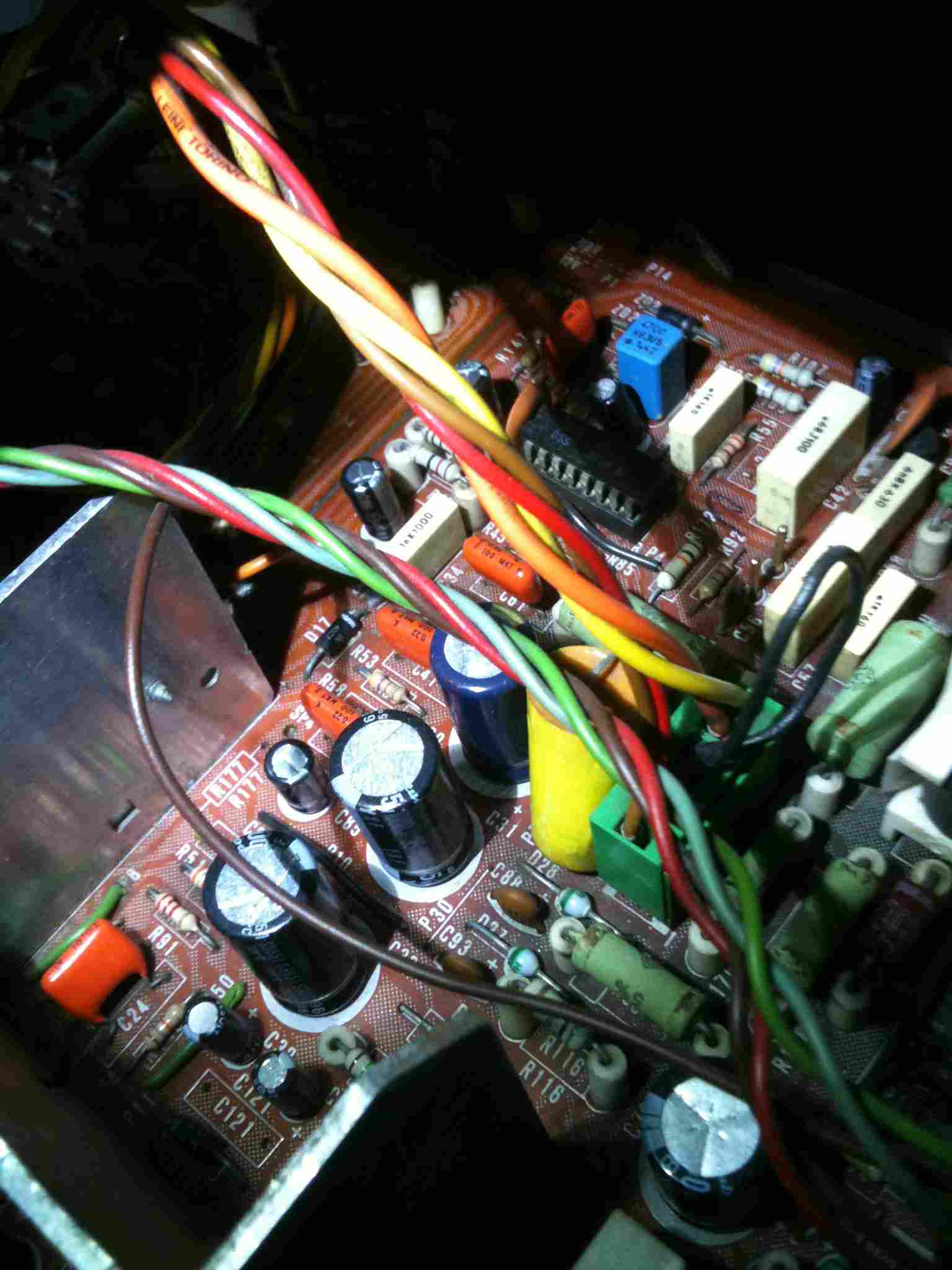

good job on the chassis by the way, what are peoples thoughts on washing a monitor chassis, if left to dry out long enough do you think it would be ok?
i don't mean emersing it in water but maybe washing over with a soapy paint brush then washed off with clean water and dried

If the board is really bad I use anti static foam cleaner on it, the dirt runs off! then another lot with a brush to get it nice and clean or until clean, then a airline on it to push off any remaining foam cleaner, then either a hair dryer on it or leave it out in the sun to dry. I find its a lot better than water and is more inert than water.
I usually only do it to monitor boards I really want to hang on to!
