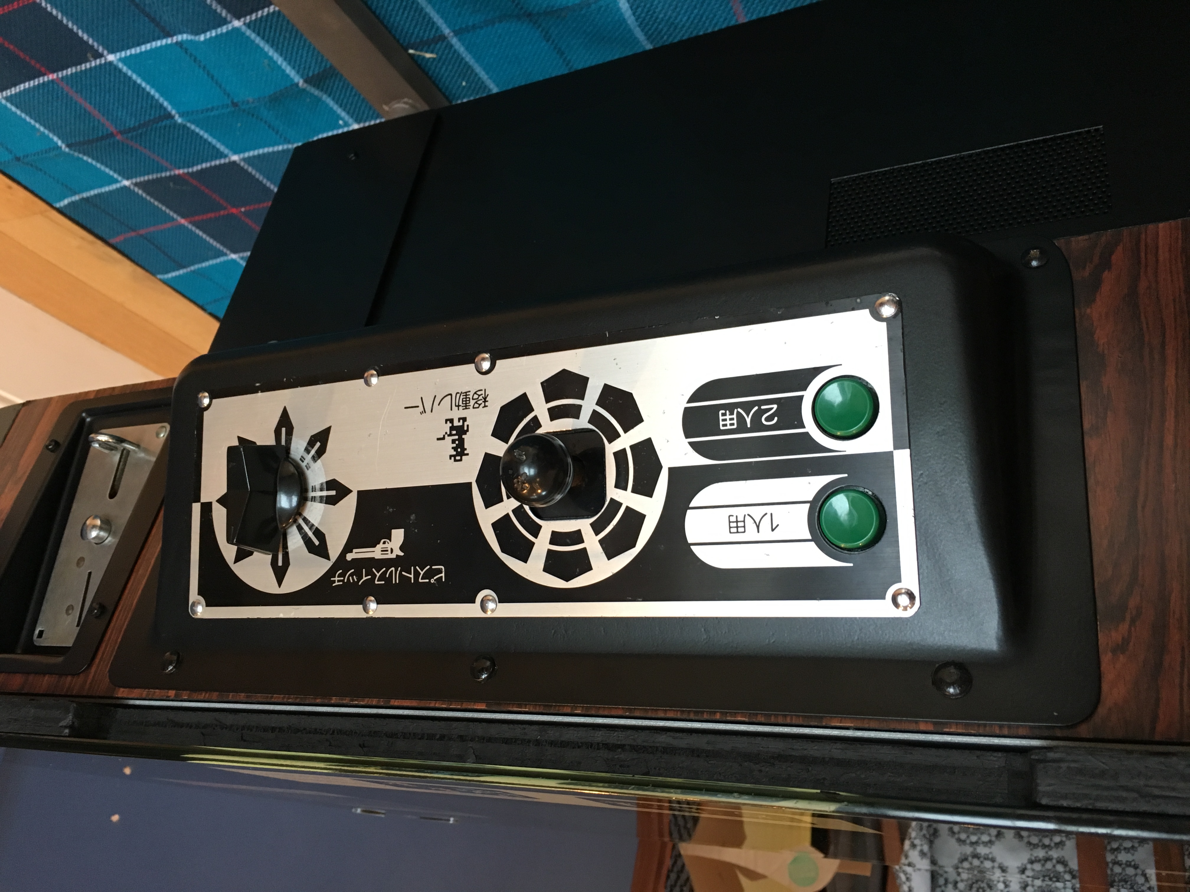

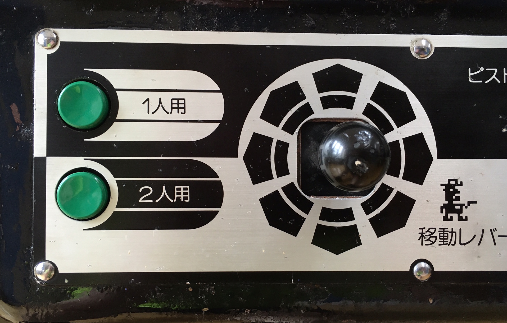

Got two of the green buttons through this morn (the only colour they had) and they are a perfect fit!
I do suspect the originals were probably white but these look a LOT better than no buttons!

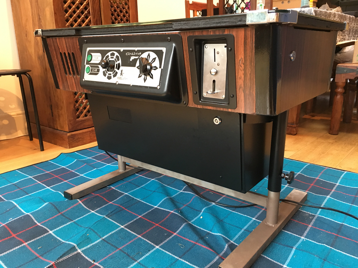

Quick update... still have to pick a time to dismantle the cab and get the shot blasting and powder coating done on the main body and legs but I now have the corner clips rechromed and along with the buttons I added I think it makes a big difference to the overall look.
Thanks to Alex Chuckie Egg for sorting out getting these done.

virtvic said:
I would have said the original bnuttons would have been red, like the fire buttons on Space Fever.
Might have been... or white if Taito did make it as Space Invaders had white for 1 and 2 player select.
Green was the only colour NOS Nintendo ones I could source. Would be good to try out red and white and see the difference.

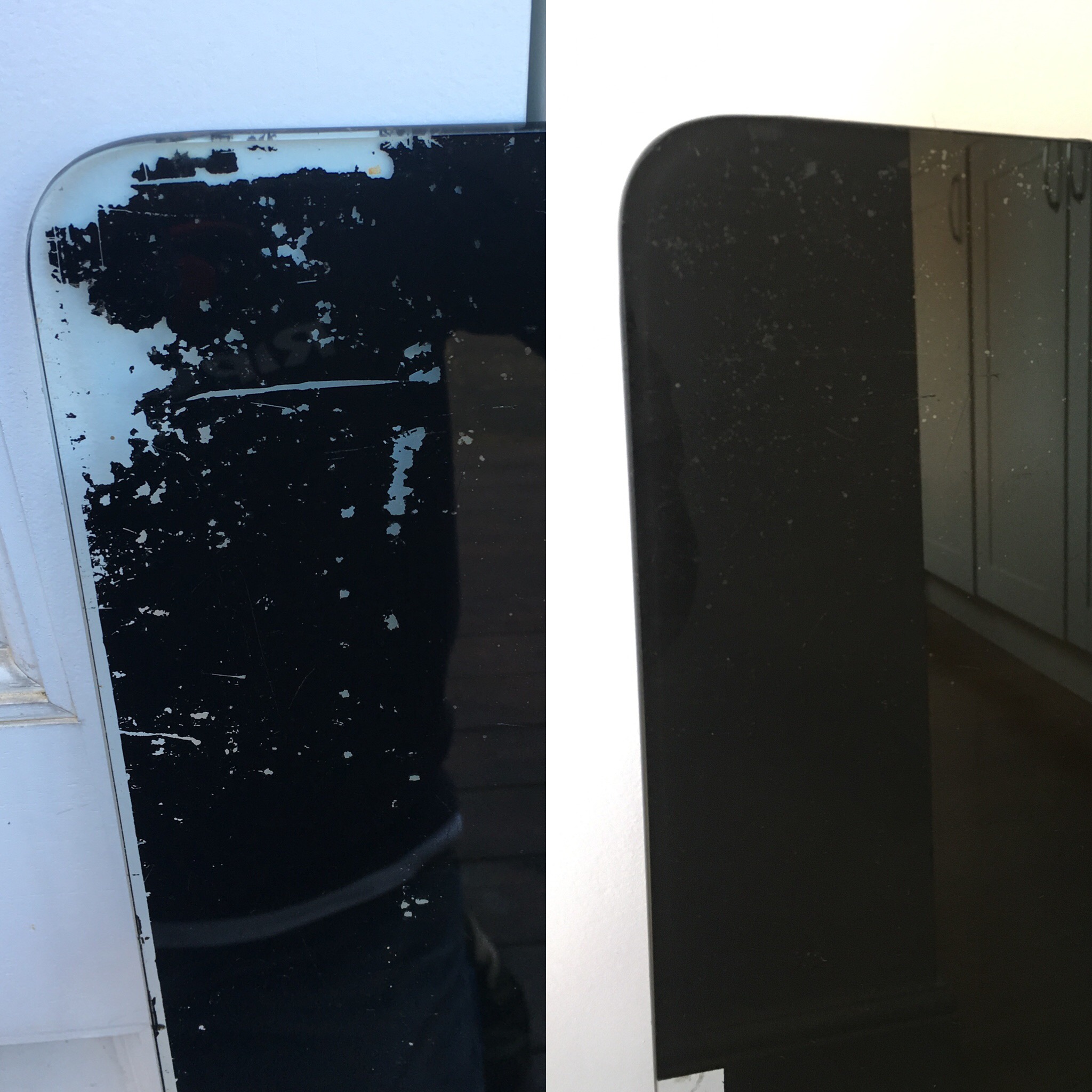

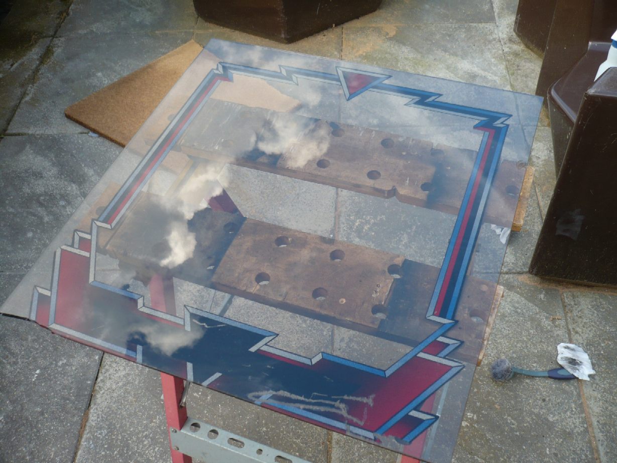

I did this to some Electrocoin Glass, just some of the cheap spray paint Aldi have, Gloss Black, removed all the original stuff and sprayed it on back and it turned out like this, wether you can buy proper stuff I don't know, but it worked
That looks great Bods. I did do a section with acrylic paint but it took ages and didn't work that well. I think masking and spraying the corner areas (at least) I will try out.
4,666CR
I was surprised that worked to be honest, but you couldn't tell it apart from original one after, gloss paint was perfect, only thing I was worried about is how it sticks, I did some laquer on back after and seemed ok
Just googling and see there are people doing it http://www.polyprep.co.uk/glass-spraying/
http://https://www.amazon.co.uk/Kobra-KOB-10072-600ml-Aerosol-Spray/dp/B0048LBTNE
Says this is good on glass and pretty much everything
I just used the aldi stuff because I buy loads of it when they reduce them, but don't use the black gloss for loads of things so thought I'd try it out

I'll be writing up a better blog post or three about the restoration but I've more or less finished the Sheriff restore... the legs will get re-chromed one day but otherwise I'm done...
