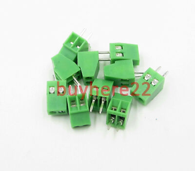

oh yeah , one last thing , did you get the screw terminal from RS too ? if so do you have the part no. please , Thanks
Mr Matt
64CR
Happy to help any time.
I got the mini terminals from eBay.
