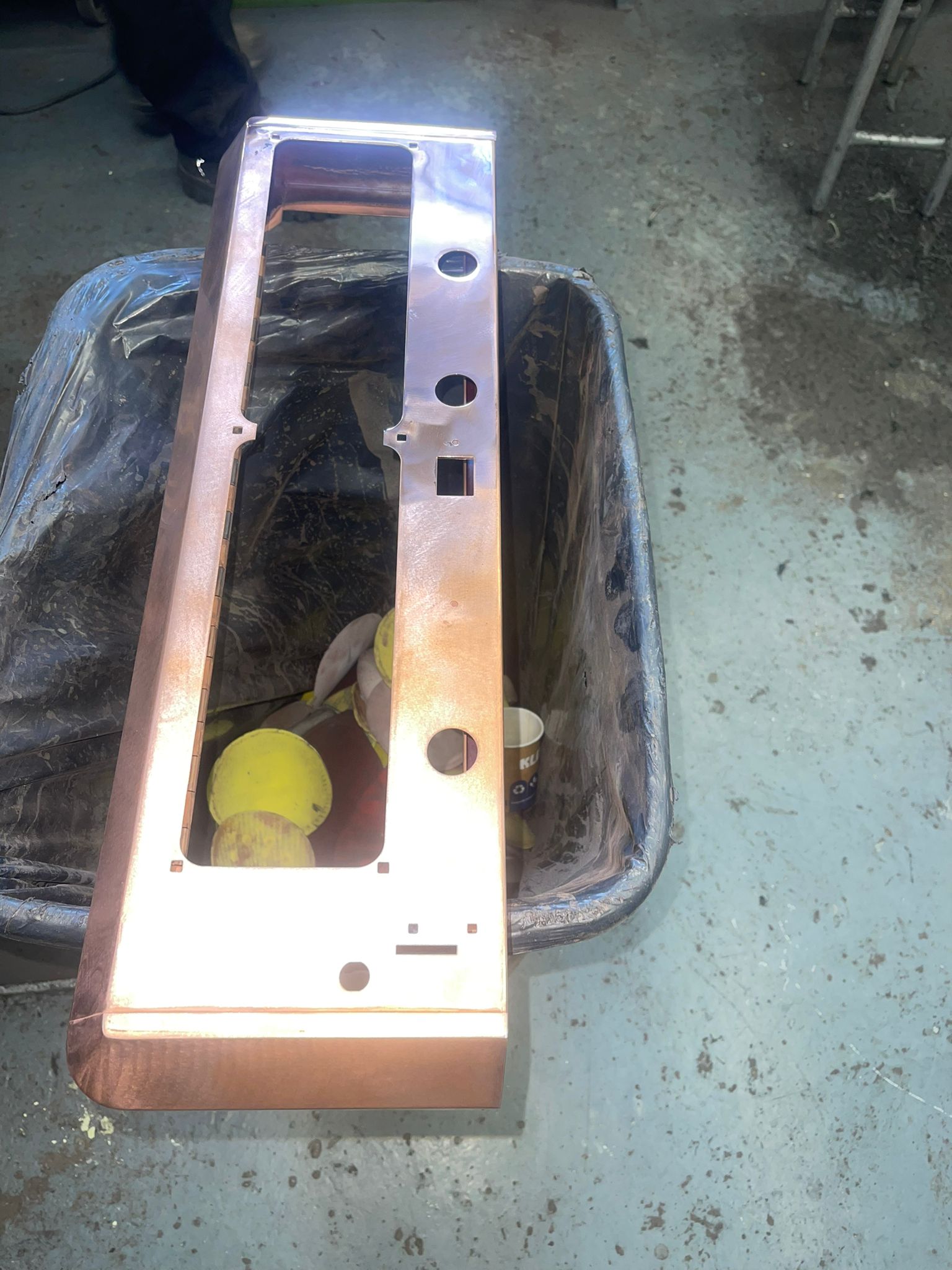

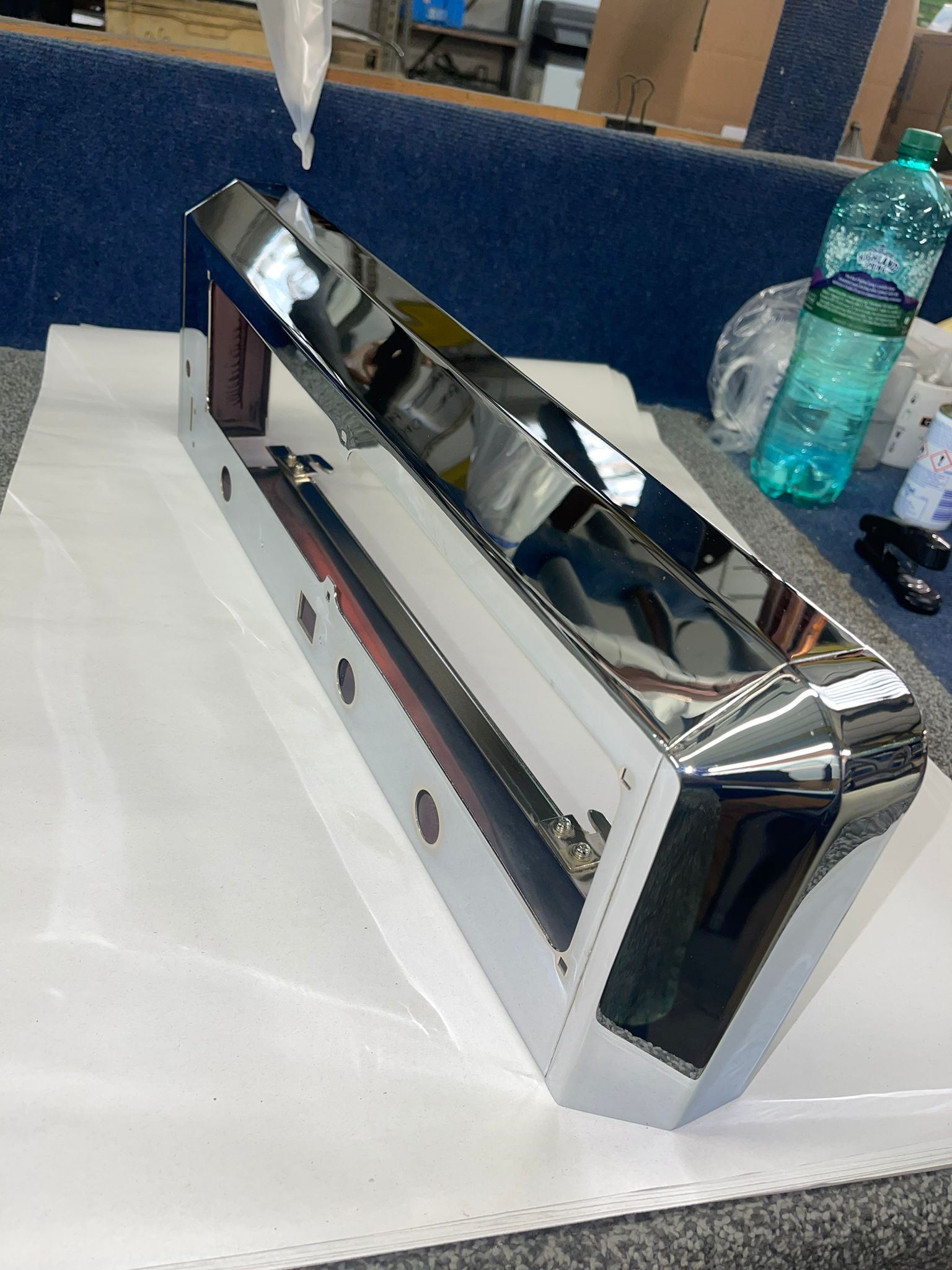

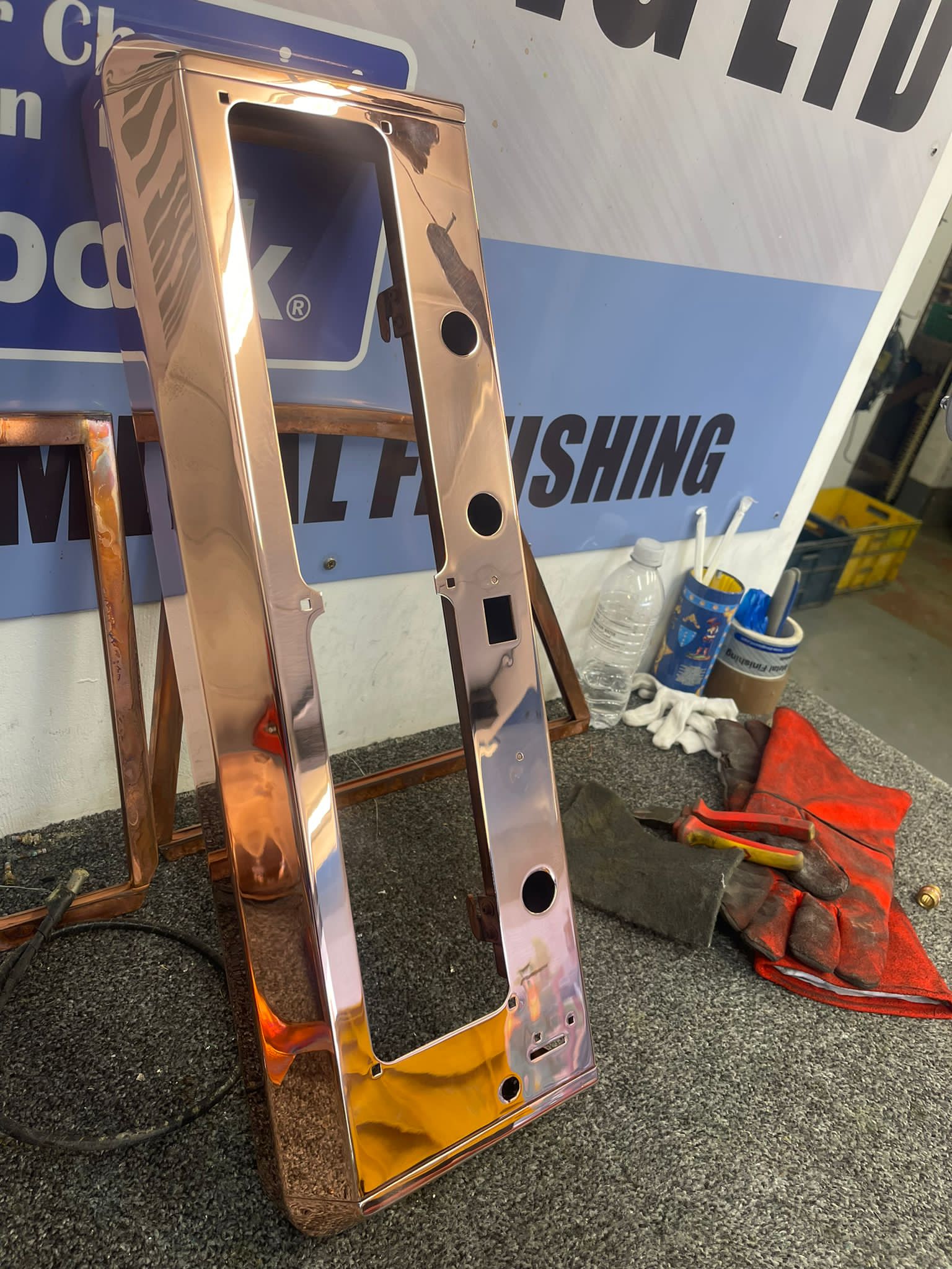

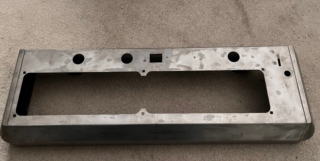

So, the U4 originally had a powder coated CP surround to match the rest of the cab.
For whatever reason, the operator had removed the coin entry and riveted a piece of metal over it, and had repainted the surround white. It hadn’t been done well, was rough to the touch and was generally crappy.
A real shame as the original powdercoating on the rest of the cab is in decent shape considering its age.

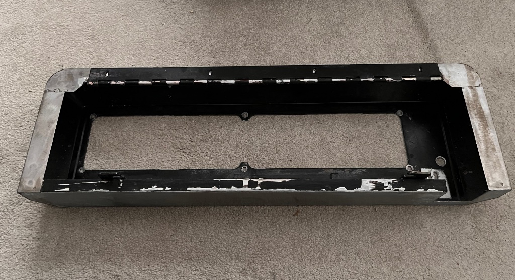

The underside of the CP housing was even worse. It’d been painted with some horrible black stuff and all the components including the hinge and the brackets for the locks had been painted on.
It had to be refinished in any case, and I’d always desperately wanted the chrome (or stainless steel maybe??) CP surround, but I could never find one, or a cab for sale with one.
So my options were:-
1 - Strip it, and paint it white again but properly, or maybe powder coat it. - problem here is that unless I did the whole cab, the new white would be a contrast and likely jarring.
2 - Strip it, and polish it up to look like the stainless CP surround. - problem was that although the white paint stripped off without issue, the black stuff inside was impossible to shift. It also turned out that the metal underneath wasn’t suitable for polishing, nor do I have the skill to do an adequate job in any case.
3 - Strip it, and get it chromed by the bigger boys - problem with this, is that it’s not authentically as the cab was made.
I’m all for authenticity, and faithful, sympathetic restoration but as the CP surround had already been repainted, and needed to be stripped and refinished anyway, I figured I’d opt for the chroming…
Genuinely interested in whether people think this was the wrong move?

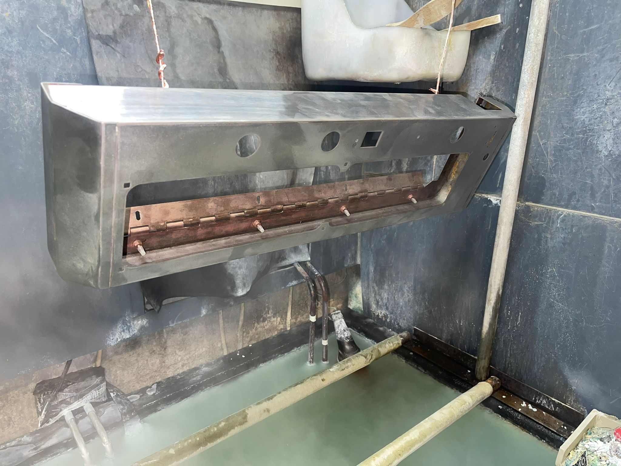

I still haven’t picked it up, but I’ve got photos from the metal finishers this morning…
Phils Arcade
1,465CR
That looks really well done.
Did they have much repair work to do on it? I know when chroming any small indent or score can really show up in the finished work.
ChrisBEANS
730CR
No repair work needed at all, apparently.
When I picked this one up, I showed them the rusty one from a few posts up too, and they reckon that’ll be fine for the same treatment.
I’m surprised, but super happy!!

That looks the absolute business!!! Wow very impressed!
Can I ask what the process is called you had done?
As I have a U4, and might perform a conversion if I can find a company locally offering this type of work.
ChrisBEANS
730CR
It’s simply chroming, and can also be called nickel plating I think.
Just Google local metal finishers, and then obviously triple check their reviews to find the best.
I’m really happy with it, can’t recommend it enough!
