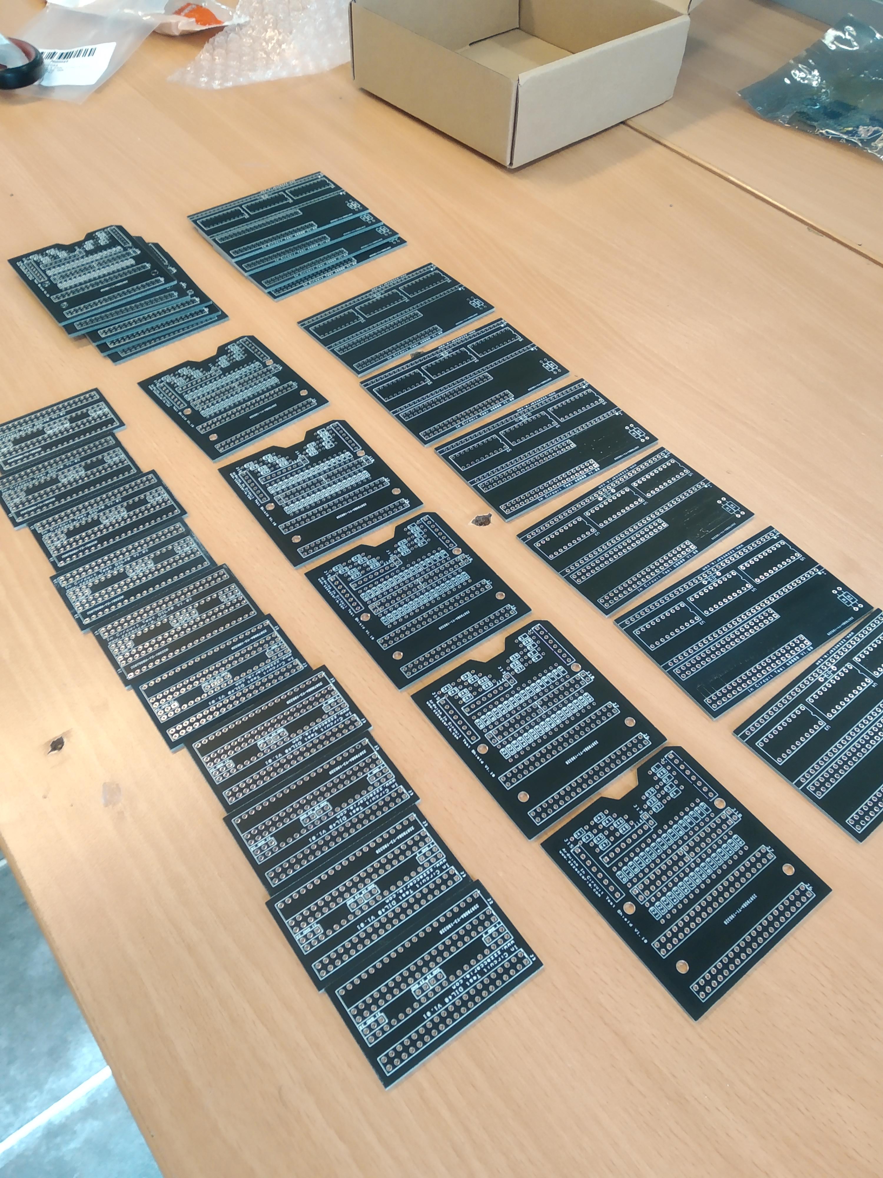

Right - I got made 10 of each Arduino Shield, Standard Header, 68000 Header in rather cool Black
PM me if you're looking for a set and I am happy to part at cost to those that are
