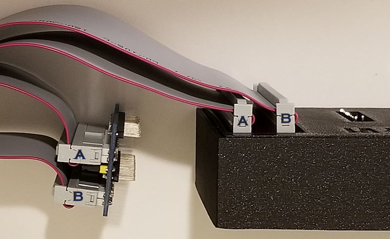

ok, I need to verify that I have my cables attached correctly.
Can someone please take a look at let me know if I'm good to go?
Thanks!
Arcadenut2019-06-23 06:12:09
Judder
992CR
I think that's correct from a quick look at the picture
Have a look at these pictures to check
http://www.ukvac.com/forum/arduino-incircuit-tester-build-project_topic349525_post934580.html#934580
http://www.ukvac.com/forum/arduino-incircuit-tester-build-project_topic349525_post934622.html#934622
and I nearly forgot that I labelled all the pins and everything else in this post too :)
http://www.ukvac.com/forum/arduino-incircuit-tester-build-project_topic349525_post935957.html#935957
Judder2019-06-23 17:48:29

Arcadenut
314CR
Judder said:
Thanks. That picture has the cables opposite from mine, but should be equivalent. I made the assumption that Pin 1 was the upper left from where you can read the connector label.
Those multi colored cables make it a real PITA to figure out what goes where
Guess we'll find out if it works later today... crossing fingers!
