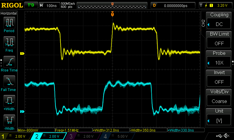

Here are the clock signals with a real 6502A (phi0 input on bottom, phi2 output on top):
Here are the same signals using the ICT:
It really is accurate to about 20ns -- this slight jitter makes phi0 look a little fuzzier with the ICT. It's much tighter than I expected to get, though, and should be more than sufficient.

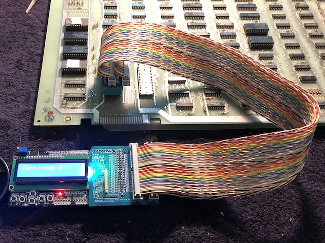

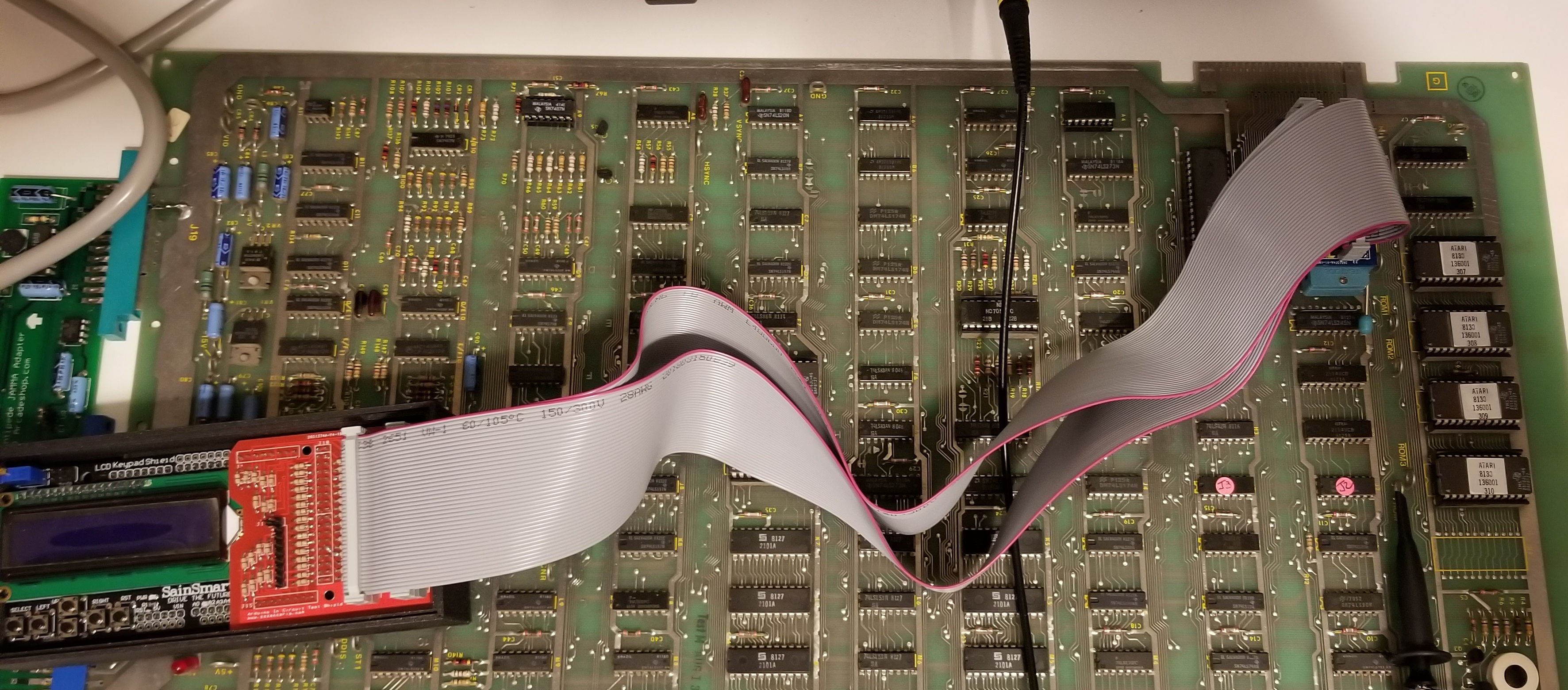

I tried with 2 different shields (one with Resistors and one with 0 Ohm Resistors). I tried with 2 different Adapters. Now I assembled all of them so if I screwed something up on one, it's possible I did it to multiple ones.
Ok, so here is the 40 DIL Adapter jumpered:
and here is the tester hooked up to the PCB

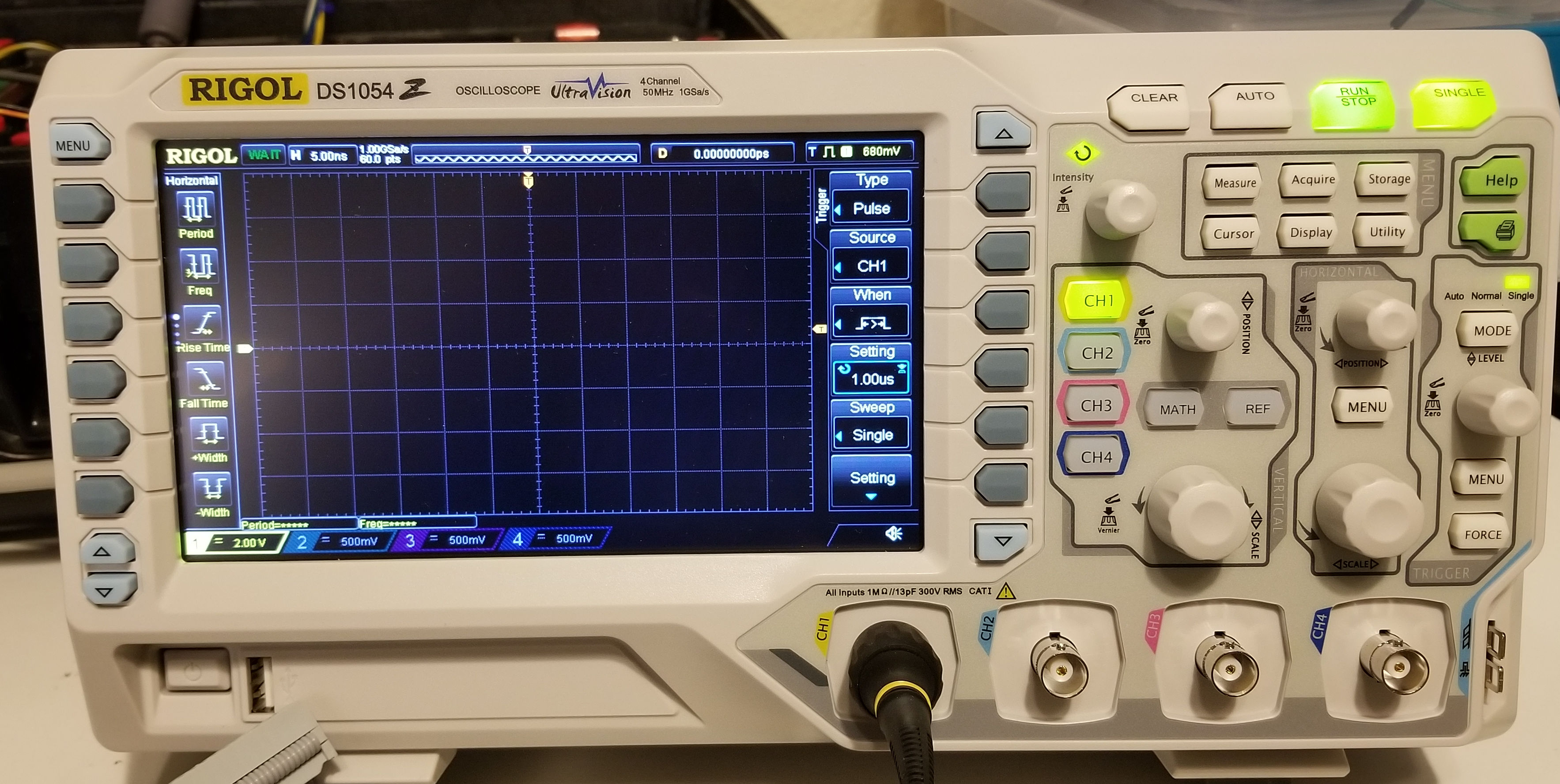

Here I have my scope hooked up to wait for an access to ANY ROM...
and here is how I have my scope setup:
2v/div
Single Step
Trigger on Pulse
Tigger level is slightly above 0.
I can read and write to anything below 8192 (0x2000) just fine. It's everything from that and above that isn't working. So A13 seems to be the issue.
I assume that if I had the ribbon cables hooked up wrong, or the jumpers on the board wrong I wouldn't be able to read/write to anything.
