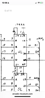

Cheers for that will take a look & the 2128 Could be these
74ls174’s handle rgb also right next to the rgbs header ..
Iv orderd new for these also .
good score to pull pcbs from ops waste store back in the day 👍

The end with the cutout/dimple is the end with pin1/pin14. They are compatible.
Thanks i Can ignore the small circle then 👍
The two 174’s thst handle the rgb right next to the rgb out put
Have good clocks and i watched the game with logic probe on some address lines and thst had good oscilación corospondimg with game changes ..
But i guess they could still have 1 fault and the rgb could be screwy like it is ..
I’m going to try Piggy backing them with new.
