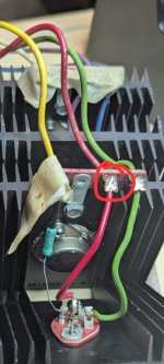

Time to check monitor transistors, @CoS72 came over to help and we got to work.
@Syrup2407 kindly shared some cheat sheet testing for testing transistors with a DMM. We knew that only one side of the transistors were the issue due to the screen collapse on the right hand side.
We immediately saw a clear issue with two of the four transistors confirming suspicions that this is where the issue was.
5,522CR
Using this diagram we started to test each transistor.
This universal testing device is absolute magic.
What became immediately obvious though was a broken wire between transistor 1 and 2. Could it be that simple?
The wire was stripped and retinned and soldered back.
