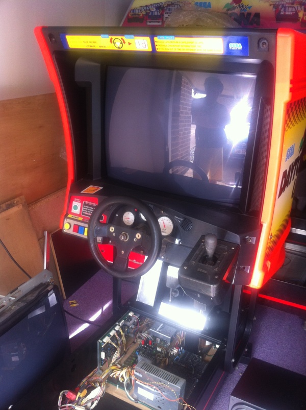

Progress is speeding along now

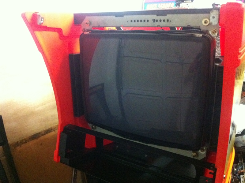

Monitor in

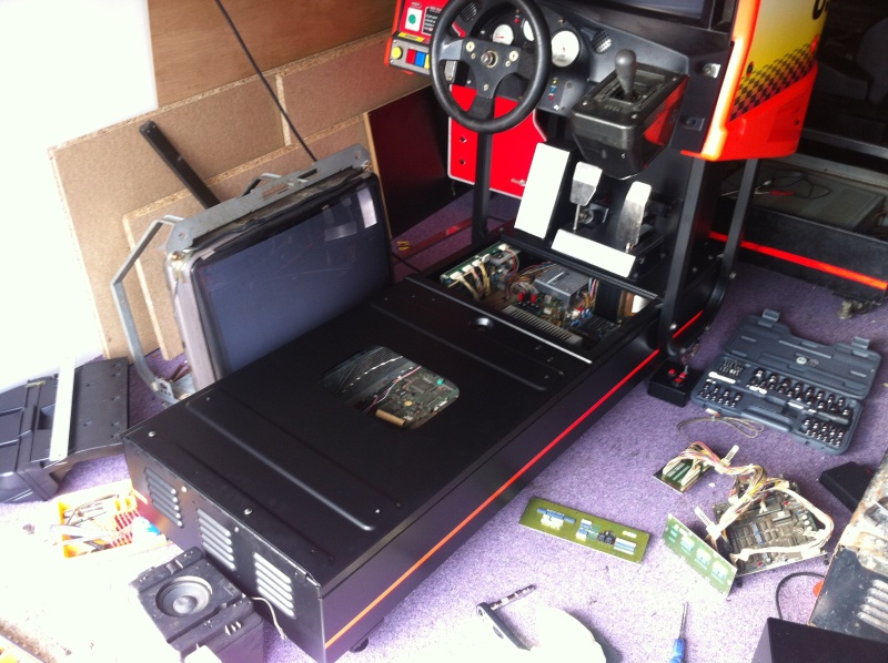

Finished replacing all the knackard sound boards and threw in a PCB set

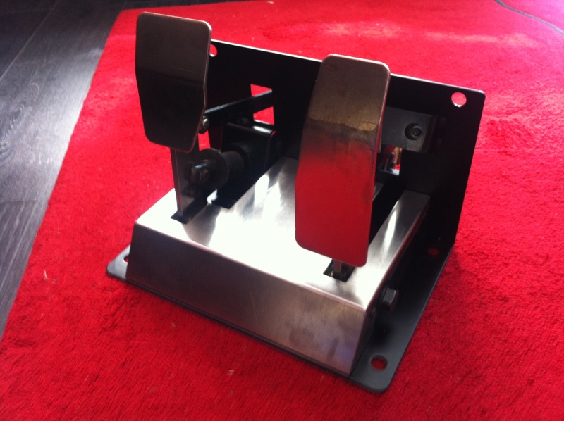

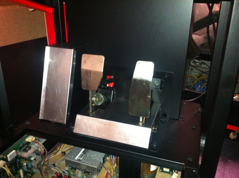

Stripped & re-built Pedals

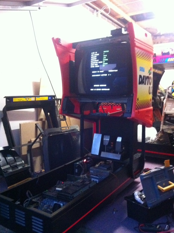

Installed in cab along with back plate
So at this point I thought I would see what happended when I turned it on.
RESULT !!
So on with some more re-building

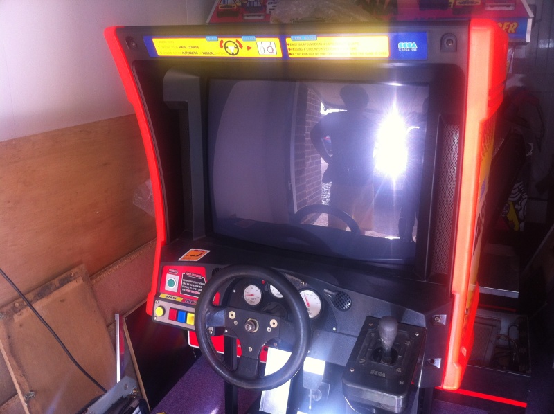

monitor bezel cleaned and polished up
& Control Panel added, still need to clean up the Shifter & Wheel
Added base top, realised I needed some new bolts & screws to do it properly so only a few crap ones added until my order arrives.
At this point I dragged in all the parts to re-build the seat, unfortunatly it appears the powder coaters snapped one of the support plates and welded on 2 massive steel plates to support it so now the bolts arent quite long enough, In their defense they have done a cracking job of the repair so I didnt notice, but I did spend an hour trying to work out what was wrong.. luckily with some longer bolts it should all still fit together.
Once I knew I could power up the boards ok, I tested the 2 sets that came with the cab and as expected (even though there were meant to have been repaired by sega) they are TOAST
so these have been added to the 12 faulty daytona sets I already have.
