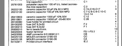

i replace the fuse holder as well when you see this sort of corrosion but for testing purposes you can get away with both if you clean them, bit of wire wool will do the job
Will do that then for now.
Ta…
Then put a clean holder in ..
I will order both types
And check if
I have that type
2A
And 3A
tb2000
3,447CR
I'm sure I cleaned all that off it before I sent it. Whatever the case, it was definitely working fine. You could gently clean the fuse ends with a fibreglass pen or bit of fine sandpaper etc. If you want to replace the fuse, it might be worth also gently bending in the contacts of the fuse holder toward each other a bit to make sure of a good contact.
will do that thanks ..
( my fault keeping it in box for this long )
