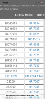

The HR7188 lopt you've got won't work in a 25"/28" Polo as the pinout is quite different to an HR7191. That said, it isn't impossible, the lopt would need strapping up to something near to the lopt solder point holes in the chassis and the legs would need adapting with wires to direct them into the correct holes. With the HV it gives out though, it'd probably be more suited to a 20" chassis like a MTC9000 perhaps, I think it's missing an output for the 200v line to work properly on a Polo. Best person to ask about something like that is member M K L.
Thanks for the heads up! I've checked the HR7188 and the Fidelity ZX3000 schematics and this is yet another flyback that could be adapted for most Hantarex 20" chassis (MTC900E through to Polo/3). It has everything that's needed (video B+ is on pin 7 btw).
When you say adapted ..
Do you mean
Jumper wires for pins that are not in correct position for a chassis. As mentioned above ?
