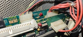

RenegadeR
56CR
It is quite simple so it only needs 5V and ground.
The video connector you can see the colors are quite logically done.
I took a picture on how it is connected.
On my board the 5v and ground are done in a hacky way, so they soldered the ground wire on the top of each board and the 5v on the back of each board.
Although it does work I dont even need to plug in those 2 power connectors to make the game run.
8lall0
2CR
That's so precious, thank you!

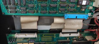

Do you have a pic on how to connect the pcbs with the ribbons?
RenegadeR
56CR
I took some extra pictures for you.
The first picture I disconnected the cable that goes to the controls.
On the second picture you see a more wider view.

good thing about the bootleg is it uses standard connectors :)
one warning about these type of sega games,
the inputs wont work unless you supply 5v and ground to the input connector - the inputs are optically isolated for some reason.
