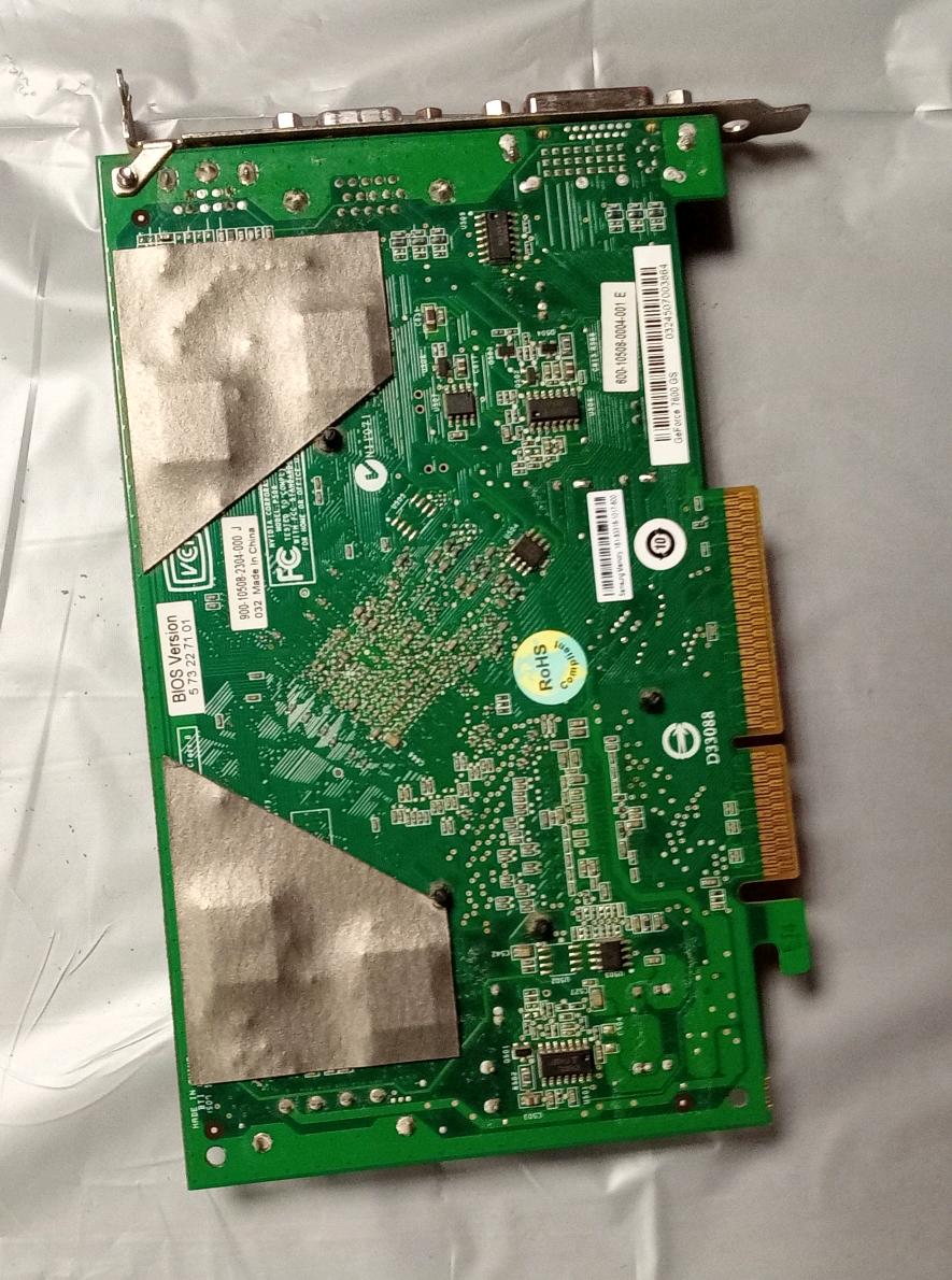

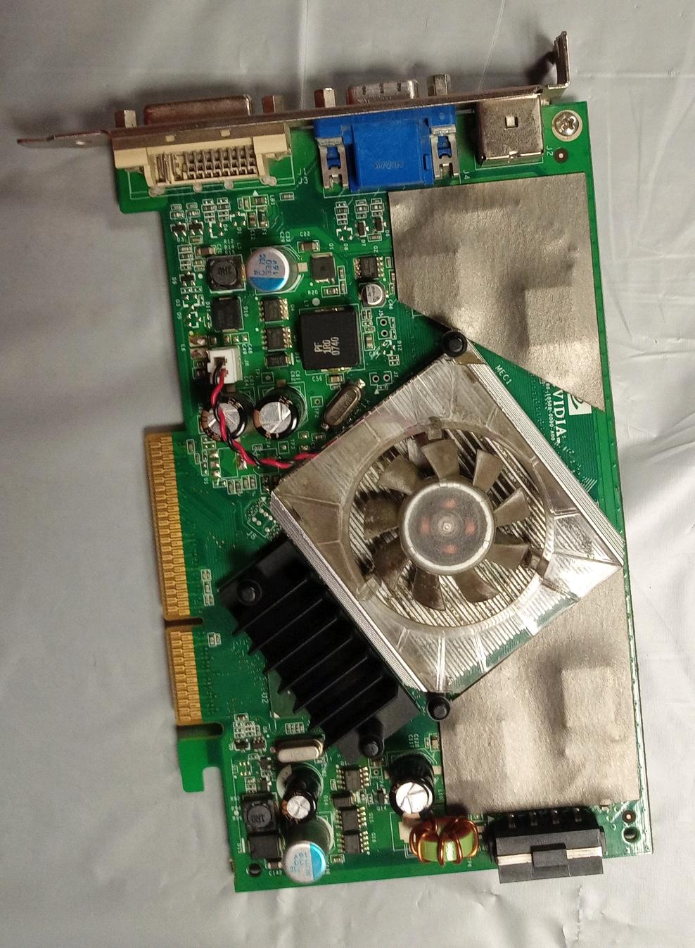

Cheers, I'll have a chat with him. We've seen the Nvidia 7600's graphics card for £20-£30 on eBay but we're assuming that the bios on it had to match the one he's got in the machine for it to work. Like I said knowing very little about these PC based games means I don't even know if it's possible to put a bios onto one of those lol. I could post a photo of his graphics card if that's of any use, it's got all the info on it.bones2022-08-25 19:13:57
bones
1,628CR
This is what he's got.
bones
1,628CR
Sounds good, no idea how to flash a BIOS lol. Best I let you have this thread back, I'll PM you tomorrow after I've spoke with my mate and investigated this BIOS flashing thing, thanks.
