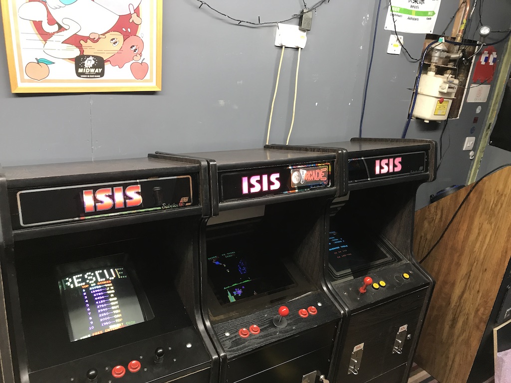

Not Dinosaur related at all, but here is the Caliphate so far...
I may need to start my own Isis club, but it may need a disclaimer...

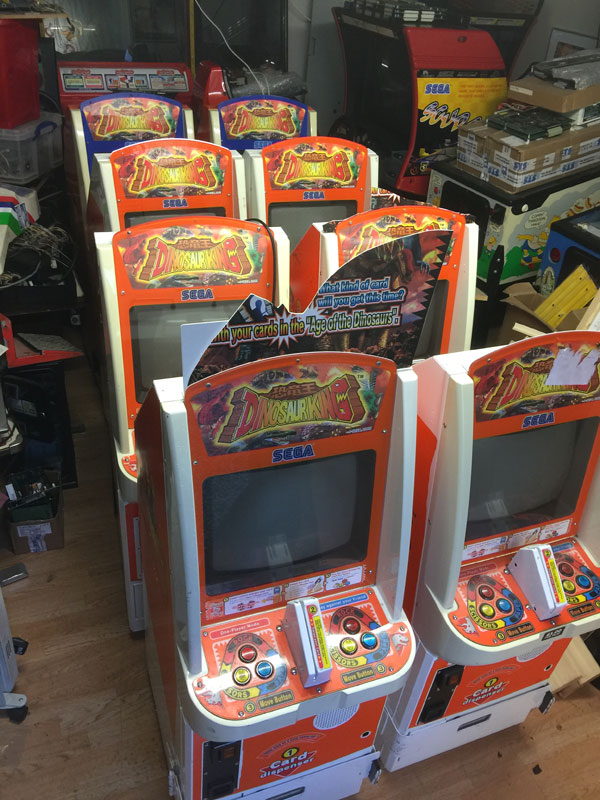

This was a full Aero set I did for one with front door art too that went to a guy in France.
and the lot I picked up earlier in the year - I kept 2 of these the rest went to forum members :)

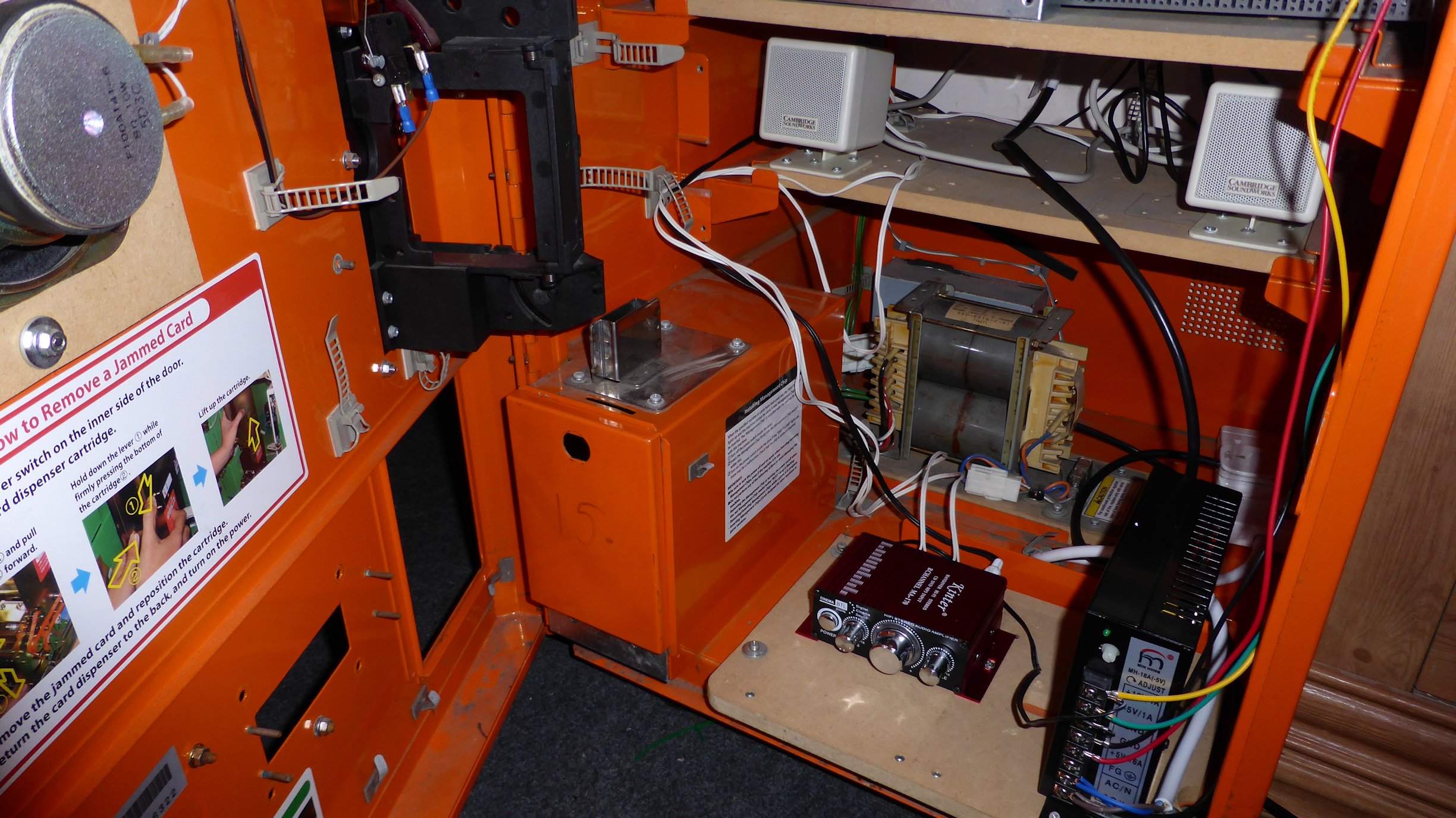

Cut the Control Panel out myself, just the usual tools. Jigsaw, drill, hole punch was hopeless on 2mm steel despite the paperwork with the Q-Max stating it can do 3mm steel! so had to use the hammered step drills the damn Stainless Steel panels I fitted on 2 Goliaths
Decided after much wasted time the best place for speakers is under control panel, with mame setup you might as well have stereo sound, so smaller speakers and subwoofer inside the door
Control Panel nice and tidy, with trackball and 10 buttons it gets messy
Gigabyte PC board, my fav make, so stable and reliable like Honda Cars
It's X2 II 270 CPU 3.4g so not too bad. Try to use the orginal cables in the cabs as much as possible and just added Jamma loom so it can play original pcb's if and when

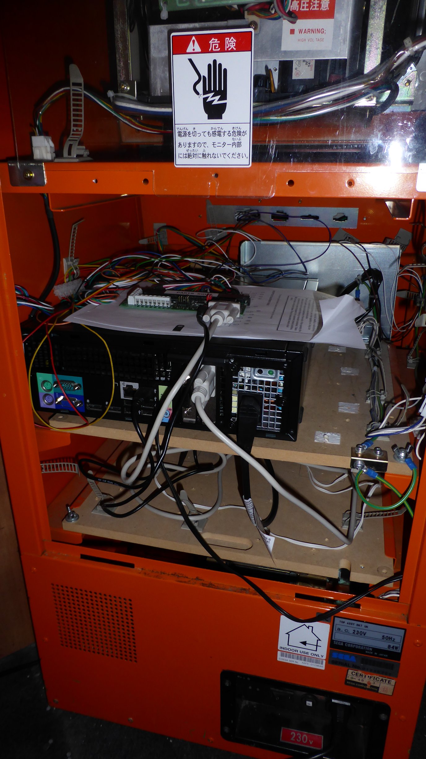

Not done too much with mine externally..A superbly made control panel made by Vic, with Sanwa parts added to it, the Perspex is due to be replaced soon when my new one from Flynn reaches Olly, and I see whats available to be printed.
Internally, its Jamma loomed, and is running a 3Ghz (or something like that) Intel i5 PC pushing a very complete Groovymame setup off an SSD drive to the existing monitor via a JPAC. it is powerful enough to play the chd games like NFL Blitz at 100%. Gameex is the front end, It will boot from powerup to game in about 15 seconds.

I'm going to take my one and only opportunity to troll the Trollnads and say 'tidy wiring job!'
Seriously though, great to see more pics of people's cabs - keep em coming!
