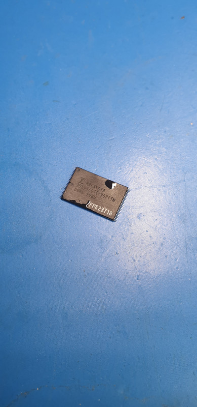

Alright then, I thought I update this post in case someone else has the same problem. So a new Fujitsu 29LV160TE arrived in the post.

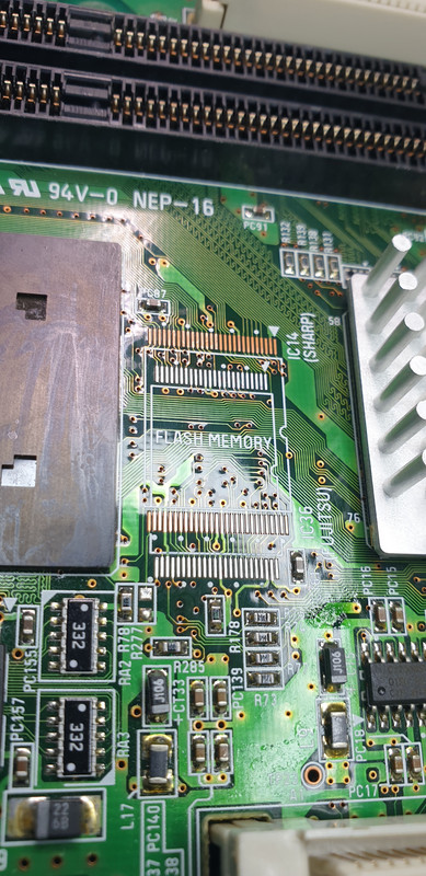

Removed the old Fujitsu flash memory...
And then stuck on the new one...
Tried it with fingers crossed... and got an ERROR 22: COMMUNICATION ERROR OCCURRED BETWEEN MAIN BOARD AND OPTION BOARD

Whilst doing this I thought I put the old Fujitsu Flash memory back so I don't end up losing it and also because I realized that there was probably nothing wrong with it in the first place. So back it went on.
Forgot to take photos of it going back on but hey it was supposed to go in the bin pile.

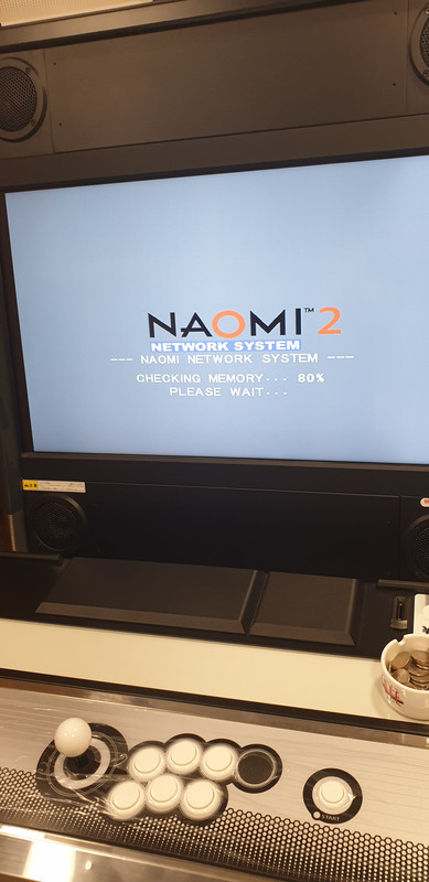

I went to test the new one to see if it worked which it did. Then for laughs and giggles, I thought I give the old one, one last try just to see if I had stuck the old Fujitsu on properly and to my amazement when I went to set the IP address....
It got stored!!!
Hmmmm it was the bloody zero PIC that got corrupted somehow.

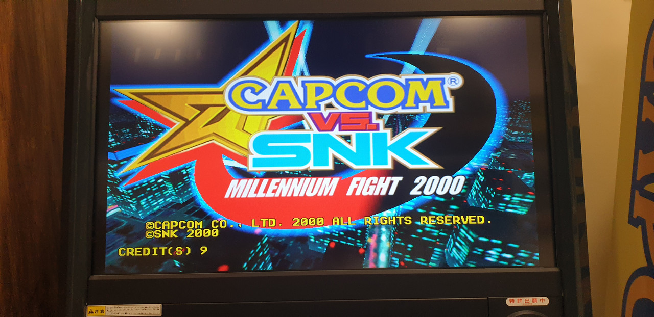

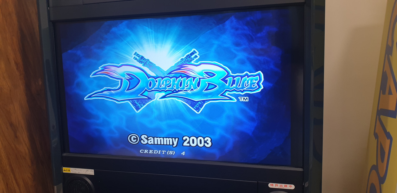

Went to load a game and....
Looks like it's happening....
Voila, baby!

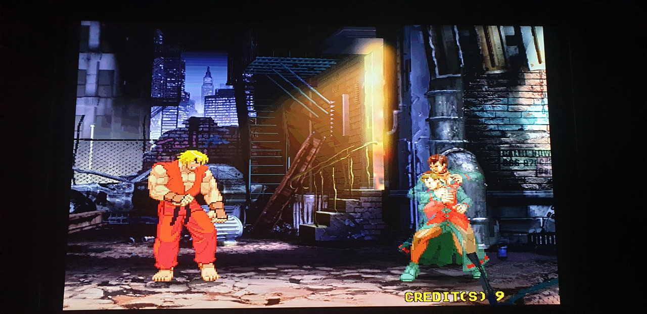

Thought I play some non-sega games just to piss off any sega employees that might be reading this lengthy, and slightly deviating repair log.
After 1cc this game on my first try ever...

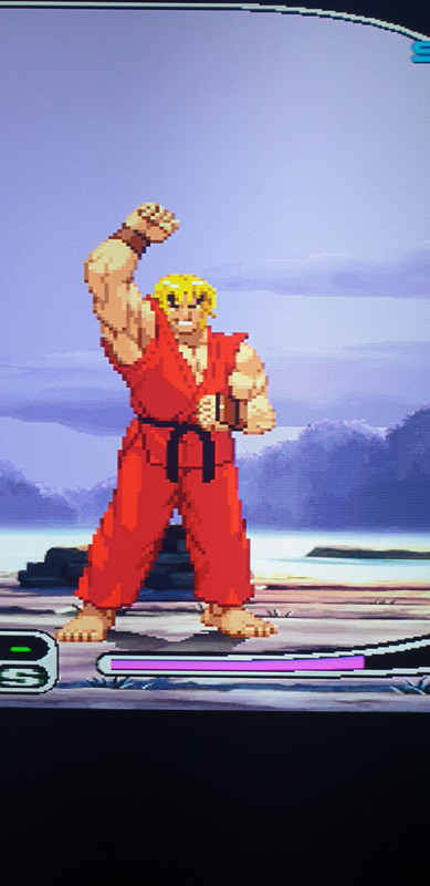

I thought I let Ken sum up my day with this emote.
