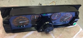

Dashboard repaired, painted and ready for installation.
As is normal over the years, operators love to hack up something to keep them going.
No idea why they did this to the shifter, but it was an original DLX shifter at least.

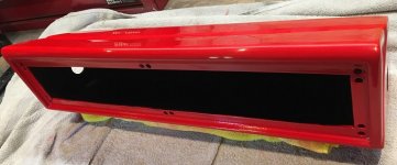

Fully Repainted and ready for fitting back on the frame.
