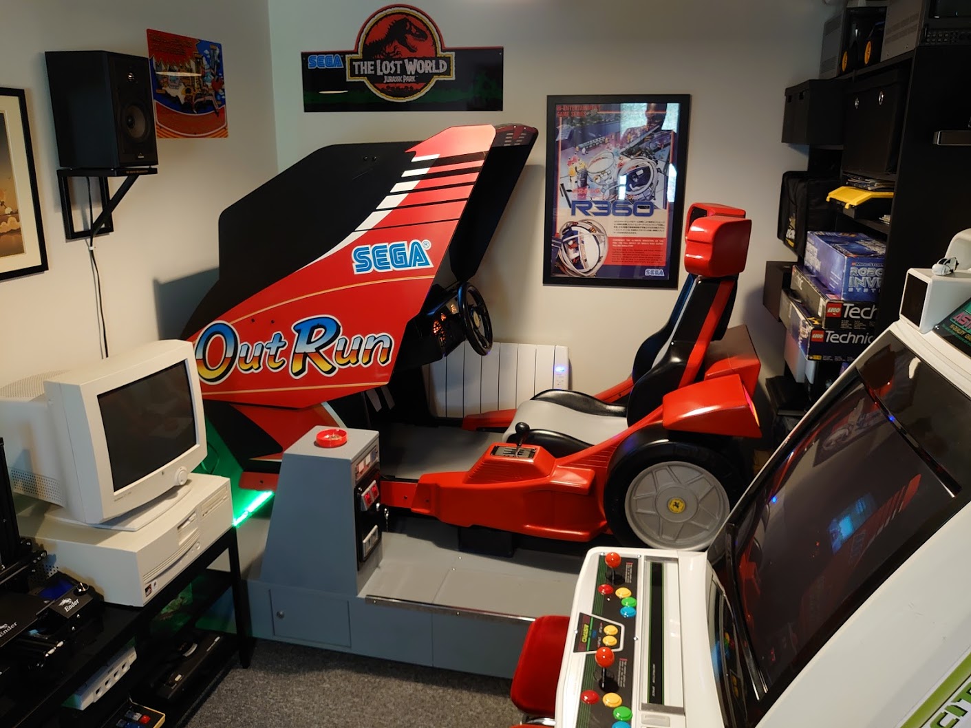

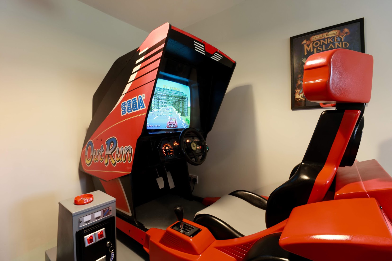

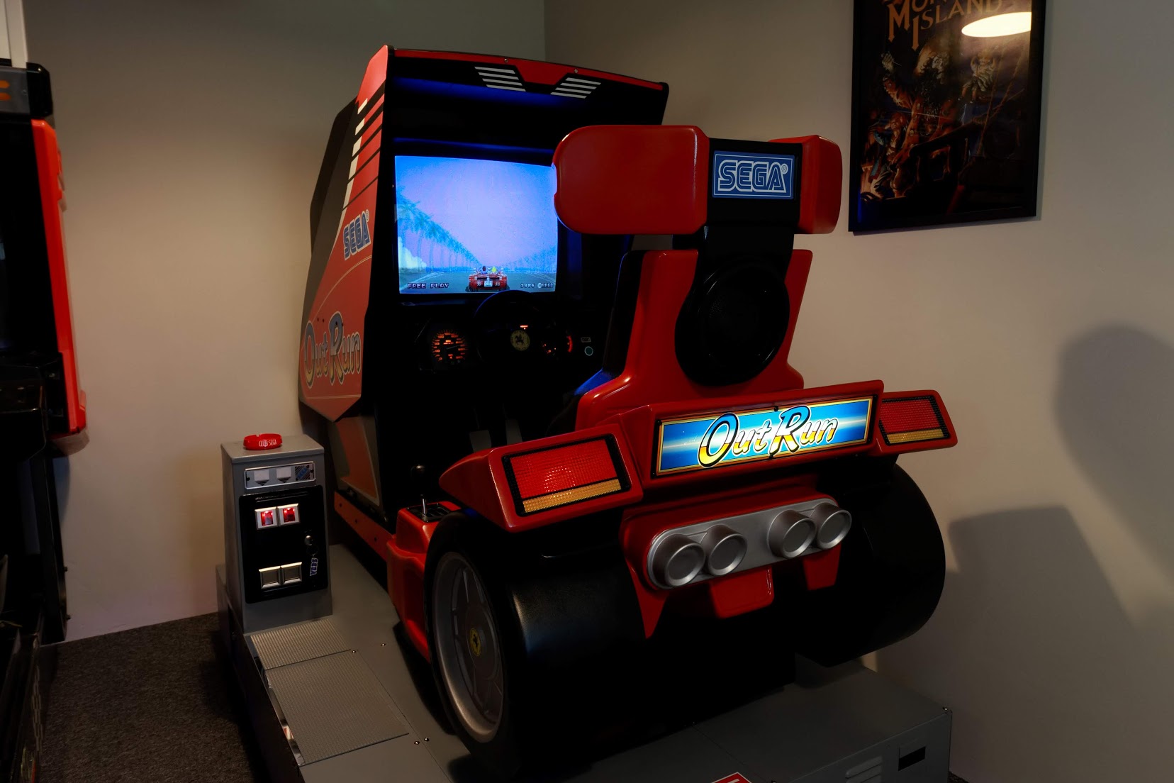

Howdy all. Yes she has been getting plenty of use over the last
year. I have done a few more bits in that time and had a move around in
the office to better make use of space.
I have two young sons and it's been one of several things to keep them busy in lockdown. The youngest has gotten pretty good.

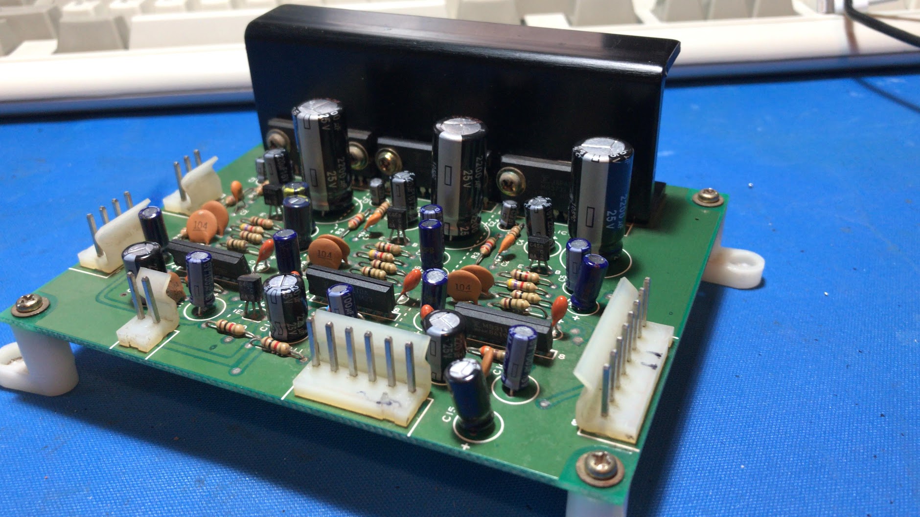

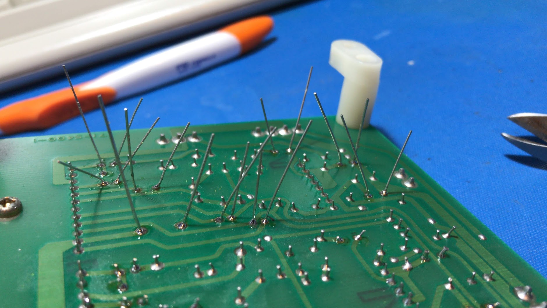

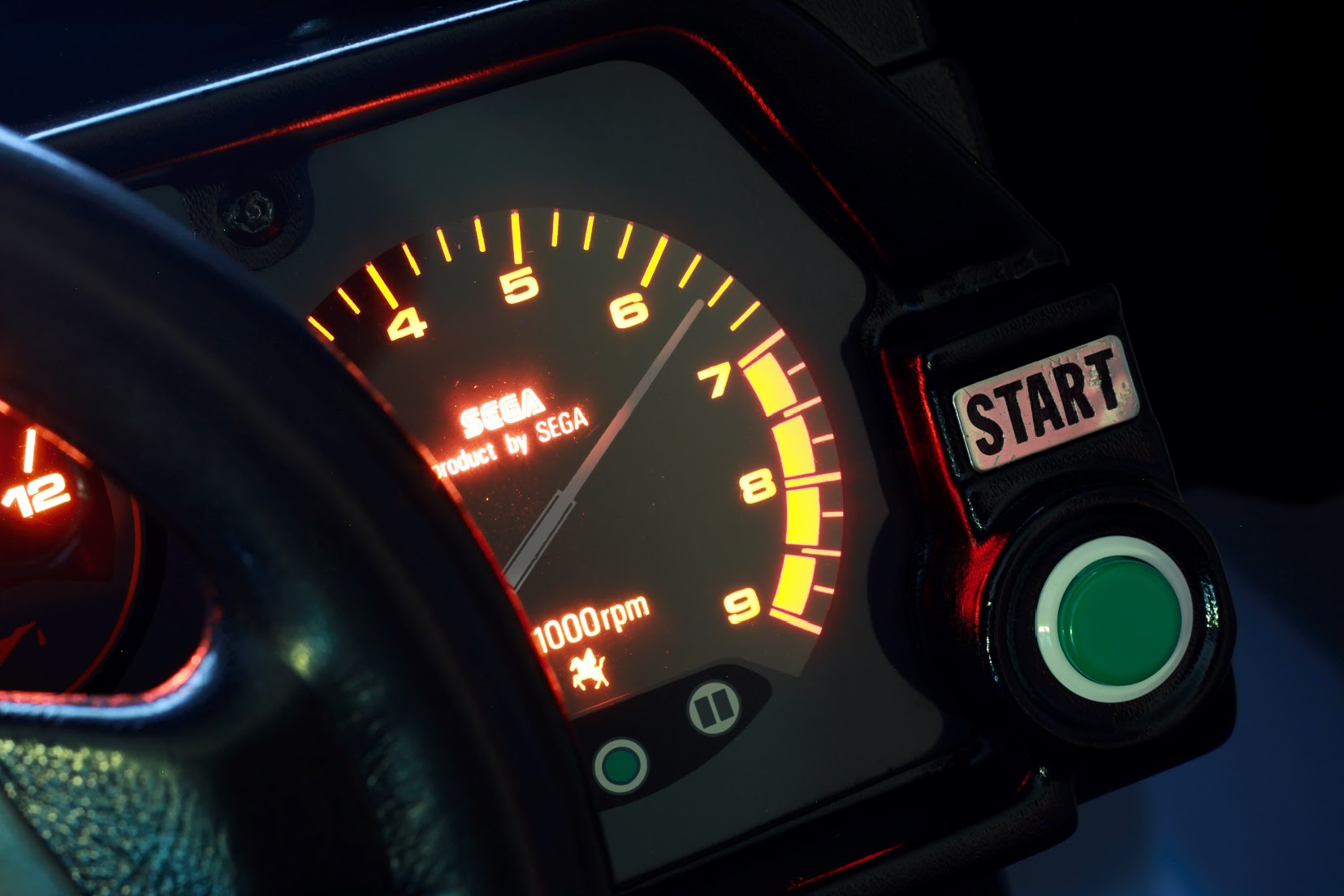

I recapped the amp, I had another cap on it fail to a dead short so I decided to recap the lot.
A few people pointed out in a video of the cab that the brake lights were not working as they should, traced the issue to the relay used. It was pretty gross inside, a good clean out with deoxit sorted it.

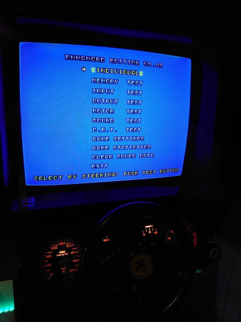

Installed the latest Outrun Enhanced 2.02 roms (amazing stuff).

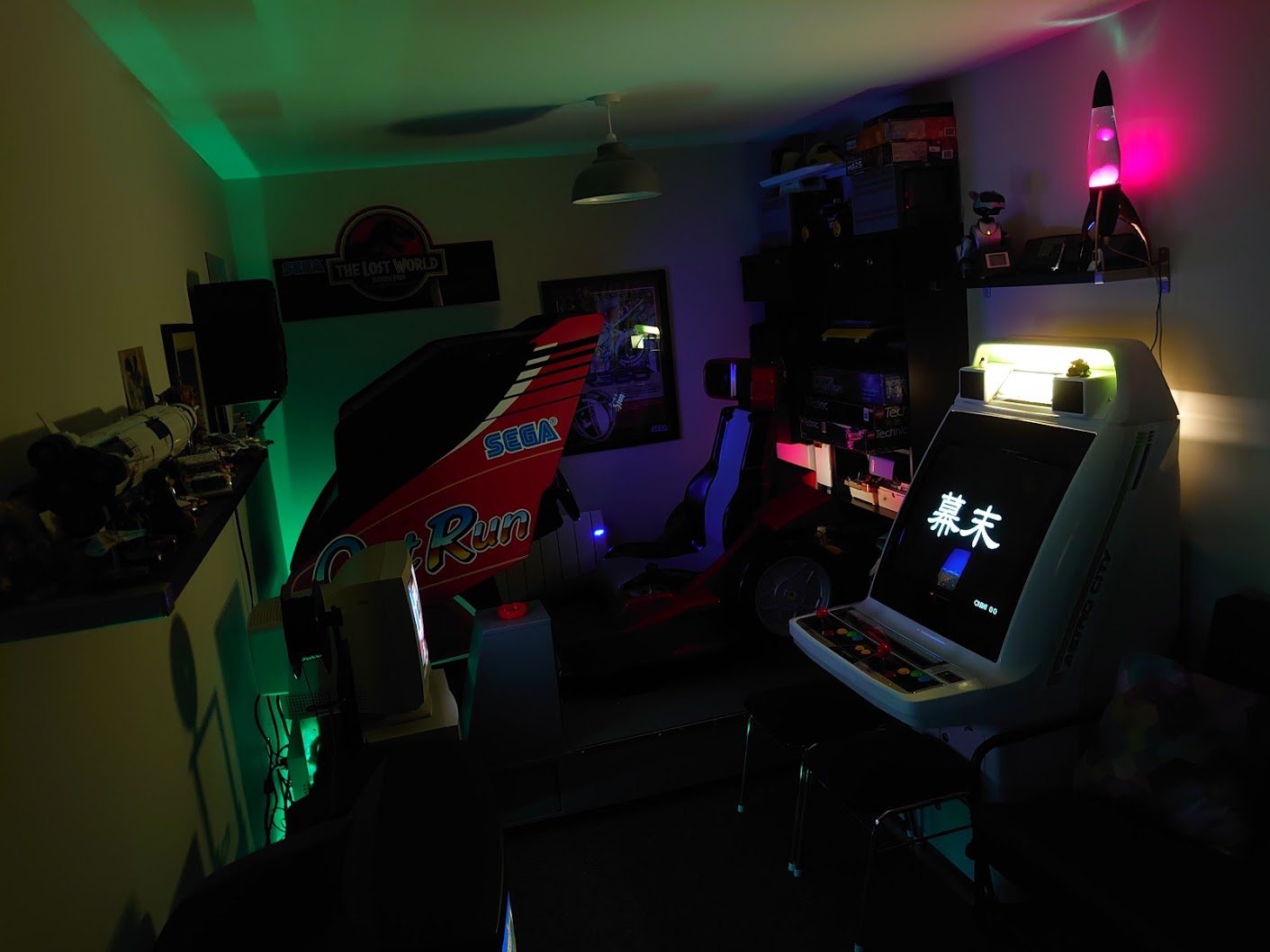

Once work on Outrun was done I was able to move it to it's final spot I intended for it in my office and decorate / finish the room around it.
Few bonus pics of the room.

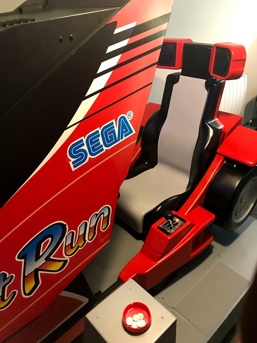

Next steps for Outrun, I would like to make a coin chite as it's missing and I would like to replace the plexiglass screen cover possibly with a safety glass one painted to match the bezel of this one.
