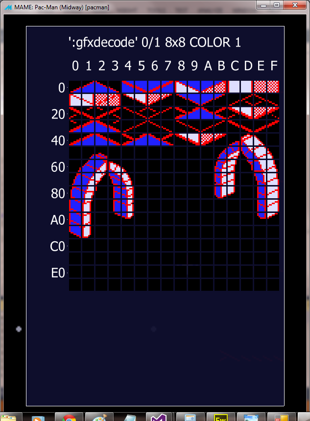

Little way from getting some working code to show you (I know how I'm gonna do this - but haven't worked out the finer data structures required or implementation specifics yet), but here's a tease of what I'm attempting to get this hardware to do.
Hurray Banana
2,725CR
joe34 said:
Hurray Banana said:
... here's a tease of what I'm attempting to get this hardware to do.
omg, ... knight lore?
Well the two arch ways are from Knight Lore, it's just gonna be a demo, not possible to do re-draw in-front objects with this hardware, could do it easy if you had a foreground tilemap (drawn after the sprite layer) as well as a background tilemap.
I think If I watched Adrian's L system demo correctly that hardware does have a tilemap that renders in front of one of the sprite layers, so that would be a more suitable target for a bit of isometric fun.
What I'm trying to do is see what you can do by using data illusions and tricksy use of the 6 sprites. available.
