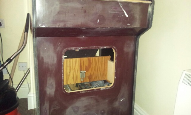

Thanks, I'm only painting the front of the cab...the side art is in great condition. I will try and make the best job of it I can. Here's a photo of the area that's to be painted.

Just to add to Pacman83's words - wet sanding is your friend. I personally do a primer coat, wet sand with 320 grit, another primer coat, wet sand with 600 grit. Then I do the same process with the paint.
Depends on what finish you're after really, the more coats/sanding you do, the smoother the finish. Obviously the flatter the surface you start with, the better!
