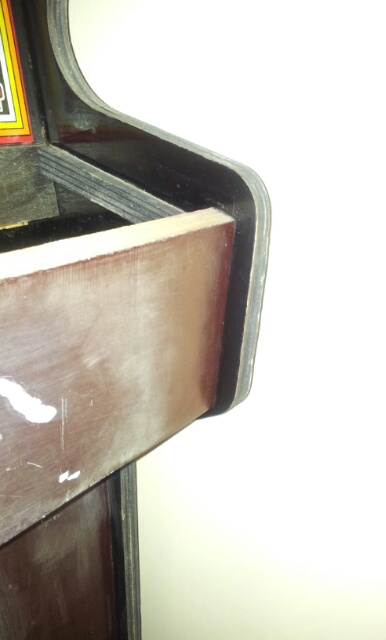

I need to ask a couple more things, please. The painting has been delayed due to relocating but, I'll have a few weeks before I start my new job to get things moving. The questions....should I place the cab on it's side or back? At the same time I'll be treating and filling some wood on the base. And lastly, what's the best way to tackle the areas that are black where t-mold runs around? Should I give them a new coat of paint or leave them as they are? I'm a bit concerned paint merging where I do the sides and front. Perhaps do the sides first or use some blue painter's tape to stop it from spreading?
Thanks
