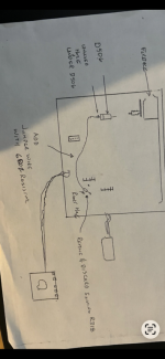

Ok ..
The plot thickens
Now with ricks digram
Gives me a good idea where the d506 lives ..
It’s unpopulated ?
Along with 2x resistor or jumper and a resistor missing in circuit ?
M K L

no, the voltage from the flyback is what you are replacing, d506 is on an output of the power supply section transfomer
from what i can work out you replace r318 with 680 ohm and solder one side to the ic side of the original track/pad and leave the other end out of chassis, solder a wire to this leg and run wire to cathode of d506 or do the same by cutting track of r318 and run wire under chassis

But d506 not there ?
Só I need them to look at the transformer 18v out ?
And pick up there ?
