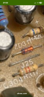

I don’t understand empty hole ?
If I change the resistor at r318
Which I have found
To a 680 ohm as discribed …
Where is my empty hole
To link the new power source from D306 going to be ?

I have new tantlium cap to put in at c318 to see if this helps.
Maybe change r318 to a 680 ohm as he says …
But then the empty hole bit just confused me
I’m not seeing any holes in the zone around r318
Any ideas appreciated thnx

My understandig is that you need to remove that resistor and put an 680Ohm in but only one leg in the hole that leads to the IC. The other end must be linked to D306.
Maybe with full schematics an more experienced user can help better :)

It's possible that the allegedly stable voltage source is the 24V from the power supply rectified by D506 (D306 being a typo?). The voltage at pin 6 of IC2 will be in any case 12V because of ZD311 (a simple zener voltage regulator).

The purpose of the resistor is limiting the current. It's the zener diode that sets the voltage. In this case, ZD311 is 12.2V. We're talking about a simple and common circuit called "zener voltage regulator" that consists of three components. A current limiting resistor in series with the input voltage, a zener diode with cathode to output voltage and anode to ground and a smoothing cap in parallel with the diode. These parts here are R318, ZD311, C316. The value of the resistor depends on the current draw of the load supplied by the circuit (the vertical section of IC2 HA11235). With an input voltage of 18V and a 100 ohm resistor (indicated in the schematics for 26" tubes), the current draw is 50mA. With an input voltage of 24V, the resistor will be 200 ohm. A 680 ohm resistor (as suggested by this Rick guy) would mean that the current draw is in fact only 7.5mA.
http://www.calculatoredge.com/electronics/zener.htm
If you're not going to measure yourself the current draw and trust the above suggestion, then put a 680 ohm resistor in R318 but keep the leg that doesn't go to pin 6 of IC2 lifted from the chassis. Then solder a wire from the cathode of D506 to the lifted leg of the resistor.
edit: on your chassis R318 is 270 ohm, which points to a current draw of 12mA with a 18V input voltage so 680 ohm with 24V makes more sense now.
edit 2: and just for reference, this kind of circuit is also found on the Hantarex MTC9000 where the 24V line is the input voltage, R29 (470 ohm) the current limiting resistor, ZD1 (ZPY12) the 12V zener that supplies IC2 (TDA2595) and C16 the smoothing cap.
