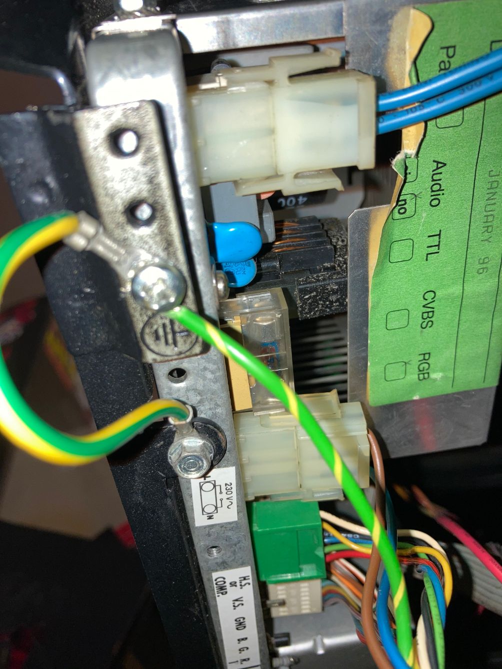

I may have a polo in my bas cabinet. It’s smaller 26” but should be ok. I’ll look at connector. There was an actual earth not connected but I reconnected it. I’ll do some pics.

Ok here's the RGB connector (please correct me if im wrong)
Here's the controller plug
The controller
And finally the earth that wasn't connected, i reconnected it.
I can't see any resistors apart from on the controller board. Am I looking in the right places?

gunblade said:
vertical sync is connected so unlikely to need the resistor mod
if it chassis related your guess is as good as mine as it will be a first
Ok next job is to break open the beast and borrow the monitor :)
Player
101CR
Just for my info, where? I assume on the monitor control board? Is it possible that the resisitor could be f&^£ed?

no idea, all i know is the chassis is running and the picture good and it would be a first if a chassis fault
but as you have same chassis on another cab its no big deal swapping them over just to prove it
