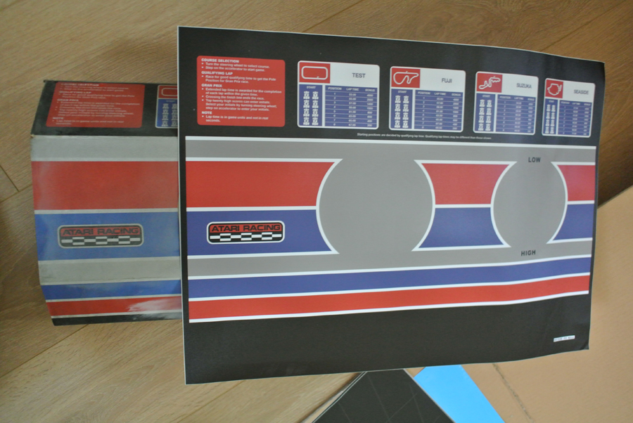

Revised CPO print has arrived, it's perfect this time.
I'll be getting on with cleaning the other side this week then starting to slowly rebuild it a piece at a time.
I've been pondering on whether to get filler around the bottom edge where it's a bit gnarled, but the white really isn't white and so after a test area that looked crap have decided I'll leave that alone.
